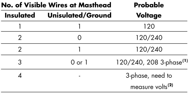

A modern residential overhead service entrance comprises three cables — two hot and one neutral — that run from the utility lines to a point of attachment at the weather head, and then down an entrance cable or conduit to the meter socket. In this type of system, the utility company’s equipment ends at the point of attachment on the house. Older systems may have different configurations (below).
1) Three-phase power is not common at residential properties.2) A 208-volt service may be present on the third red wire.Voltage and phase of an overhead service may be judged by the number and type of wires.

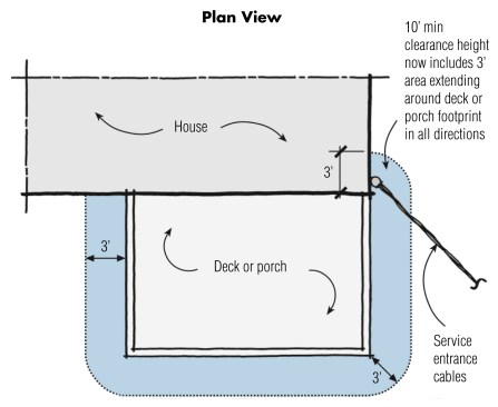

Overhead service entrance cables must be higher than
10 ft. above walking surfaces, including a deck or porch. As of the 1999 NEC, this 10-ft. clearance must be maintained at least 3 ft. out from a porch or deck in every direction, including around corners (below).
Overhead service entrance cables must be placed higher than 10 ft. above a deck or porch.
