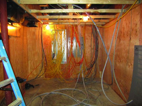

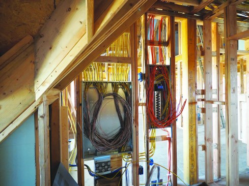

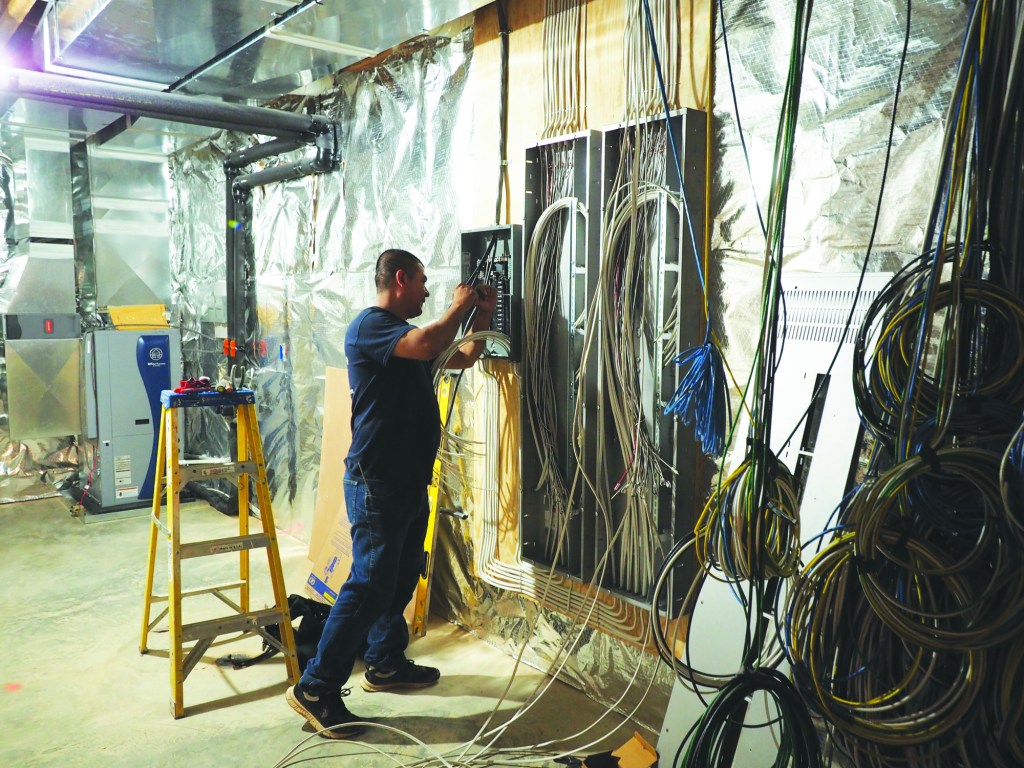

The wiring circuits for a huge house can pose a challenge ....
The wiring circuits for a huge house can pose a challenge ….
... both to installers and to maintenance or remodeling companies.
… both to installers and to maintenance or remodeling companies.
The author recommends terminating wiring runs in panels in a way that will make sense to the owners and future electricians.
Every wire should be labelled with its purpose and the location of the devices or receptacles it serves.

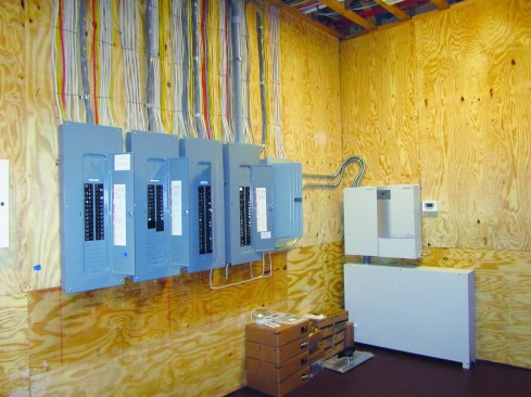

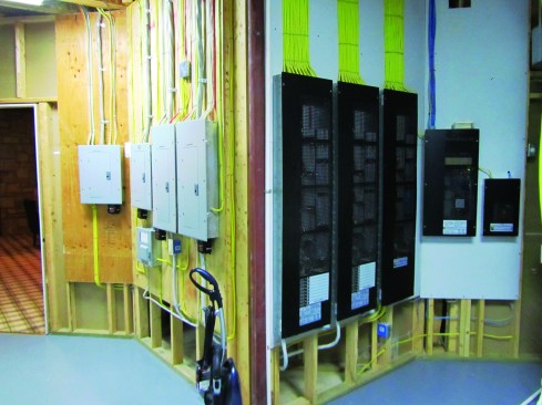

If you don’t start with a good plan, you’ll have a lot of trouble with electrical systems. Large houses have multiple breaker panels, and it’s a good idea to locate and organize them the way a homeowner will think about them. For example, a panel on the second level can have all the second- and third-level circuits, or the two panels on the north end of the basement can do everything on the north half of the house, and so forth. If half of the circuits on the second floor are on a nearby panel, but the rest are on two different panels in the basement, frustration and wasted time can result.
When power circuits and lighting-control circuits are extensive enough to fill several panels ...
When power circuits and lighting-control circuits are extensive enough to fill several panels …
... it can be helpful to organize some circuits into sub-panels located around the building.
… it can be helpful to organize some circuits into sub-panels located around the building.
Labeling panels early on helps a lot too. Later trades can note on their equipment where it’s fed from, if the panels are labeled early.

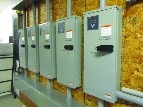

We usually distribute multiple generator sub-panels and lighting-control-system panels in a similar manner. The home-automation systems we normally use are wired so every lighting circuit goes straight to a large panel full of the system switches and dimmers. Because people change their minds and add things later, it’s helpful to have these scattered around a large home. It also saves a lot of wire to have them near the areas they control. In a house that’s 150 feet long and 40 feet tall, this can add up.

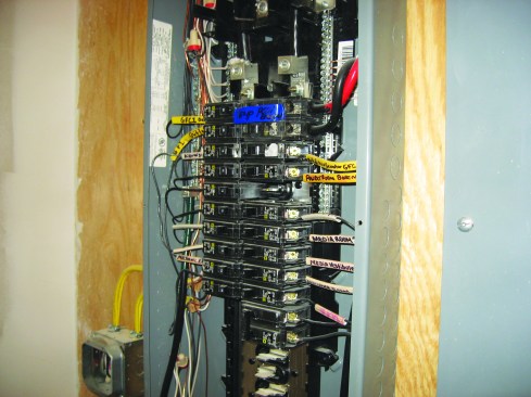

Labeling individual wires inside panel boxes is another helpful practice. Changes are inevitable and can be extensive, and large crews will be more productive if any electrician can understand each panel.

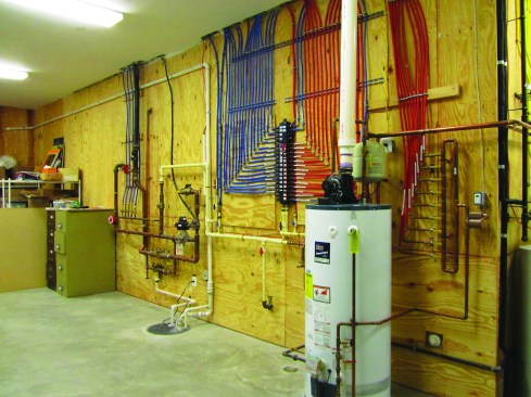

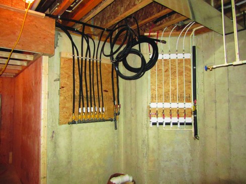

A manifold system is a good way to keep dozens of hot- and cold-water runs organized.
Plumbing
We don’t usually make extra efforts to valve off or label individual bathrooms (unless we’re using a manifold-type plumbing system). But there are a few extras that can improve a plumber’s day at some point down the road.
First, it’s a decent idea to break the house up into a few sections that can be closed off individually. That way, if something goes wrong, part of the house can keep running. A house with no bathrooms is much worse than a house with at least one working bathroom. We let the layout of the house decide where and how to do this. In our area, larger houses usually have more than one mechanical room in the basement, and we have the plumbers run a large line from one to the other and branch out from there; each half can be shut off independently.

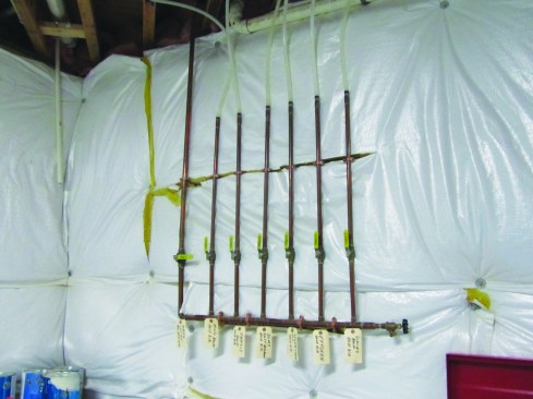

A house with six or 12 hose faucets can be a challenge to drain down for winter. We’ve remodeled large houses where plumbers scattered shut-offs and drains all around the house, and clients can’t remember where some of them are. A few winters later, they change maintenance people, and we get a call about a flood from a frozen pipe. To simplify the process, we group hose shut-offs into a manifold. One shut-off closes off the water to all the faucets, and we put a boiler tap on the manifold for a hose to the drain.
The author recommends organizing outdoor-hose-bibb piping lines and gas lines at a central location.
Liines should be able to be shut down all at once or individually.

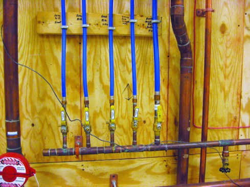

All lines should be clearly labeled to indicate what they serve and where they terminate.
It’s common these days to run a gas-line manifold as well, particularly with corrugated stainless steel tubing (CSST) installations. Labeling the valves accurately is obviously important. When we have more than one manifold, we include tags on each, noting the other locations.

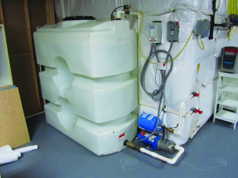

When a large house is served by a well with possibly limited water production, large buffer tanks can ensure that water does not run out during high-demand periods.

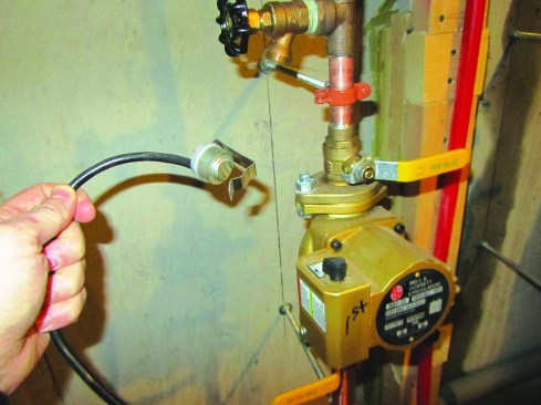

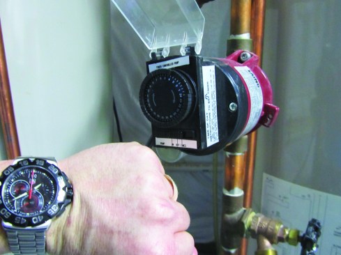

Be careful with recirculating hot water. We can’t seem to get away from hot-water recirc lines with the spread-out designs we are given, but our unfortunate experience with them is that they literally wear out the piping, sometimes within a decade. Hard or acidic water accelerates the process, but it can happen with any water. The key is to minimize the rate and time of pumping. We use minimally sized pumps (if your plumber is nervous about a small pump, have them use a multi-speed pump and set it to the lowest option), and always install an “aquastat” thermostatic device to turn the pump off when the line is hot.
Our attempts to use timers have had mixed results. Typically, we find the timers bypassed or set to “always on” within a couple of years. The pump shown thinks it’s 11:30 at night when it’s 1:40 in the afternoon. The clients have switched it from “timer” to “on” because of frustration with the timer.
Recirculating timers can go out of synchronization, in the author’s experience.
One way to reduce wear on recirculation lines is to use an aquastat that turns the pump off when the line is hot.

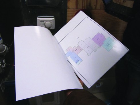

A relatively simple house may have two or three HVAC systems, and for that, a formal HVAC schematic may not be needed. But we’ve been involved with homes with eight or 12 systems, and some of those had zone controls with 20 or 30 thermostats. In such a large house, an easily understood floor plan showing which rooms are on which HVAC systems is essential.
A clear schematic indicating which parts of the house are served by which HVAC systems can help with troubleshooting and modifications.
This drawing should also show unit locations, thermostat locations, and outdoor compressors. If systems have automatic zone dampers directing air to separate parts of the ductwork, obviously these need to be documented. It’s even important to make an early decision on unit names. If the HVAC company calls a unit “attic system 2” but the electricians label it “north attic compressor,” it slows everything down.

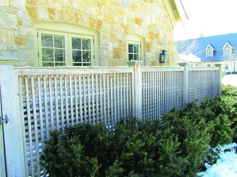

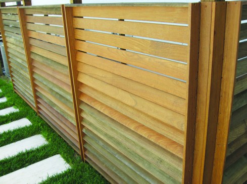

Screens are often used to hide outdoor HVAC equipment.
The should allow plenty of airflow and should leave ample space and easy access for maintenance and repair workers.

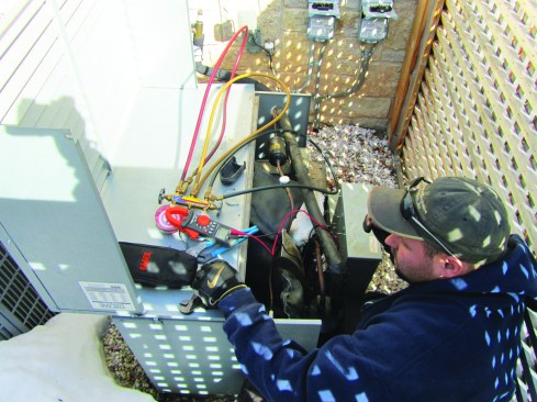

A checklist of all devices and filters is a necessity. The rear crawlspace dehumidifier has its own little filter, the attic ERV has two, and the third-floor south system has a humidifier cartridge that needs annual replacement. It’s easy to forget something.
Be sure to walk the HVAC installers through the house and verify the operation of every piece of equipment. We once found a humidifier had never been wired up because the electricians forgot all about it. It was one of more than 50 devices on that house—an easy mistake to make if you don’t check.

Finding ways to somewhat hide outdoor units while keeping them fully functional can take some creative thinking. Normal units need full flow of outdoor air from the sides and an open area above them. A solid fence or even a thick hedge can block airflow in; a deck or porch can block the hot air leaving. Either will cause the hot discharge air to recirculate down through the coil, which reduces capacity (which clients will notice) and also causes premature wear and high energy use (not necessarily a priority, but best to avoid). An open lattice fence seems to be acceptable to most clients and visually blocks the equipment while allowing normal function.
