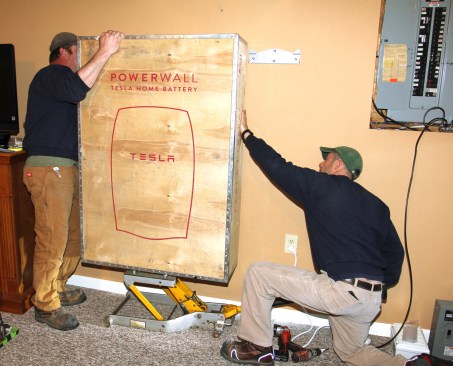

The Powerwall in its plywood shipping crate is jacked up and mounted, then unboxed.

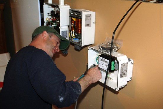

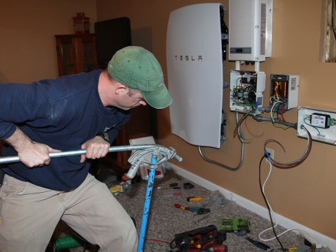

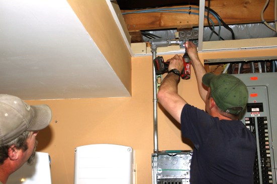

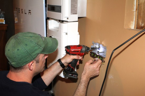

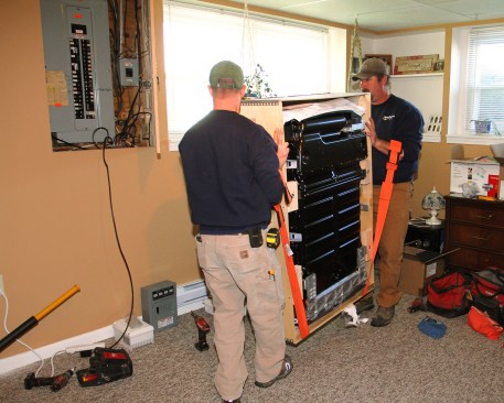

JLC recently went on site with electricians Scott Millette and Brian Ritz (Peck Electric, Burlington, Vt.), to see a Powerwall installed in a home. Millette has been installing and servicing electric-car recharging stations for GMP for several years. Putting in Powerwalls is a little different, he said, “but I have no trouble grasping it.”

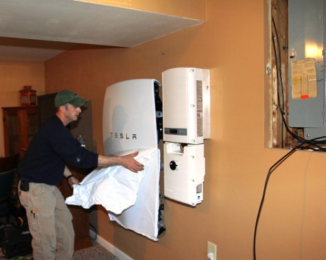

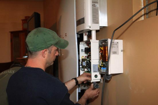

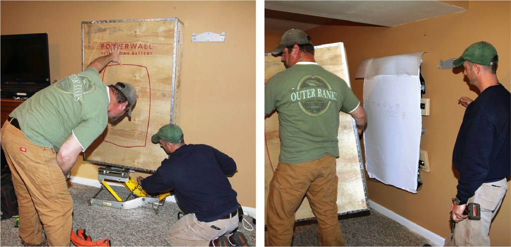

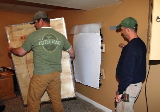

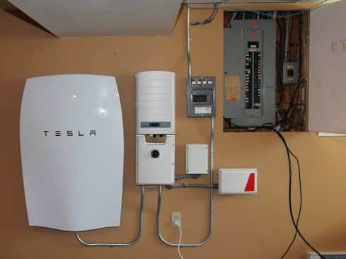

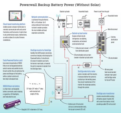

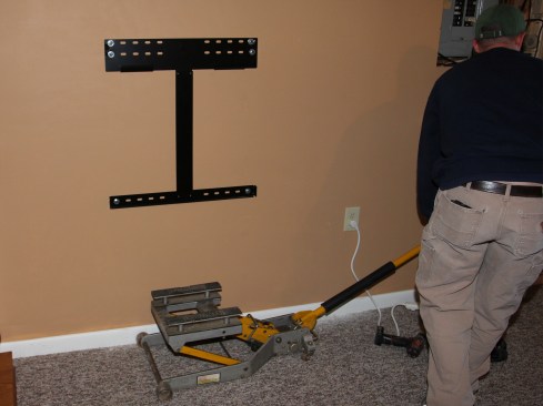

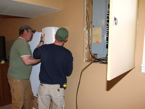

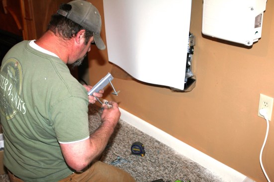

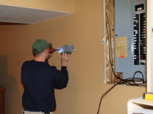

It’s not just the Powerwall. The Peck Electric crew needs to install a whole assortment of components to support the battery’s multiple functions (see illustration). The heart of the system, of course, is the battery itself—a 214-pound, 51.3-inch-by-34-inch-by-7.2-inch unit that arrives in its own plywood crate. The electricians bolt a steel mounting rack to the wall, jack the battery into place, attach it, then remove the crate and protective plastic wrap.

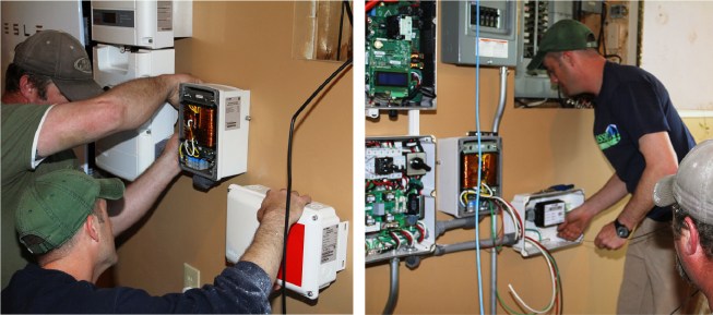

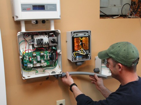

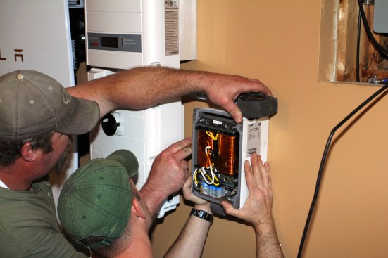

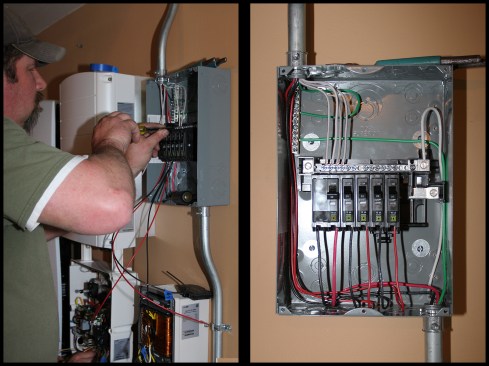

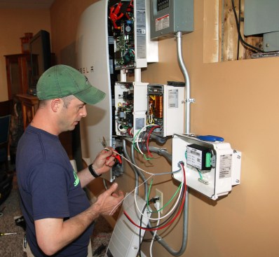

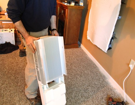

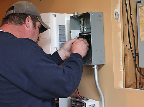

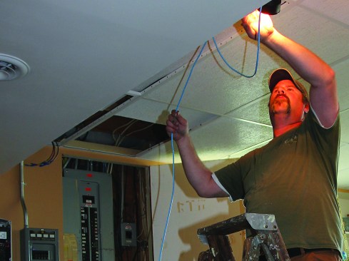

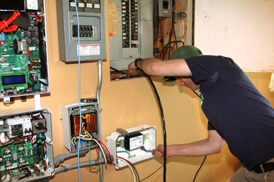

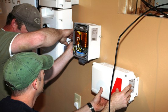

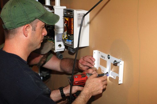

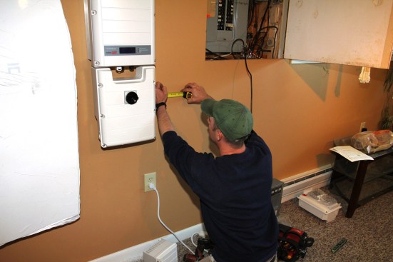

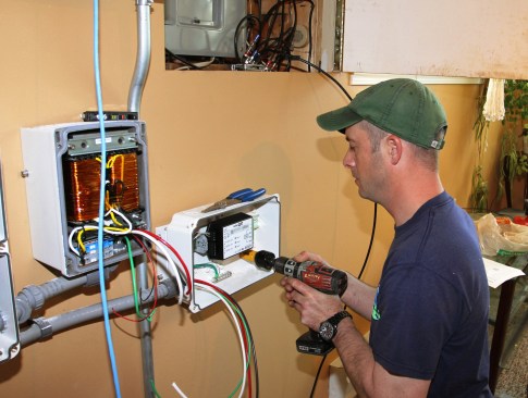

Next, the installers mount a “StorEdge” inverter supplied by SolarEdge, a major manufacturer of inverters for home solar systems. The inverter converts DC to AC power and vice versa, as needed to charge the battery or to draw power from it. The inverter has two modules: one that does the current conversion, and one that handles switching to feed power into the battery or draw power out of it, and to direct AC current to household backed-up loads, main loads, or into the grid. Wired to the inverter is a small transformer serving the backed-up circuits (this component is necessary to provide consistently regulated 120-volt current and grounding). In backup mode, the transformer feeds regulated power through the “load center”—a small breaker box similar to a subpanel, with circuit breakers for the individual backed-up circuits in the home.
Helping to manage all these devices is a “smart meter,” which monitors and reports on current flows throughout the system, enables GMP technicians to communicate with and control the battery and the inverter, and alerts the power company to any malfunction.

The example shown here is a simple backup power system for a house with no site-generated energy. If the house did have solar panels, they too would be wired into the inverter. In that case, the electricians would also equip each rooftop module with its own “power optimizer” designed to improve the efficiency of the inverter. The smart controls would allow the power company to direct solar-panel output as needed to household loads, into the battery for later use, or out to the street.

Grasping the ins and outs. By the middle of May, Scott Millette had installed seven Powerwalls—“probably more than anybody else in the country,” he told JLC. With a three-man crew, he said, the process takes about a day and a half. “It’s actually a very user-friendly install,” Millette said. “With every install, we learn new tricks, and the process becomes easier. But it’s not difficult.”

With the Powerwall battery and StorEdge inverter in place, the electricians add a transformer (which regulates voltage and improves efficiency and power quality) and a SolarEdge smart meter (which communicates between the equipment and the utility and homeowner).
