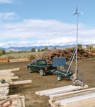

A few years ago, I got fed up with our noisy gas generator and decided to build a generator powered by renewable energy. My Colorado-based timber framing company often works on remote sites, so I wanted a portable unit that we could easily haul to the site and use to run our tools, and that could later be plugged into the finished structure to provide temporary power for lights and outlets. I don’t know much about electricity, though, so I enlisted my friend and colleague Mel Wright, of Greeley, Colo., to actually put the pieces together.

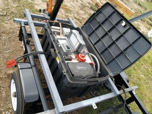

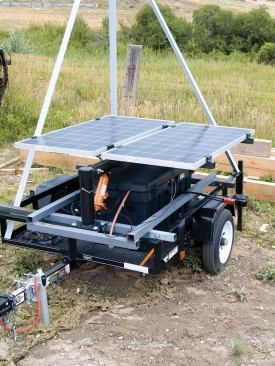

The heart of the system is an Outback 3,500-watt 24-volt DC/120-volt AC inverter (outbackpower.com), which is powered by four 220 amp-hour 6-volt absorption glass mat (AGM) batteries. The batteries are wired in series, which increases the voltage of the system to match the inverter. The batteries are charged with a pair of Kyocera 135-watt solar panels (kyocerasolar.com) and a 400-watt Air-X wind turbine (now called the Air 40, available from Primus Windpower) managed by a Morningstar PS-15 charge controller (morningstarcorp.com). Everything is mounted on a small trailer.

When we do run low on power, we break out the hand tools — slicks, chisels, layout tools, and the like — while the system recharges. I actually see that as a good excuse to get my hands on the wood again, dive in deep, and remind myself why timber framing is just such a wonderful way to make a living. But if we wanted to expand the system and add more capacity, Mel tells me that the first thing he would do is add more solar panels. The two that we have now produce about 5 1/2 amps per hour each (135 watts ÷ 24 volts = 5.6 amps). In theory, if we were to use about half the total amp hours stored in the batteries, it would take about 10 hours for the panels to recharge them (though remember that the wind generator also helps charge the batteries). Doubling the number of solar panels would cut our charging time roughly in half. We could also add more batteries, since the input capacity of our inverter is 300 amps at 24 volts.

Right now, Mel is reconfiguring the generator. When we built the unit, all of the batteries and hardware went into a single box, which made it too heavy to lift and move around easily. Mel is breaking the components down into smaller modules so that one or two guys can maneuver things around more easily. There are less expensive ways to get power, but none feels as good as plugging into the sun and wind.
