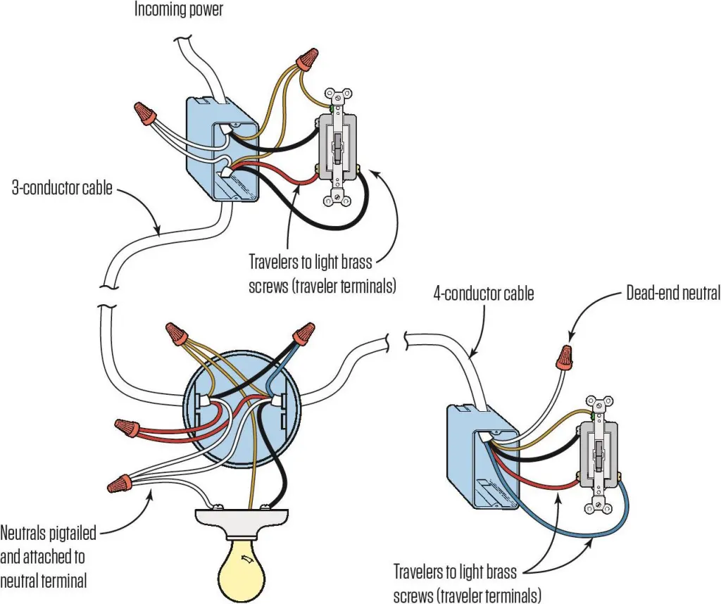

In the three-way switch scenario shown above, the fixture is placed between the switches. As before, a three-conductor cable joins the first switch and the fixture, but now a four-conductor cable runs from the fixture to the second switch. The capped off neutral is available in the second switch box should it be needed in the future for a device that demands more complex wiring.
Three-way switches control an electrical load from two locations. Depending on the location of the light (whether it falls between the switches or after both), the wiring sequence will differ.
