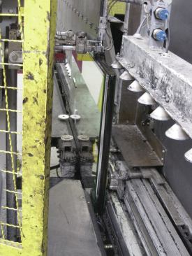

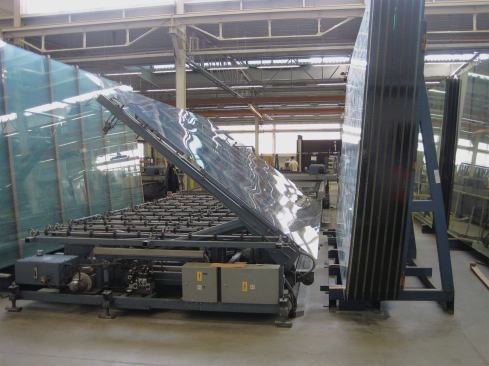

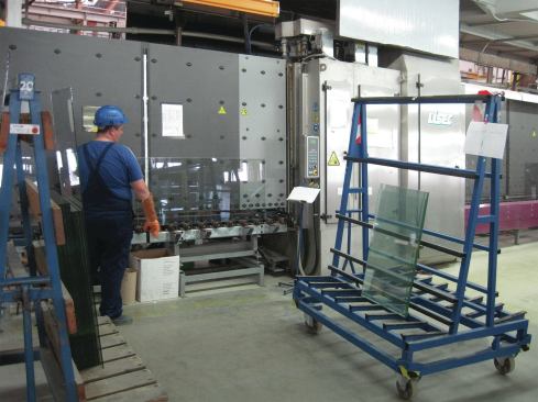

The heart of every window—regardless of where it’s made—is the glazing, or the insulated glass unit (IGU), that’s installed in the frame. IGUs for European windows are made in a separate facility by a company different from the one that assembles the final product. Glass comes into the IGU factory in huge sheets (3 meters by 8 meters) in whatever glass type is required, such as low-E coated or laminated. The sheets are laid flat and are cut to the proper IGU size on a CNC machine. While it’s cutting, the CNC machine also prepares the edges of the glass panels for installation by grinding any coatings off so they will accept a sealant.

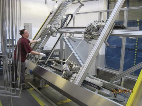

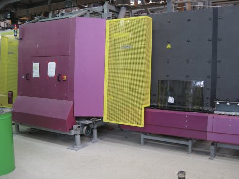

While the glass is being meticulously cleaned, a worker prepares the welded metal spacers that separate the layers of glass. Next, the glass moves to the gas-filling station. Argon gas—so critical to the performance of these windows—is not injected into the frames. Instead, the sheets of glass and the spacers are aligned in a loose assembly (close but not touching) and placed into a chamber from which the air is subsequently evacuated and replaced with argon. The glass and spacer sandwich is then compressed together, sealing the argon between the sheets. After the argon is evacuated from the chamber and replaced with air, the argon-filled IGU emerges. The edges are given a final seal, and the IGU is packaged with the rest of the order and shipped to the window manufacturer.

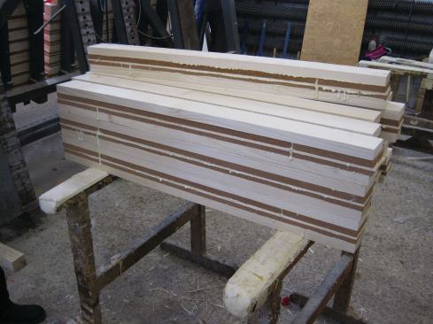

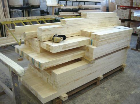

Although European windows are available in a variety of frame materials, wood-frame windows have traditionally been the most popular choice. Recently, however, wood-frame windows that are clad with aluminum have been gaining in popularity. Clad or not, the wood frames themselves are constructed along the same assembly line. They are made of laminated wood that comes to the factory in 18-foot lengths and is roughly 3 1/2 inches square. All the wood used by Makrowin is sourced from nearby forests (within about 125 miles of the factory) that are managed under strict regulations.
The laminated wood frame adds strength and durability to the windows, which is especially critical when they reach lengths up to 17 feet. Each interior laminated section of the frame is finger-jointed, which may make some American craftsmen cringe. But I was told that most builders in Europe prefer the finger-jointed wood and usually specify it as a component of the windows they order. Because of high-tech cutting methods and adhesives, finger-jointed wood is stronger and more stable than solid wood. For aesthetic reasons, the outer laminate of the frame—the piece that is visible as the interior finish of the window—is a solid rather than finger-jointed piece of wood.
Compared with solid wood, the laminated frames offer superior holding and pull-out strength for fasteners, ensuring durable connections for all the operating hardware. The extra strength also allows for fewer hinges, even with heavy, triple-glazed IGUs. And if a project calls for elevated U-values in the frame, manufacturers can substitute layers of cork for some of the wood laminations to provide a continuous thermal break around the perimeter of the frame.

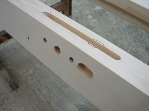

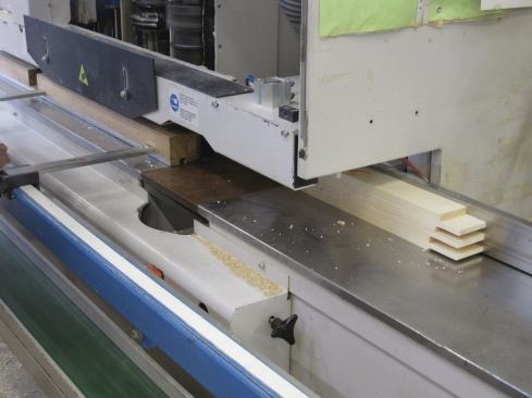

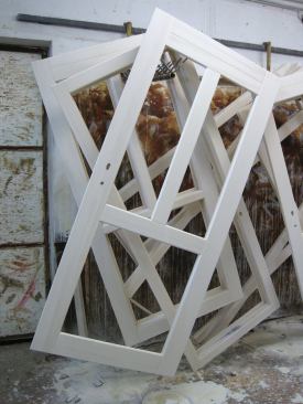

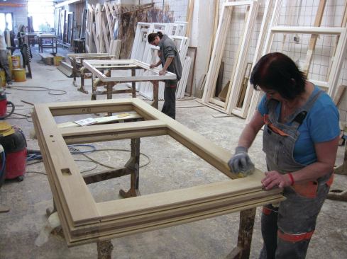

Rough-cut blanks enter a system of saws and shapers that precisely cut the frames to length and create glue joints at each end. Mortises and pilot holes for hardware are also cut at this point. Though companies fabricate these window frames using some of the most high-tech equipment available, it was interesting to learn that each frame receives more than an hour of hand-sanding. I was skeptical about this until I watched as an employee with a collection of specific sanding blocks orchestrated a personal stamp of perfection to each unit she handled. In a shop filled with high-tech shapers, drills, and saws, the final finish is left to human hands. Thinking back on all the times I’ve admired the quality of these windows, I now realize why they always look so good.

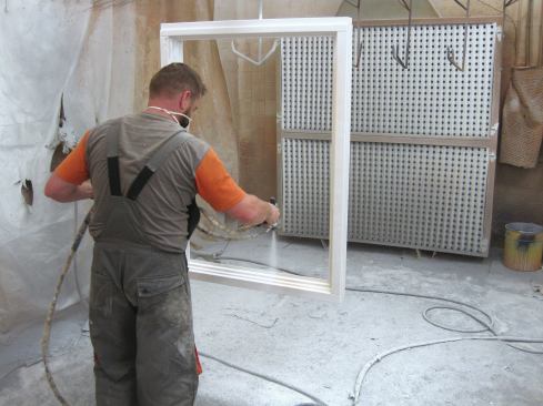

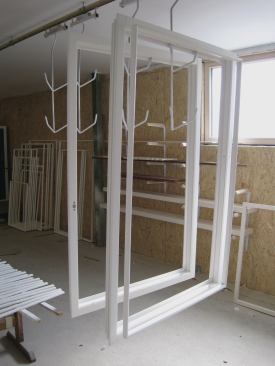

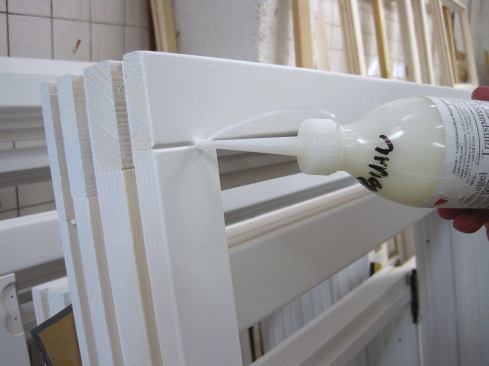

After an initial sanding, each wood frame goes through an elaborate finishing process that includes a bath in organic-growth repellent and coats of sealant, with light sanding between. Before final finishing, a special sealant is applied to each corner joint. That thin film bridges the two sides to protect the joint and the finish should any slight movement occur.
The frames are then sent into the finishing room where they are air cleaned and finished to the specifications of the order. For windows with an operable sash and complimentary glazing stop, the pieces are hung in tandem and finished in unison to ensure that the finish is an exact match when they are placed adjacent to one another in the final assembly. The humidity in the finishing room is closely maintained at 70%—the optimal level for curing set by the finish manufacturer—which lets the finish “relax” completely, resulting in an extremely smooth surface that’s free of the kind of texture that spray finishes often leave.

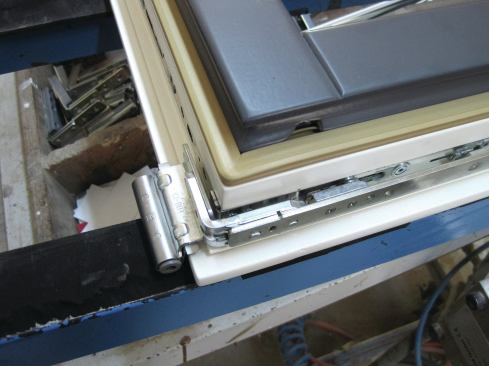

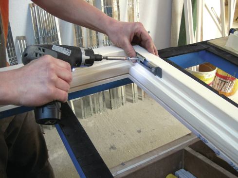

Hardware installation occurs after finishing to ensure that all surfaces on the frames are finished before the windows are assembled. The elaborate hardware for these windows is installed by hand, with the frames and sashes resting on a special padded table. The operation hardware, hinges, and locks are installed via pilot holes that had been drilled earlier to ensure their exact alignment. At this phase, the window units also receive weatherstripping. The sashes are then married to the IGU that was made especially for that unit. The IGUs are set in a glazing bead, and the glazing stops are applied.

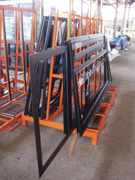

If a window is to be clad in aluminum, it’s at this stage that the pre-manufactured cladding is installed onto the wood frame. The cladding is produced at a separate facility and is welded and pre-finished when it arrives at the factory. We weren’t able to see the aluminum cladding being produced, though, and were told that the process is a tightly guarded secret. The welds on corners of these frames are completely invisible, so I can’t blame the maker for keeping the process under wraps.

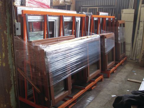

After the cladding is installed, the finished window and door units are grouped according to project and are wrapped and packaged together to await departure from the factory and delivery to the jobsite. The typical lead time for delivery to the U.S. is 11 to 12 weeks or three months, which is about 30% longer than what you can typically expect for a high-end custom order from a domestic manufacturer. That time frame includes the usual total fabrication time of about eight weeks, with another three to four weeks allowed for transfer and delivery. Orders for the U.S. usually have priority, so windows destined for Europe typically have the same three-month delivery schedule, even without the overseas shipping.

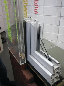

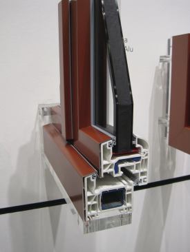

One popular choice is a PVC frame. Its performance is very similar to that of its wood counterparts, and depending on the size of the unit, it can be reinforced with steel—though one of the PVC reps at the show told me that his company is moving toward using recycled aluminum for reinforcement in the near future.

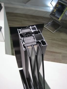

Another option is an aluminum-frame window thermally broken with a foam-filled plastic channel that separates the interior and exterior frames. The performance of these windows is supposedly equal to wood-frame windows. Because the frames are hand-welded, metal-frame windows tend to be more expensive.

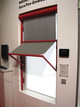

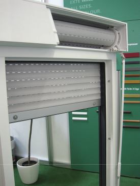

There are more options than I can list, but here are a few other notable ones. Integrated solar shades, important for energy-efficient homes, are available in a wide variety of configurations. Another useful option reverses the typical turn-then-tilt operation to tilt-before-turn. Most windows are also available with accessible hardware and child-safe hardware for either manual or motorized operation. Motorized hardware can be integrated with a home’s energy system to operate in accordance with changes in interior or exterior climate conditions. All windows and doors have options to meet Europe’s stringent security requirements. To meet demands for indoor air quality in the super-tight homes in which these windows will be installed, small heat recovery ventilators can even be built into the window units. Finally, at additional cost, the windows can be made with high levels of resistance to fire, impact, and sound transmission.
