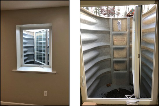

Habitable basement space larger than 200 square feet needs to have a second means of egress with a minimum open area of 5.7 square feet, a minimum net height of 24 inches, a minimum net width of 20 inches, and a sill that is no more than 44 inches off the floor (left). Window wells deeper than 44 inches require a ladder or steps (right).

Minimum opening area. The basement egress opening must have a net clear opening of not less than 5.7 square feet, a minimum net clear height of 24 inches, and a minimum net clear width of 20 inches. For basement conversion projects, we almost always install casement egress windows because they are the most efficient way to comply with this requirement. Double-hung egress windows can be used, but they require a much bigger opening, usually making them impractical for this application.

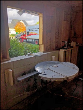

Window sill height. While the sill cannot be more than 44 inches off the finish floor, we like to err on side of being lower when we install basement egress windows, so we plan for a maximum sill height of 42 inches off the finish floor. Having the concrete-cutting sub cut holes in an existing foundation is expensive and invasive, and we want to get it right the first time.

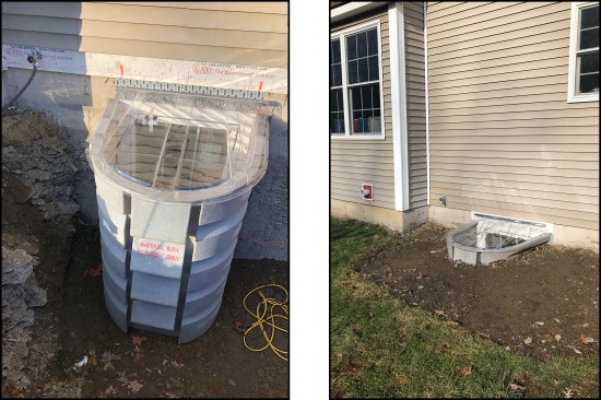

Drainage. Window wells need to have proper drainage, either with a connection to the building’s foundation drainage system or by a code-approved alternative method. A drainage system is not required where the foundation is on well-drained soil or sand-gravel-mixture soils. When we install a window well where the soils do not drain particularly well, we over-excavate the hole 2 feet on either side and in front of the prefab well, insert 4-inch drain that’s ready to go to daylight, and backfill with washed stone. If the well still shows signs of slow percolation, we bring the pipe to daylight. That is often challenging, but it has to be done to prevent water from backing up and draining into the egress window.
Where the soils do not drain particularly well, the hole is over-excavated 2 feet on either side and in front of the prefab well (left) and later backfilled with washed stone and topsoil and sloped away from the foundation (right). The Wellcraft prefab unit comes with a polycarbonate lid, which keeps out the elements and has to maintained by the homeowner (i.e. snow removal).
Where the soils do not drain particularly well, the hole is over-excavated 2 feet on either side and in front of the prefab well (left) and later backfilled with washed stone and topsoil and sloped away from the foundation (right). The Wellcraft prefab unit comes with a polycarbonate lid, which keeps out the elements and has to be maintained by the homeowner (e.g., snow removal).

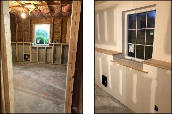

A typical occurrence at “grade floor openings” is that an existing window doesn’t meet minimum opening area requirements. Here, an existing double-hung window was removed and the opening enlarged.
Grade floor openings. A “grade floor opening” also qualifies. This means the sill height of the opening or window is not more than 44 inches above or below the adjacent grade. If this is confirmed, the opening can be reduced to 5 square feet. We run into this often on basement conversion projects where the grade allows for knee walls to be framed on half-height foundations. These walls typically have existing basement windows, but in almost every case, they do not meet minimum opening area specifications, so they need to be enlarged (see photos, below).
The author recommends erring on the side of caution when going to the expense of cutting concrete, with a maximum sill height of 42 inches off the finish floor (left, right).
