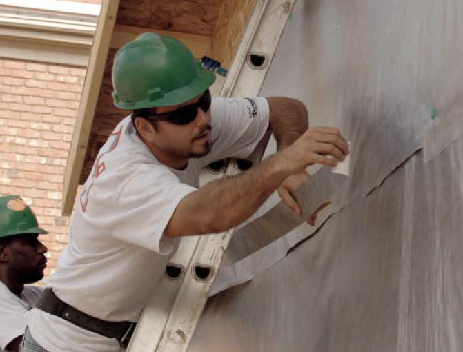

There is no magic bullet for reducing air leaks. A high-quality housewrap on the walls, properly lapped, taped at seams, and sealed around wall penetrations, can reduce air leakage in a typical home by 15% to 35%, on average. This can go a long way toward improving a home's energy efficiency and reducing the chance of moisture problems.
But the housewrap is just one component. To be effective, it should be used in conjunction with other air-sealing techniques to advance the total performance of the home. We want a "belt and suspenders" approach to stopping air infiltration that addresses air leaks in walls, attics, crawlspaces, ductwork, window and door openings, and all penetrations through the enclosure. Viewed this way, an effective air barrier on a home means not only housewrap but also tape, spray foam, sill seal, and even sheathing and blocking that is strategically placed to limit airflow through building assemblies.

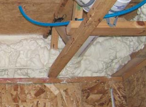

Rim joist. The rim joist is a common area for air leakage. It's nearly impossible to get a continuous seal from the inside, which is one of the best reasons for using a well-detailed housewrap on the exterior. In addition to being vulnerable to air leaks, the framing is a strong thermal bridge. Best practice calls for filling this cavity with a closed-cell spray foam. Be sure to check local fire code requirements for any exposed insulation.
Fiberglass is not an air stop and cannot be relied upon to seal the rim
joist.
Fiberglass is not an air stop and cannot be relied upon to seal the rim joist.
In most cases, best practice calls for sealing this area with closed-cell spray foam.

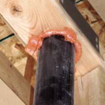

Wall penetrations. Where pipes run through exterior walls, seal them to the WRB with contractor's tape to keep water out, and foam around the pipe from the inside to further stop air leaks. The same goes for AC line sets, light fixtures, and vent terminations that pass through a wall.

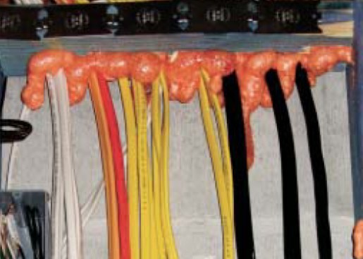

Attic bypasses. Plumbing vents, ducts, wires, and can lights routed through the attic end up riddling the top wall plates of partition walls with holes that allow air to leak into the attic. The best solution is to use a foam sealant to seal wiring and pipes through the top and bottom wall plates. If you must use recessed lighting, be sure to use airtight cans.
Every pipe and wire  that passes through the top  plate is an air leak that  siphons conditioned air away  from the living space. And  because of the tendency of  warm air to rise (called the  “stack effect”), the air  leaking out of all these wiring  holes is driven by positive  pressure, causing conditioned  air to escape from the home  even faster.
The solution is to seal each penetration with a spray-foam sealant.

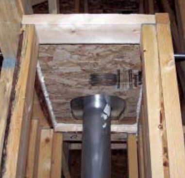

Combustion appliance flues. Water heater and fireplace vents are typically installed in chases that open directly into the attic when the fire blocking is left out. The result is a wide-open conduit for air leakage though the ceiling. The solution is to block the top of the chase with a sheathing material, then cut a hole for the vent, maintaining the code-required distance from the heat vent and combustible. This gap can then be sealed with a metal collar.
The top of a vent chase can dump a lot of conditioned air into an attic. Prior to installing the vent, cap the chase with OSB. Seal the edges of the OSB with a foam sealant, then seal the vent to the OSB  with a metal collar. As you can tell, cutting the opening for the vent isn't something that requires a lot of precision. If it's a heating vent, the most important thing is to keep the OSB at least 2 inches from the metal vent.

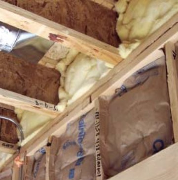

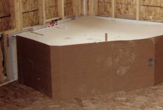

Tubs and shower units are often installed right over open framing without any insulation or air barrier. Combined with the oversized cutout in the floor sheathing for the tub drain, you often end up with a huge raceway for air that is uninterrupted from the rim joist, through the floor system, and into the walls. The solution is to insulate the wall cavity and sheathe it before the tub gets installed.
Before installing a tub unit, the wall cavity must be insulated and sheathed  to stop the free transfer of air and energy. Thermo-ply or a similar type of sheathing  is a good choice for this application because it doesn’t pack the wall out too far.

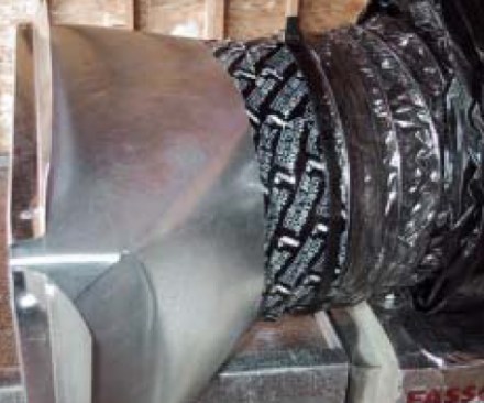

Flex duct that is joined to the register boots should be secured with both duct tape and drawbands. But if you want a duct tape that actually stays on ducts over time, look for the UL 181 designation. UL 181 duct tapes usually have an acrylic- or butyl-based adhesive, which is less likely than rubber adhesive to dry out over time.
A poor (but unfortunately, common) duct connection to a boot

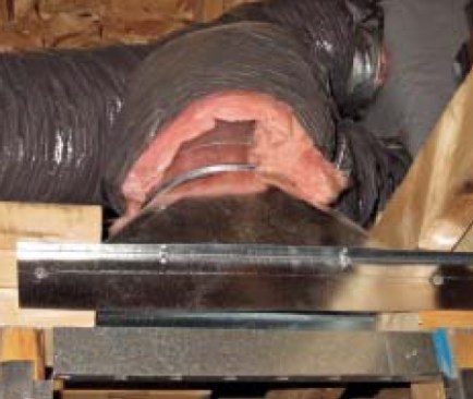

It should be executed as shown in this photo: Peel  back the cover and fix the liner to the boot with acrylic  tape and a draw band, as shown. To complete the  connection, pull the cover back down. Tape and secure this with a drawband as well.

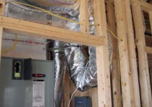

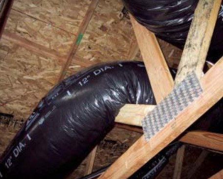

Fortunately, the HVAC installer  didn’t cut out the truss members to  make room for the ductwork. However,  this sharp bend could have been easily  avoided by rerouting the duct from  the start. Codes require that duct be  installed fully extended, not compressed.

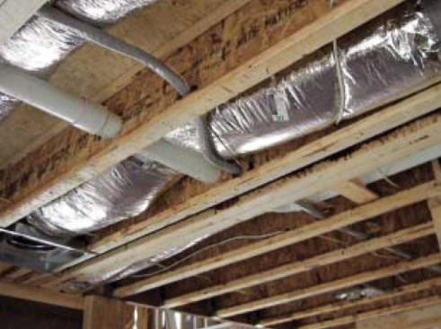

Coordinate the mechanical trades: This conflict between the HVAC  duct and a plumbing drain could have been avoided by both trades meeting  and reviewing the plans prior to the crews’ arrival on site.
