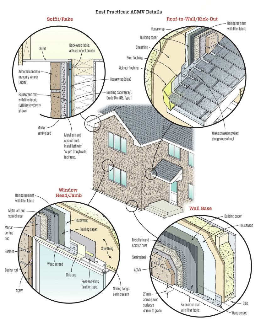

This cladding absorbs and hold water, so it's not surprising that installation errors lead to moisture damage.
Tim Healey
Adhered concrete masonry veneer (ACMV)—which sometimes goes by the names “manufactured stone, “lick and stick,” “cultured stone,”, and” faux stone”—is like stucco with chunks of concrete stuck in it. To avoid moisture problems, it must be detailed like stucco. Here are some of the critical details needed to avoid problems.
Click here for large version
For more about adhered concrete masonry, visit the JLC Field Guide.
