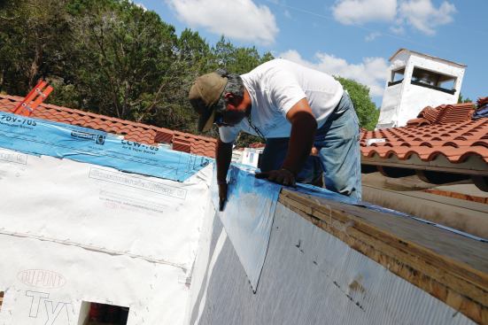

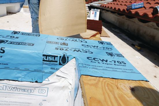

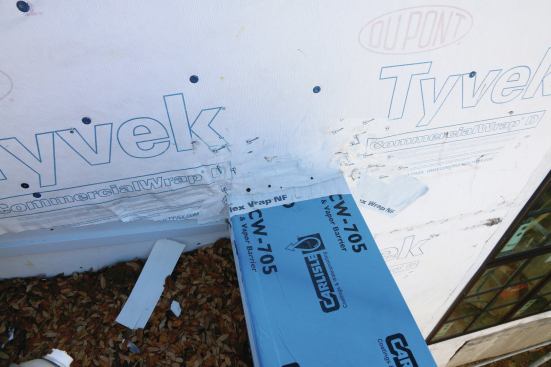

If your installers have covered the parapet with the housewrap, be sure to cut it back before applying any flashing. Next, apply a flexible flashing wherever the parapet cap takes a turn. The straight flashing that covers the parapet cap will need to be cut there, so we want the flexible flashing underneath to ensure a watertight seal.
I typically use Tyvek FlexWrap, which is readily available from local suppliers. Carlisle also makes a version called Elastoform; it's a great product, but it's a special-order item, so I usually go with FlexWrap.
In either case, it's critical to use a single material that can easily conform to different surfaces. The sheet membrane we apply over parapet caps doesn't stretch and must be carefully folded around corners (3, 4). Installing the elastic membrane underneath makes what would otherwise be a tough spot easy to detail.

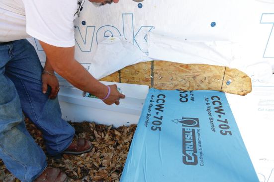

To ensure a lasting bond between layers of waterproofing, I recommend using 3M High Strength 90 spray adhesive. We use it before adhering the FlexWrap, and to hold down any flaps in the housewrap and the cap flashing. This adhesive particularly helps on custom projects, where the cycle time between trades can get drawn out. You never know how long it will be before the housewrap and flashing materials get covered up, and the adhesive helps hold everything together in the meantime.

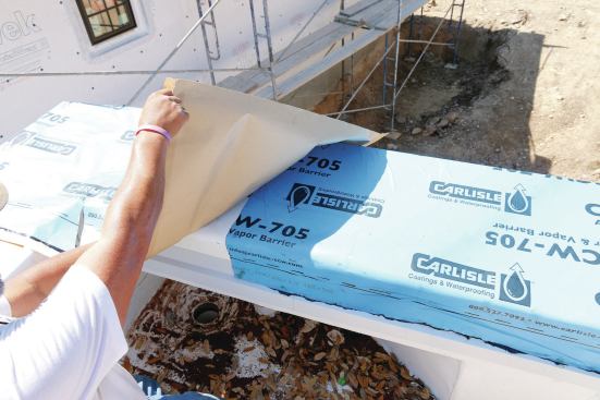

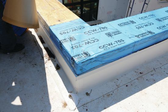

For flashing over the top of the parapet, I like Carlisle CCW 705 peel-and-stick membrane. This 40-mil–thick product is very similar to ice/water shield products used on roof edges and valleys to prevent leaks caused by ice damming in cold climates. It consists of a rubberized asphalt adhesive laminated to an HDPE cross-laminated film and has good self-healing properties around nail penetrations. There needs to be a thick, durable product under the stucco cap because sooner or later, water will get through the stucco.
A few other manufacturers make this type of 40-mil product, but you might need to hunt around to find one, as it's not typically stocked at lumberyards. I buy mine from a commercial waterproofing supply house in Austin called All-Tex Supply. You might find a similar product at a roofing supply house. Or you could use WIP 300HT, which is also 40 mil thick. Whatever product you pick, you want to ensure that it wraps over the entire cap in one piece and hangs down at least 4 to 6 inches over the housewrap to provide a good shingle effect.
One reason I like CCW 705 is that I can buy it in various roll sizes; my supply house typically stocks it in 12-, 18-, 24-, 36-, and 48-inch rolls. Sam, my carpenter, runs roughly 6-foot lengths to ensure smooth and mostly wrinkle-free installations. We always overlap the sheets by 6 to 8 inches. Whenever we are concerned about adhesion, we spray overlaps with High Strength 90 adhesive.
