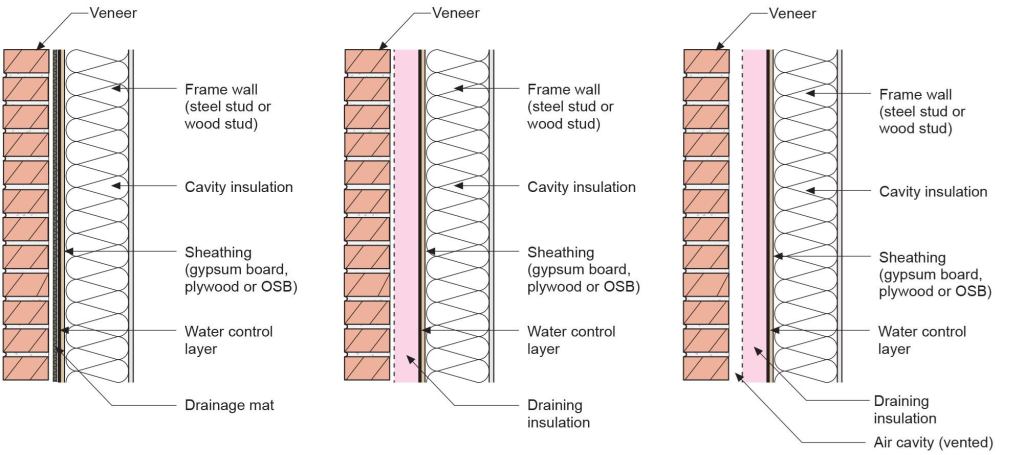

When using an advanced water-control layer, such as a self-adhesive or liquid-applied membrane, and a drainage mat or a draining insulation, such as mineral wool, no air cavity is needed. However, in IECC Climate Zone 5 and higher, and in areas with annual rainfall over 20 inches, a minimum 3/8-inch air cavity with vent openings top and bottom (far right) should be maintained.

Some building scientists, however, are increasingly taking another approach. Instead of focusing on the masonry, they focus on waterproofing the structural wall that sits behind the brick. If you create an effective water-control layer on the structural wall—which is possible with today’s self-adhesive and liquid-applied WRBs—you may not need through-wall flashing. And if you use a drainable filter fabric or drainable insulation material—materials that will allow the wall system to drain, even if some mortar falls down behind the brick—on the face of the backing wall, you may not need the air space either.

But these days, Lstiburek says, masonry backing walls are routinely waterproofed, as are light-gauge steel or wood-framed walls behind brick veneer. Builders now also use drainage mats, too, which drain walls, relieve hydrostatic pressure, and create a capillary break, despite any mortar droppings. Even better, Lstiburek notes, we now have materials such as mineral wool that can insulate between the brick and the house wall while still allowing drainage. If you’re building a system with a waterproofed main wall and a drainage mat or drainable insulation layer, argues Lstiburek, you don’t need any additional air gap at all—at least not for drainage or drying.
Code challenge. In an email, Lstiburek told JLC, “A code change proposal is coming.” Lstiburek and his organization, Building Science Corporation, have been successful at spurring code revisions in the past—most notably in the case of interior-wall vapor barriers, where Lstiburek was instrumental in the effort to repeal requirements for poly under drywall in most climates. Lstiburek said his suggestion to omit the air space behind the brick—provided the wall has waterproofing and a drainage mat or drainable insulation, and the plans have been stamped by an architect or engineer—has been accepted many times on a case-by-case basis by code authorities.
But Lstiburek offers a couple of cautions. In climates with freeze/thaw conditions, he says, the air space helps dry the back of the brick veneer. This space should be kept as protection against frost damage. Lstiburek says experience teaches that a gap of 3/8 inch should be plenty for those purposes. Lstiburek also notes that the gap allows masons to meet visual construction tolerances. If the backing wall isn’t perfectly regular and flat, the gap allows masons to maintain a flat face on the side people can see. The larger the building and the masonry wall area, the more room masons are likely to need. So even if building science doesn’t justify requiring the gap, the gap will remain an option that many builders will continue to choose for practical reasons. —Ted Cushman
