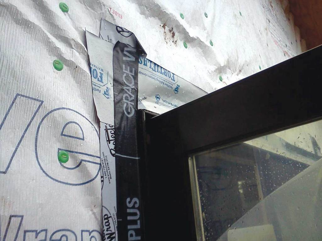

Reverse shingling, where the upper layers go under the lower layers, is the most common installation mistake. All flashing details should provide 100% mechanical drainage paths so that they shed water even if the adhesive fails.
Mark LaLiberte
The most common mistakes – the places where installers need to always pay attention – are reverse flashing, improper cuts, poor surface prep, and not properly seating the flashing on the substrate.
Improper cuts. Water always follows an edge. Often a piece of flashing is cut then lapped over the piece below. The cut should direct water away from the vulnerable area, preferably out onto the WRB. The most problematic cuts are at windowsills – a good argument for using one-piece flexible product in that area.

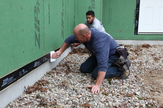

A plastic spreader is a great way to create the initial bond of the tape to the sheathing. If enough pressure is carefully and meticulously applied, the spreader can create the permanent bond. Whenever possible it is always best to go over the tape with a roller.
Seating adhesive flashings. Peel-and-stick flashing tape needs to be mechanically smoothed with a roller or other device that applies mechancial pressure to promote adhesion. Smoothing the flashing with hand pressure is not enough.
