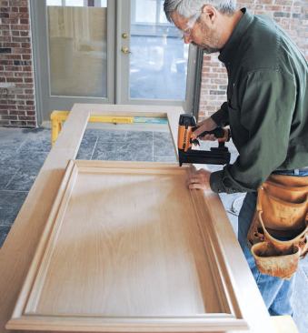

More economical than custom doors and more stable than pine raised-panel doors, stock solid-core doors can be used to create stunning frame-and-panel, glazed, and segmented-arch doors with a little ingenuity and applied moldings.

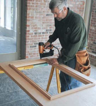

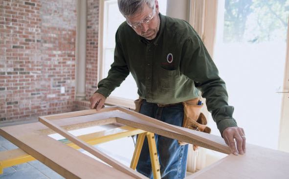

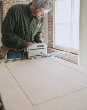

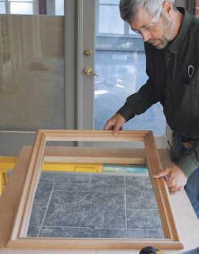

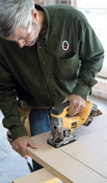

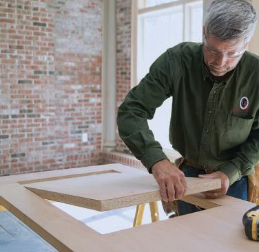

I use the same panel moldings to frame glass panes, stained-glass panels, and mirrors. I start by carefully laying out and cutting the opening in the door (see slideshow). Next, to create a split jamb that will hold the glass, I rip stops that are equal in width to half the thickness of the door minus the thickness of the glass panel. I size the jambs so that they’ll fit snugly in the opening, with about 1/16-inch of clearance.
When I fasten the frames to the door, I take care to align the jambs on either side of the door, but only glue and pin one side. Next — since tempered or safety glass is generally required in doors — I remove the temporarily tacked frame and call in the glass company to measure the opening. I schedule the door for finishing while the glass is being fabricated. I want to make sure the door is stained or painted before the glass company comes back to install the glass.

Set-up time adds to the cost of production. Once I’ve set up for four or five doors — the best number for the most efficient production — it takes me about a half-hour to panelize a single door.
