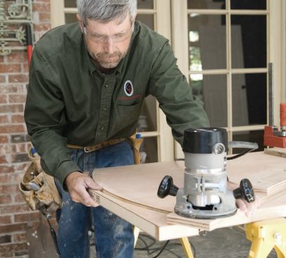

Segmental arches are easier than elliptical arches to lay out on a door slab, and more practical than round arches when there’s limited headroom. (For more on curved trim, see “Building an Arched Passageway,” 12/07). I usually cut out the arch with a straight-bit-equipped router mounted on a trammel arm (see slideshow). But sometimes, with multiple doors, I make a plywood pattern first and use it — along with a router equipped with a long pattern-bit — to make the cuts. If I’m working with an existing doorway, I scribe the slab to the opening for the best fit, since I never assume that I’m working with a true radius or a square opening.

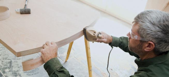

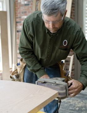

After cutting the arch, I sand the door smooth and carefully remove all the dust. Then I seal the top with 1-1/2- or 2-inch-wide iron-on veneer edge banding. This tape isn’t widely available at most home centers or lumberyards — especially in species other than oak — so you’ll have to do a little advance planning when you’re cutting arched doors.
