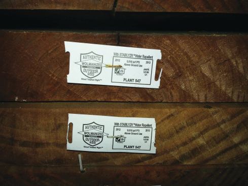

The ICC codes reference American Wood Protection Association (AWPA) standards for treated wood so one of the first things an inspector will look for on the end tag is "AWPA" and the applicable standard, usually "U1." The tag should also identify the preservative type and amount of preservative retained in the wood (retention), as well as the AWPA Use Category (in this case, the use category is UC3B - "Exterior Above Ground, Uncoated or Poor Water Runoff").

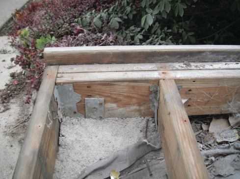

This is the origin of the requirement that lumber used for framing that’s closer than 18 inches to the ground must be naturally durable or preservative-treated. This provision (2012 IRC, R317.1) applies to under-floor areas that are within the periphery of the building foundation, and not necessarily to decks.

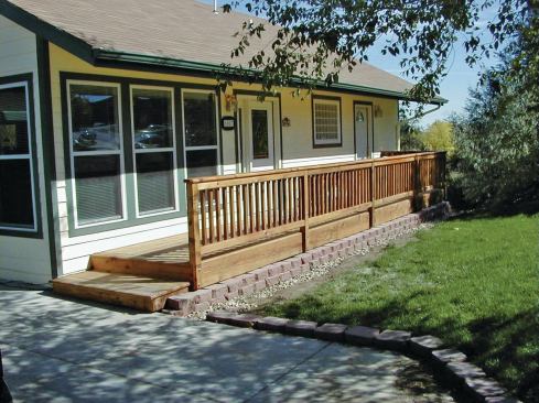

Unlike crawlspaces, decks typically have plenty of airflow—at the edges and through gaps between deck boards. However, the amount of ventilation can vary considerably. Is there vegetation adjacent to the deck? Is there a solid skirting around the deck, from decking to grade? What if that skirt is an open lattice? Some manufacturers of porch-style tongue-and-groove decking require ventilation below the deck to compensate for the lack of airflow through the solid decking surface.

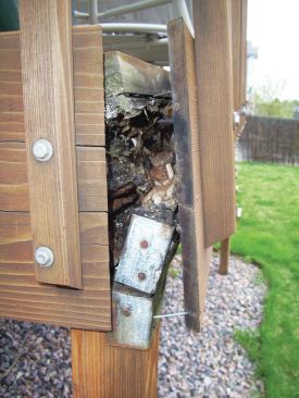

Proximity to the ground isn’t the only concern; precipitation is another. Conventional wood-frame construction creates many interfaces where lumber contacts lumber, with small gaps and cracks in the joints that don’t dry easily. Spaces between the joists and the decking, between multiple beam plies, and at notches and tops of posts are all subject to significant wetting and inhibited drying.

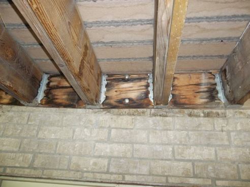

By the way, the same provision (2009 IRC, R502.2.2) that introduced deck builders to the controversial IRC lateral-load connection detail was the first one to require preservative-treated deck ledgers. (In the 2012 IRC, R502.2.2 was moved to R507.2, at the end of chapter 5.) Looking ahead, a number of new deck-specific details will be included in the 2015 IRC (see “2015 Deck Code Update,”Jul/Aug 2013).

The IRC references the American Wood Preservers Association standard U1 for acceptable treated-lumber methods, retention levels, and exposure conditions (awpa.com/standards/U1excerpt.pdf). The most common products used for decks from this list are ACQ and PTI. Micronized copper quat (MCQ) is also relatively common but must be approved as an alternative.

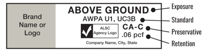

While the standard provides the nitty-gritty details, in practice it’s the material’s identification tag that’s important to inspectors (see image below). The IRC requires a tag with seven items of information on each stick of treated lumber (though there are exceptions for small sizes). The end use the product was treated for is generally the target of inspection.

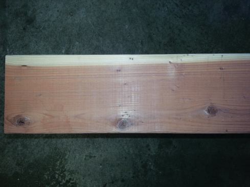

Sapwood is more susceptible to rot than heartwood is, but it absorbs preservatives much more readily. Thus M4 generally doesn’t specify field treatment for species with thick sapwood (such as pine) for profiles measuring 6 inches or less in above-grade applications. If a notch in a post reveals inner tree rings, though, it’s a good idea to field-treat it.

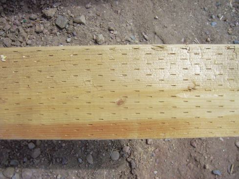

Douglas fir, on the other hand, has thin sapwood and does not take treatment well, which is why it’s commonly incised prior to treatment. Inside a cut end, it’s easy to see the minimal penetration of treatment and the need for additional preservative. As a consequence, M4 specifies field treatment for all cuts in treated Douglas fir and hem-fir, whether or not the wood is in ground-contact.
