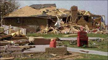

CONCERNS AFTER ANDREW
The damage from Hurricane Andrew was formidable and has only recently been surpassed by the quadruple whammy of 2004’s record-breaking storms. In response to public outcry, the Florida government moved into action, creating an advisory committee to investigate the nature of the structural damage and make recommendations that would limit future reoccurrences. Jose Mitrani, a civil engineer and professor at Florida International University in Miami, was involved from the beginning on the task force charged with investigating the failures. He does not think that OSB performs adequately as structural roof sheathing. “During that experiment we call Andrew, OSB did not behave as an equal to plywood,” claims Mitrani. “I saw shattered OSB all over the place and I did not see a lot of plywood.”

Ed Keith, senior engineer with APA, was there from the beginning too, as part of Florida’s official damage assessment team. He claims, “The problems with roof sheathing were related to the fact that builders were not building correctly, and the inspectors were not inspecting adequately.” Keith insists that APA’s quality assurance testing of OSB and plywood is reliable, ensuring that builders get a durable roof sheathing. Panel manufacturers must submit to random testing to earn an APA stamp. APA-stamped OSB and plywood are tested for bending strength, stiffness, shear strength, and concentrated load performance. APA measures fastener holding capability and tests glue bonds with accelerated weathering wet/dry cycle tests to assure durability. The APA tests outlined in PS2/PRP 108 are product performance standards, and they predict that OSB and plywood perform as equals for their intended end use. This begs the question: Why did Mitrani and others see so much failed OSB during inspections? Proponents of OSB say it’s simple: Most homes were built with OSB (rather than plywood), so there was more of it around. And the OSB that failed did so because of poor workmanship and faulty installation.
“When I did inspections after Andrew, I saw panels with literally only four nails in the corners and roof framing members with no holes in them, indicating that the sheathing had never been nailed off or that sheathing nails had completely missed the roof framing targets,” says Keith. He claims the overall consensus among experts who have looked at roof-sheathing reports is that failures resulting from Hurricane Andrew were related to “workmanship and improper fastening,” not the selection of OSB.
