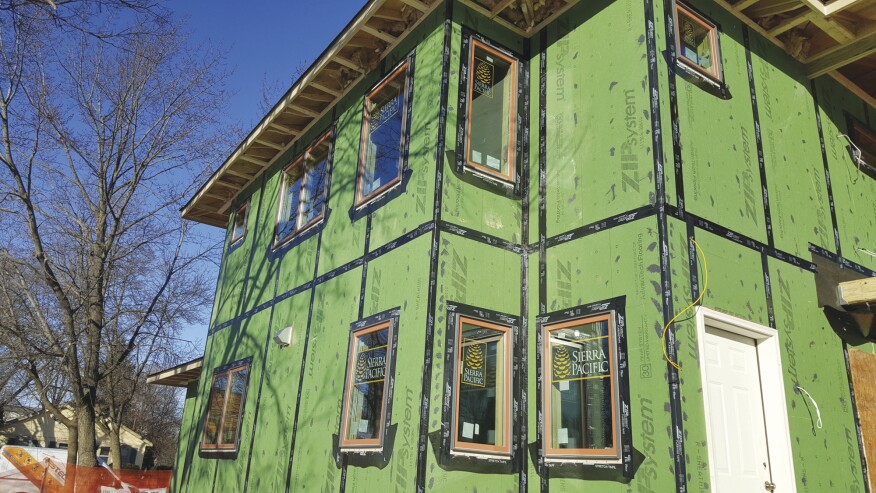

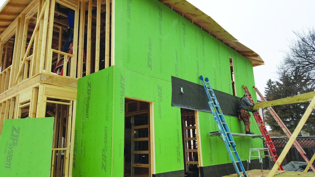

The advent of Zip System R-sheathing—structural OSB with an integral weather barrier married to polyiso foam—provided a path towards a simpler high-performance wall. The R-12 panel provides enough continuous exterior insulation to eliminate the interior vapor retarder, which would otherwise be required in climate zone 6. It doesn’t restrict our ability to design cool shapes and doesn’t require retraining crews to build in a substantially different fashion. Carpenters still sheet their framing with a nail gun (granted, it needs to be a large one that can shoot 5-inch nails), which means the wall goes together nearly as fast as uninsulated Zip System sheathing. When we extend our sill plates out 1/2 inch, the surface of the drainage plane aligns perfectly with 3 inches of exterior foundation insulation. (Yes, below-grade walls also want the insulation on the exterior.) It gets better: Windows are installed just like they would be in a normal wall. No bucks, no “innie vs. outie” debate, no complex multi-step tape and liquid flashing details. It accomplishes much of what the Perfect Wall sets out to do with regard to aligning control layers, which is what we’re really chasing when it comes to both thermal performance and general resilience.

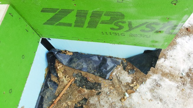

Bumping the sill plate out allows thick foundation insulation to align with the wall’s face, simplifying drainage, air-sealing, and exterior finishes.

Zip R-12 sheathing certainly qualifies as simple from an installation standpoint, but it’s not perfect: The geometry of the material is complex, which means you cannot rely solely on taping the outside face to ensure a continuous air barrier. The corners require cutting back the foam so none is exposed, then aligning it with another panel, which is definitely not a perfect connection. When fastening the panels to framing, you get a little compression of the insulation, particularly at edges, and field-cut panels don’t match up perfectly. We can address everything on the surface, using tape and liquid flashing, but it’s a 2D solution that doesn’t address all edge-to-edge connections, particularly those at the top and the bottom of the wall.

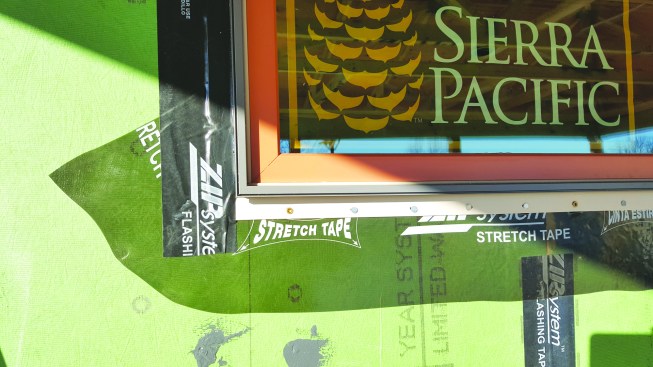

These clad vinyl-frame windows have an integral flange.
This allows for standard installation: no need for window bucks or elaborate flashing.

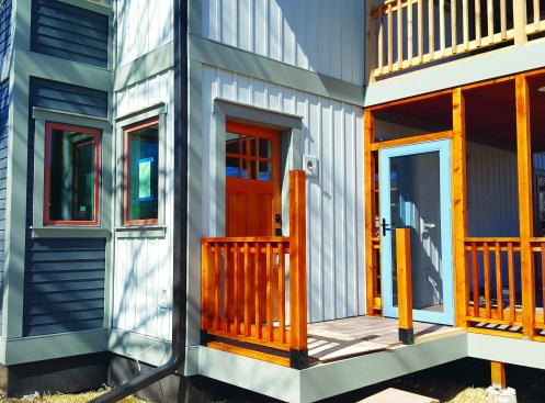

Continuous rainscreen. For a ventilated rainscreen, we used Benjamin Obdyke’s Slicker. By installing it over the entire wall, wrapping around corners, and lapping over the foundation insulation, we get omni-directional drying and drainage with an infinitely lower chance of failure than with a rainscreen created with strapping. It installs quickly and provides a consistent nailing base. Strapping is time consuming, requires skill, and confines the drying and drainage to vertical sections.
On this project, Celect cellular PVC cladding is installed over Slicker, which provides omni-directional drainage and drying over the entire wall.
Cladding is an aesthetic choice. On the project shown in the photos in this article, we used Celect cellular PVC siding, but the wall system works for most siding types. Code dictates the length and spacing of fasteners for siding that weighs less than three psf (this includes most fiber-cement lap siding) nailed into 7/16-inch structural sheathing “where no stud penetration is required” (2015 IRC, Table R703.3.2). Siding can hang off the Zip-R; no need for strapping nailed to studs. To accommodate lateral movement of the PVC cladding, we padded-out the trim to allow the siding to move freely beneath it. The result is a crisp look that promotes ventilation. Caulking, which causes more problems than it solves, is not part of the system.
The trim is packed out so the cladding can move freely under the trim, and the cladding doesn’t butt up tight to the trim at any point. This provides superior air movement without restrictions though the Slicker and eliminates all caulk joints.
High-performance windows. The challenge we have in cold climates with windows is the massive daily swings in relative humidity (RH) that make it difficult to avoid condensation on the glass in winter. It is unrealistic to expect occupants to keep the RH under 40 in winter; an RH of 60 is commonplace. To avoid water beading around the edge of the glass and a biological dance party around the sash, we need to choose the right windows. For the project shown here, we went with Sierra Pacific’s H3—an aluminum-clad window on the outside with solid wood inside snapped onto a vinyl frame: a durable, attractive, and almost completely thermally broken window. The units we chose have a U-value around 0.22 (R-4.7) and a CR (condensation resistance) value around 68, which is one of the highest we’ve found stateside. Here, too, we have an affordable, easy-to-source product with no change in the installation. Any window crew can install the windows and not screw them up.
