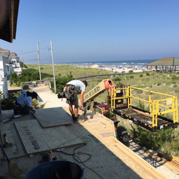

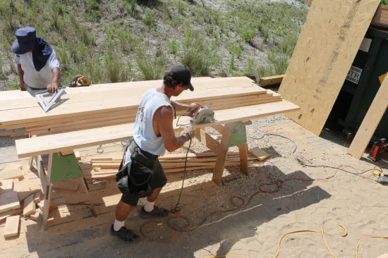

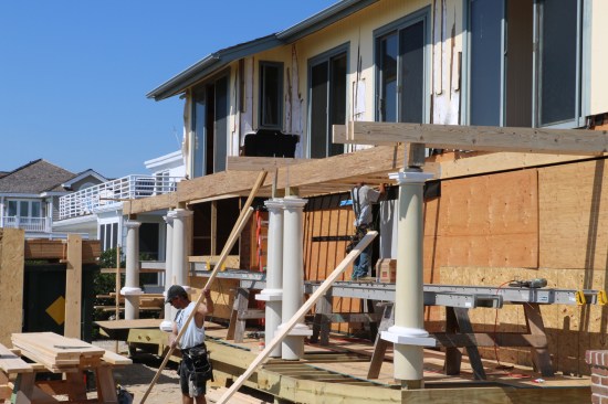

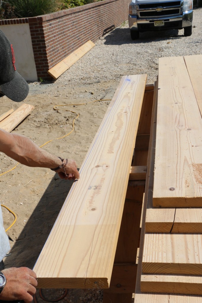

A good product needs good bones. I sized and spaced the beams and posts as I would for any traditional deck design. I sized the joists in a similar fashion, while taking into account that the joists had to taper to pitch the deck surface enough to shed water off; a slope of ¼ inch per foot is optimal. To create the taper, we stacked the joists on sawhorses and snapped a chalk line across each joist’s crowned edge. Once the lines were all snapped, a crew member ripped all of the tapers with a circular saw.
The deck for this project was more complex than most. It consisted of three sections that stretched across the front of the house. The two end sections were framed with a dropped beam, with the joists landing on top of the beam and extending past it. The center section had a flush beam, with the joists hung off the side of the beam and the tops of the joists flush with the top of the beam. The pitch of the floors was the same across all the sections, and the floor surface was flat and unbroken. Additional complications were that the end sections would be faceted where they overhung the porch below, and a parapet would run around the entire perimeter of the deck and act as a base for the railing.

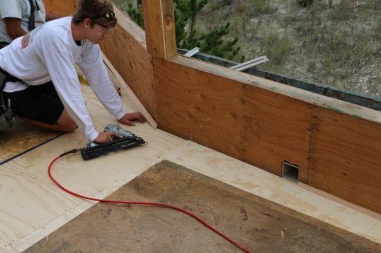

Once the framing was completed, it was time to prepare the horizontal surfaces of the deck. Although this project was a renovation, we treated the deck the same way that we would new construction, gluing and nailing ¾-inch AdvanTech T&G subfloor to the sloped joists.

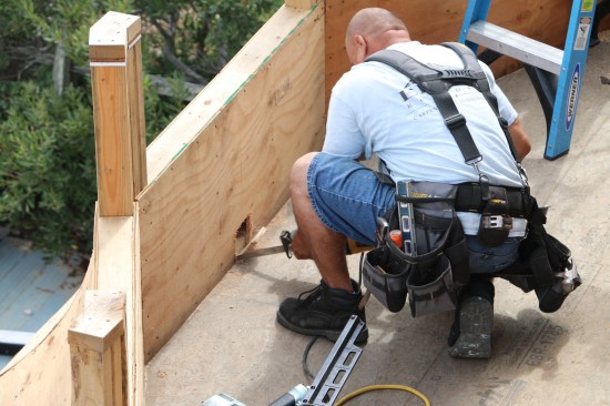

The parapet walls were next, along with the framing for the overhang details. We framed the parapet walls with 2x4s, letting the framing extend up at each corner and facet to create posts, then we sheathed the walls with ½-inch CDX plywood.

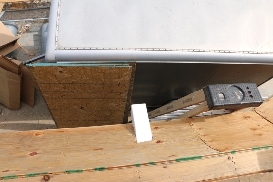

To allow water to drain from the deck surface, we cut holes for scuppers into the sheathed parapet walls. The actual scuppers are made from 4×4 square vinyl sleeves (the same ones used to cover posts in the railing and fencing industry). These sleeves are set flush with the inside of the parapet wall sheathing and rest on top of the subfloor. We set the scuppers at a slightly increased pitch and let them extend through the parapet wall just beyond the edge of the roofing.

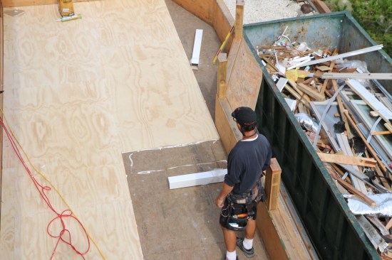

Once we could see a weather window, we scheduled our fiberglassing contractor, Brian Scheeler, with Atlantic Shores Fiberglass. We needed the better part of a day to prepare for his arrival. We first put down an underlayment layer of ½-inch AC plywood on top of the subfloor with the sanded side up, staggering the joints of the plywood between courses. We glued down the AC plywood with construction adhesive and nailed it into the joists through the subfloor using ring-shanked nails.

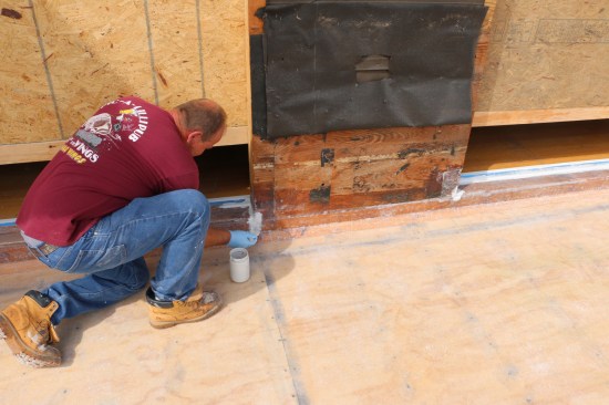

Next, we milled 1 ½-inch-by-1 ½-inch cant strips by ripping 2-by material at a 45-degree angle. Fastened along the corner where the flat deck and any of the vertical walls (house and parapet) intersected, the cant strips ease the 90-degree bend for the fiberglass mat that will eventually cover the deck, softening the transition and preventing voids from forming between the mat and the layers below.

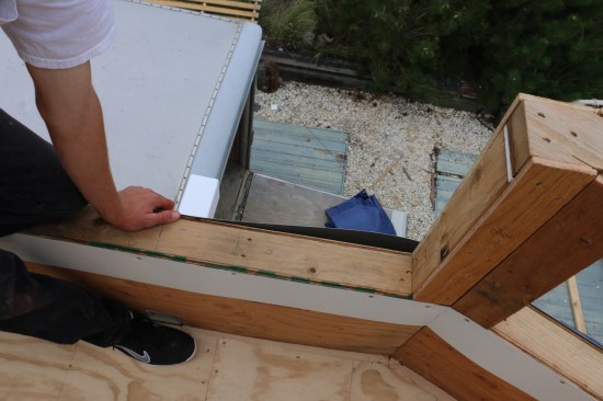

We paid close attention to the detailing of the tops of the parapet walls. They were to be fiberglassed, but for added protection, we ran aluminum coil stock along the top of the parapets, inside and out.
After the fiberglassing was complete, we would tuck felt paper under the coil stock on the inside. On the outside, we’d run adhesive-backed membrane up and under the aluminum before applying the exterior finishes.

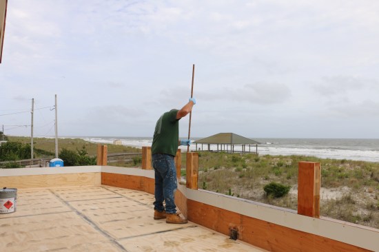

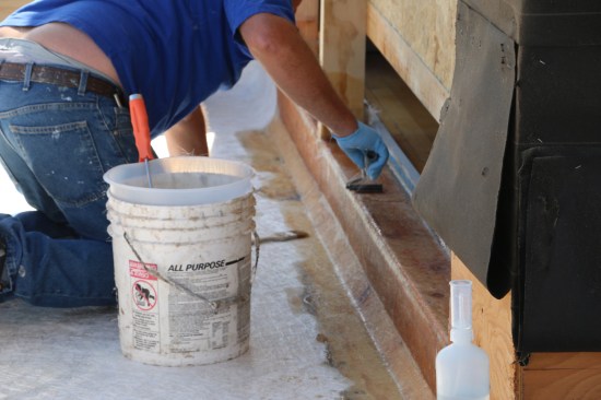

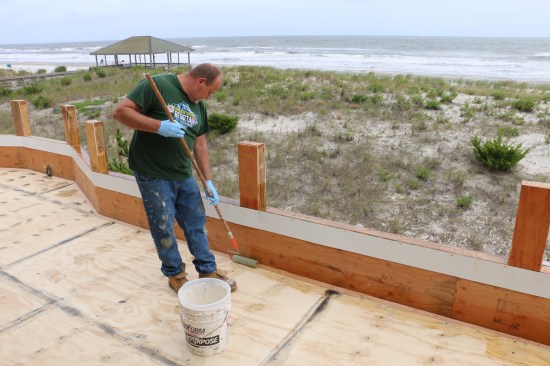

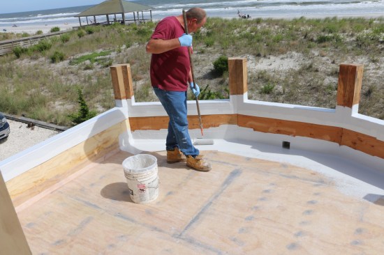

The next step was “hot coating” all the deck surfaces by applying resin with a thick-nap paint roller. Working with fiberglass calls for many single-use tools—once the resin cures, paint rollers and brushes become rock hard. So Brian uses disposable products: cheap paint rollers, disposable paintbrushes, and 5-gallon-bucket liners. For detail work, he also uses plastic or aluminum rollers that are reusable and that are made specifically for fiberglass work. These tools can be cleaned with acetone before the resin cures, but it’s challenging and the fumes are dangerous.
Working from the top down, Brian began by coating the top surface of the parapet walls, rolling the resin 8 inches to 10 inches up each post. At the base of the parapet walls, he rolled the resin over the cant strip and up the walls about 10 inches.
On some projects that he’s worked on with us, he has applied a strip of the fiberglass mat along the transition between the deck and the walls at the hot-coating stage—the mat strips help to reinforce and ease the transition between the horizontal and vertical surfaces. He skipped that step with this project, opting to extend the mat up the walls at the next step, on the second day.
At the thresholds of the doors leading onto the deck, he applied resin up the framing and sheathing. Finally, he put a liberal coat of resin over the entire flat surface of the deck. It should also be noted that Brian mixes only a little resin at a time. The working time of mixed resin is limited and a large volume of material will usually “kick” more quickly. Smaller batches ensure that the resin does not begin curing before it is applied.
Once the hot-coat resin cures, the deck is temporarily sealed. A rainstorm would not be ideal, but it wouldn’t ruin the project, at this stage.

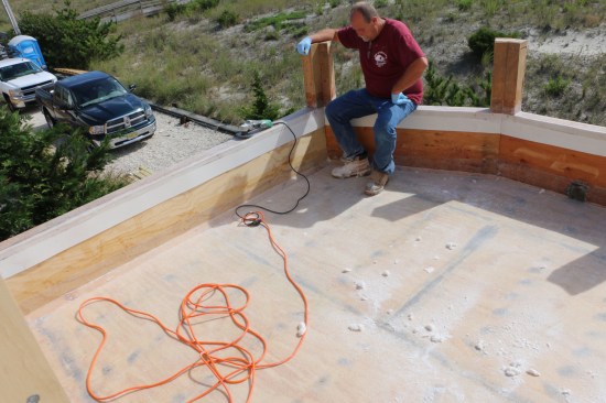

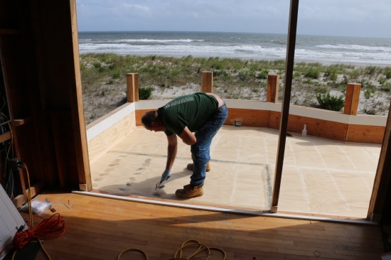

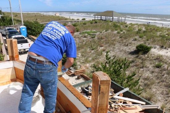

On the second day, Brian started by grinding all the hot-coated surfaces, again using a small grinder fitted with an abrasive disc. This process removes irregularities and abrades the surface for the next coat. When finished, he blew the dust off the deck with an electric leaf blower.

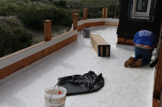

Next, he laid out 1.5-ounce chopped fiberglass mat over the deck surface. He let the mat extend up the parapet walls about
6 inches and lapped it about 4 inches into the scuppers. He used smaller scraps to complete the mat layer around the scuppers, both inside the parapet walls and where the scuppers exited on the outside.

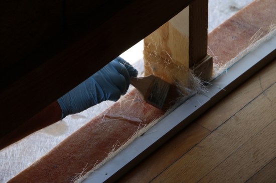

He cut strips of mat about a foot wide for the tops of the parapet walls and let the strips extend up a few inches at each post and down the sides of the parapet, overlapping onto the coil stock. At the door thresholds, we added temporary dam strips to protect the floors inside. Brian ran the mat up onto the dam strips, again adding small strips to complete the corners of the mat layer. At the seams in the field, the mat sections overlapped by 4 inches to 5 inches.

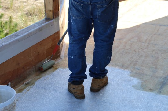

When all the pieces were cut, Brian began soaking the mat with the mixed resin, starting with the tops of the parapet walls. For the larger surfaces, he again used a disposable paint roller. For tighter details like inside corners, he soaked the resin into the mat with a disposable brush. When completely soaked with resin, the mat becomes transparent.
After finishing the tops of the parapet walls, he turned his attention to the door thresholds. This time he used a specialty roller to push the resin into the mat. The roller also helps to work out any voids or air bubbles under the mat.
Next, Brian worked on the base of the parapet walls, using a paint roller to soak the resin into the mat where it extended up the walls. Finally, he poured resin over the main surface of the floor and pushed it around with a paint roller until the entire mat was saturated and transparent.

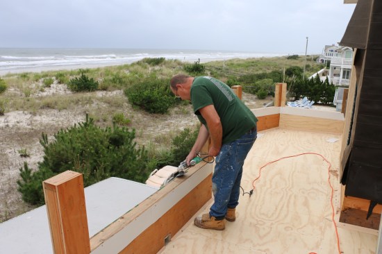

The first step was to grind all the surfaces once again to roughen the surface and to smooth out any unevenness in the mat. As before, Brian used a grinder with an abrasive disc, and he blew off the dust with a leaf blower.

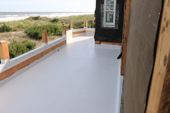

When the surface was abraded and dust-free, he applied the fiberglass gelcoat to the surface, beginning with the detail areas such as thresholds. The gelcoat is a two-part product that has the consistency of paint. Brian used a disposable paintbrush to make sure that all the nooks and crannies received a liberal layer of the gelcoat.
The next day, the installer goes over all the glassed surfaces with a sanding disc to rough them up before the finish coat.
A two-part gelcoat is the final finish on the fiberglass deck. Here the installer uses a disposable brush to coat problem areas.

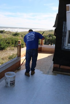

As with the resin layers, Brian used a paint roller to coat the tops of the parapet walls and the transition between the inside parapet walls and the horizontal deck surface. Then he rolled the main deck surface and his job was done.
We waited overnight for the gelcoat to fully cure before we finished the carpentry details. At the door thresholds, we removed the temporary dam strips and cut the rough, turned-up edge of the fiberglass flush with the top of the finished flooring inside the house. The fiberglass on the thresholds and jambs acts as solid pans, eliminating the need for additional flashing pans under the doors.
After rolling gelcoat on the parapets, the installer applies the finish to the transition areas.
When the gelcoat is rolled and cured on the rest of the floor, the waterproofing is complete. At this point, the deck is waterproof like a boat hull.
