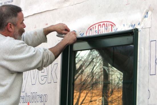

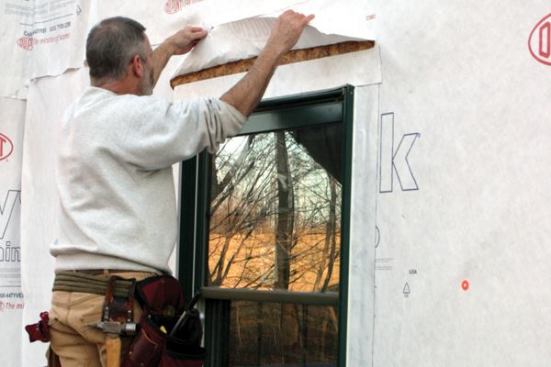

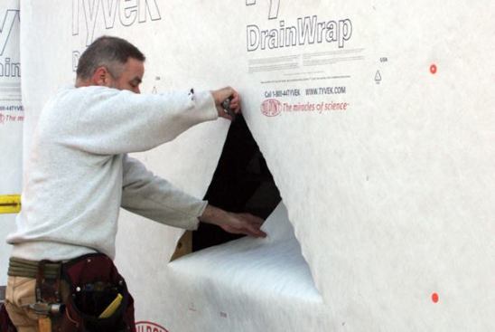

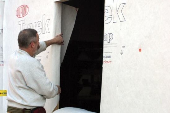

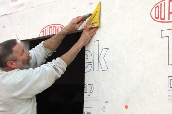

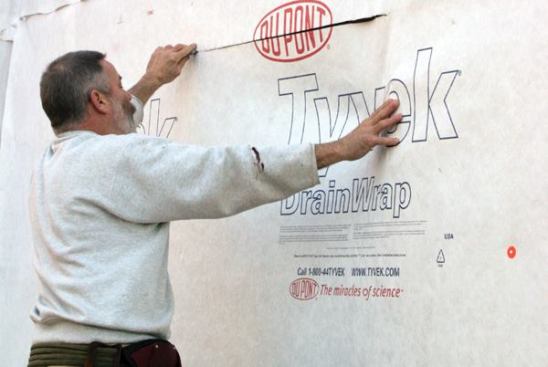

Flashing Windows: New Construction

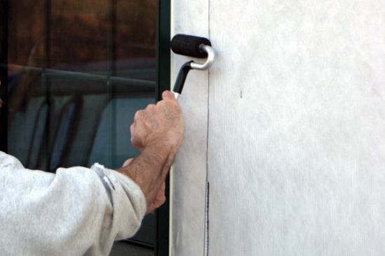

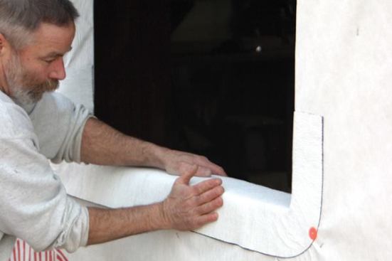

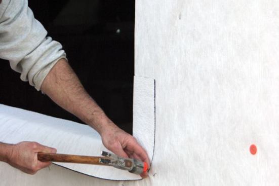

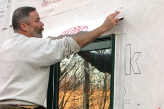

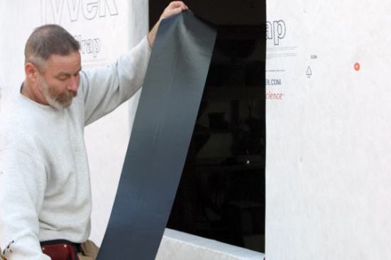

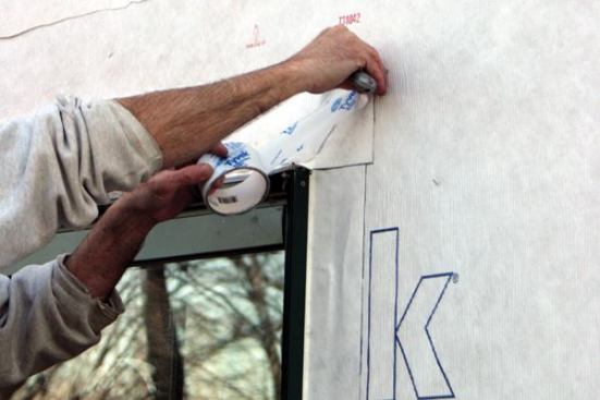

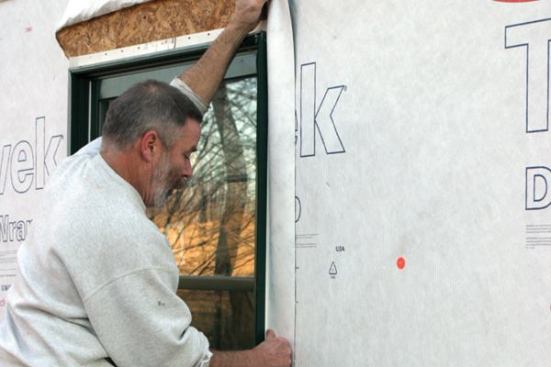

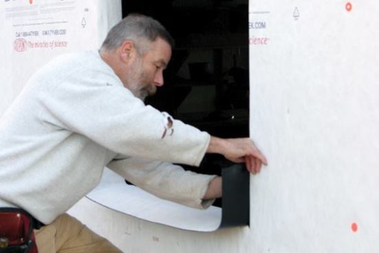

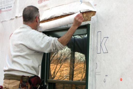

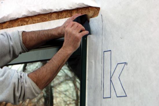

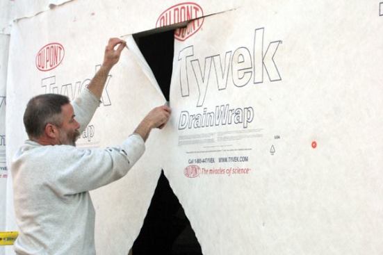

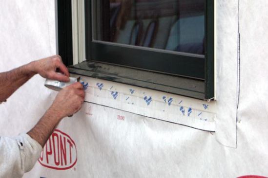

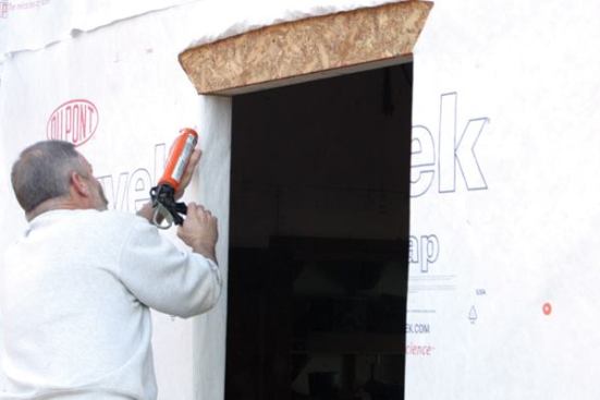

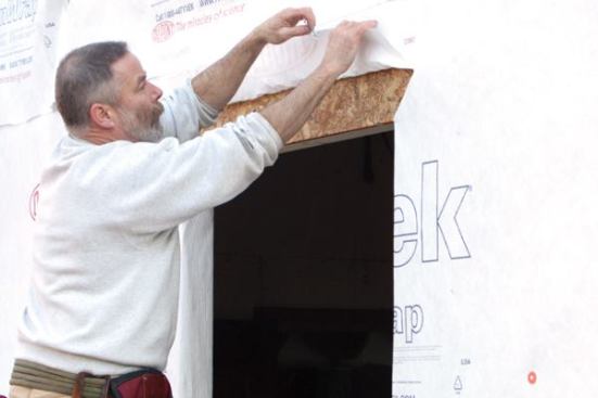

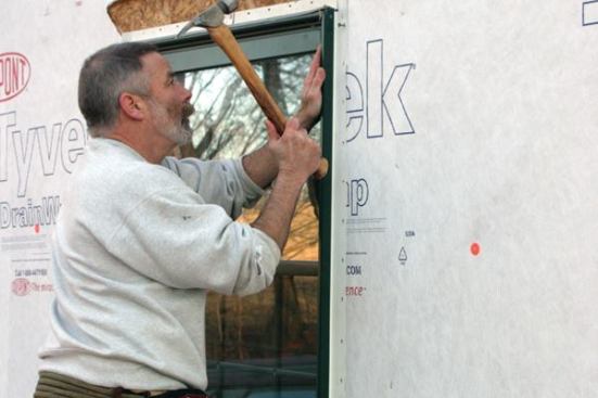

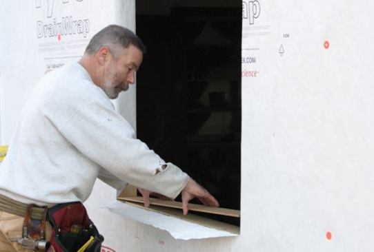

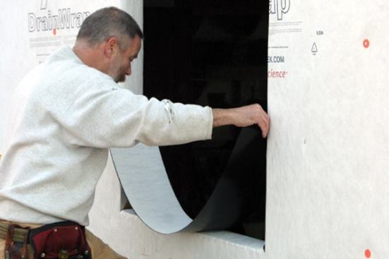

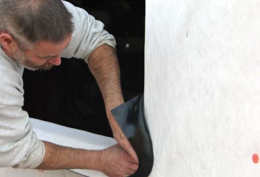

Flashing details for flanged windows vary, depending on whether on whether the job is for new construction or a retrofit, and whether you are using straight flashing or flexible flashing for the sill.
The slideshow here shows the step-by-step method for new construction and a flexible sill flashing.
