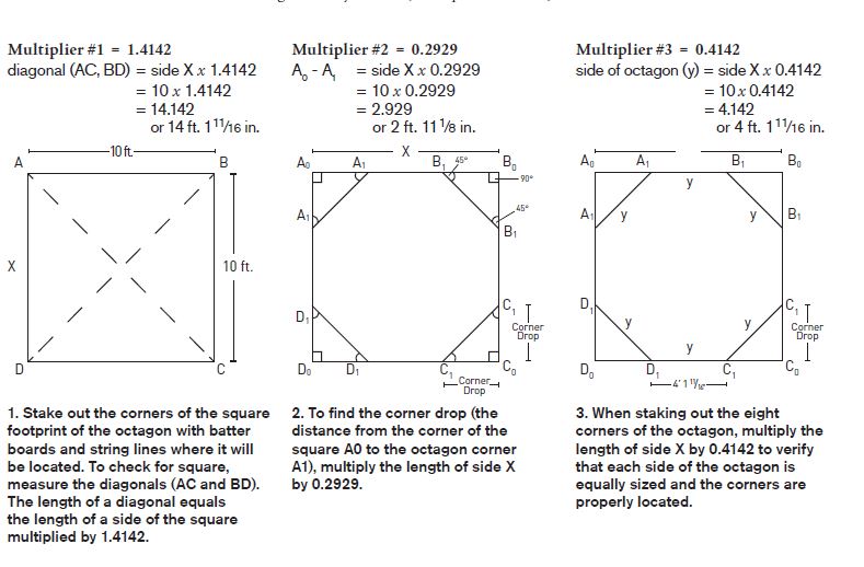

Whether you’re building a concrete patio, a deck, or an elegant pergola, if it’s in the shape of an octagon, the layout will be more challenging than for a rectangular structure. But there’s no reason to fear the trigonometry; instead, follow this process using these three multipliers to help lay out the sides.
