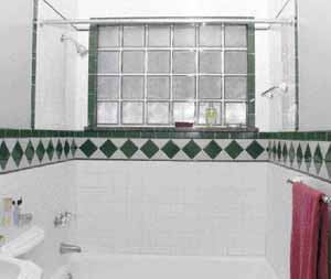

When I expanded and remodeled the 5-foot-by-12-foot bathroom shown here, for example, there was only one logical place to put the tub: along the end wall. Since that was the sole exterior wall, it was the only possible place for a window.
If I can’t avoid placing a window above a tub, I use glass block, so that the window and all the trimmings can be made with rotproof materials. In this particular project, I used concrete and granite for the sill, ceramic tile for the window surround, and glass block laid in mortar for the window panel.
Glass block offers privacy without vinyl curtains or blinds, which tend to harbor mold; also, the construction of a glass-block window is seamless, which means that keeping water out of the wall is much easier than it would be with an operable window.

To manage water flowing down the vertical glass-block panel onto the horizontal sill, I designed a 41/2-inch-thick cast-in-place concrete sill.
On the exterior, the sill extends 3 inches beyond the existing siding, providing a generous overhang that will project over the new rain-screen detail and fiber-cement siding planned for the house.
From the point where the outside face of the glass block meets the sill, the sill slopes a steep 20 degrees to direct rainwater flowing down the glass panel to the outer edge of the sill.
On the underside, a mild 5-degree slope with a drip groove keeps water flowing off the sill rather than moving back toward the house through surface tension, which can cause water to cling to the underside of horizontal (or nearly horizontal) surfaces.
The concrete sill is 6 inches wider than the glass-block panel, allowing it to extend to the outside of the 4-inch-wide exterior window trim. Because the wood casing terminates over the sill instead of running past it on either side, water running down the casing will flow over the top of the sill and drop onto the ground rather than toward the building envelope.

The vertical joint between the granite sill and the concrete is centered within the 4-inch thickness of the glass-block panel. With the panel straddling this joint, and the interior and exterior sills sloped away, water running down both faces of the panel will flow away from the joint.

Glass block is unforgiving, so it’s important to start on as straight and level a surface as you can possibly create.
On this job, I checked and rechecked my form to make sure that the concrete sill was straight and level. And during installation I aligned and spaced the blocks in the first course very carefully, because my work there would affect all of the courses above.
When building a glass-block window, the general idea is to build a panel that is supported by — but not built hard against — the opening. (For more information on building with glass block, visit Pittsburgh Corning’s informative Web site, www.pittsburghcorning.com; or see the JLC articles “Glass Block in the Bathroom,” 11/92, and “Glass Block Tips & Tricks,” 11/00.)
I built this glass-block panel with a 1/2-inch clearance between the top and sides of the panel and the opening.
To hold the panel in position, I used Pittsburgh Corning’s panel anchors, screwing them into the sides of the opening and setting them in the mortar joints.
During installation, polyethylene expansion strips placed between the panel and the rough opening helped hold the blocks in place. Later, these expansion strips would serve as a backer for the caulk I’d use to seal the interior and exterior perimeters of the window.
Because glass doesn’t absorb water from mortar, glass block tends to slide all over the place if you make the mortar too wet or work with a heavy hand. I made things easier by using Pittsburgh Corning’s specially formulated glass-block mortar with a stiff mix, which helped reduce the tendency of the glass units to “float” on the surface of the wet mortar.
I also used the company’s VeriTru plastic spacers, which are designed to hold the blocks in place as the mortar dries.
Along with the panel anchors, the finishing materials — backerboard and tile on the inside, wood window casings on the outside — help hold the finished panel in place. Instead of installing these materials tight against the panel, I maintained a small joint, which I later filled with caulk.
Besides accommodating differential movement between the glass-block panel and the framing, this caulked sealant joint prevents air and water from moving through the window.
