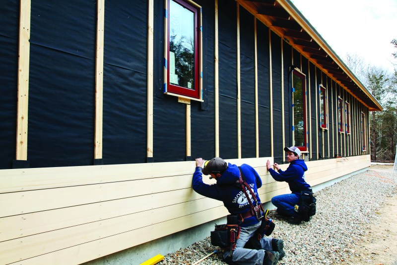

A rainscreen is a system composed of a water-protection layer along with an air space behind the siding that allows excess moisture to drain away, while allowing the siding and sheathing to dry properly. Rainscreens are applied over the sheathing, and there are many materials and systems on the market that can create successful rainscreen assemblies. These include beaded or dimpled housewraps, plastic mesh material, and linear corrugated strips in metal and plastic. They are all designed to let water that gets behind the siding drain away safely. But another option that I often recommend for the homes I design is creating a rainscreen on site with the old carpenter’s standby—wood furring strips, or strapping. Strapping is inexpensive, readily available at virtually any lumber store, and easy to install.

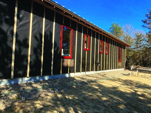

With site-built systems, the siding nails to furring strips.
In our area, strapping typically comes as 1×3 stock (2 1/2-by-3/4-inches actual). The crews usually install the strapping vertically for horizontal siding applications, letting the wood strips align with the wood-stud framing on the other side of the sheathing for a strong, long-lasting installation. The strapping we use for our rainscreen systems is not treated to avoid rot, although I’ve seen many builders who use treated 1×4 or rips of treated plywood for this application. Sometimes we paint the strapping, but that is for reasons other than avoiding rot. The reasoning behind my choice of strapping in its natural state will become clearer when we look at how this rainscreen system actually works.

In an open rainscreen, the siding nails to the furring strips with air gaps between the boards.

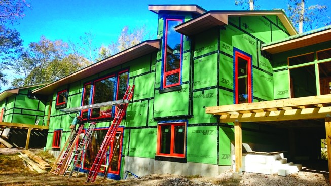

In a closed system, the sheathing is treated normally. For sheathing with an integrated barrier, such as Zip System, the strapping installs directly over the sheathing. If the building has regular OSB or plywood sheathing with housewrap or felt paper as a WRB, the strapping installs over the WRB.

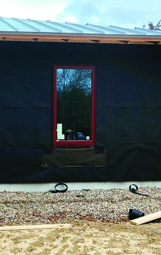

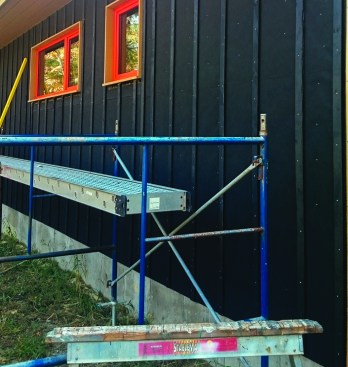

In an open rainscreen system, the gaps between the boards would allow sunlight and damaging UV rays to reach the sheathing, so that system starts with a layer of 15-lb. felt paper over the sheathing. The felt paper blocks sunlight from hitting the sheathing and degrading the WRB, while creating an effective, low-tech, and inexpensive water-shedding surface for the sheathing. The strapping then installs over the building paper.
With an open rainscreen, building paper covers the WRB to protect it from UV rays.

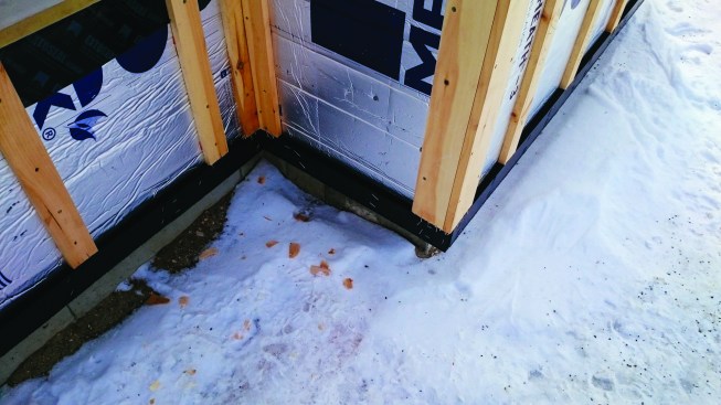

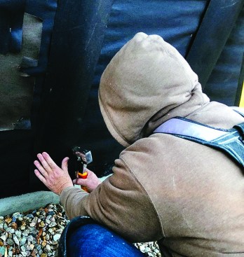

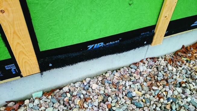

At the bottom of both types of the strapping rainscreens, the 3/4-inch space between the strapping strips lets water drain out readily, but a space like that can be an invitation to little furry friends and the like. To close it off, but still allow for drainage, I use ridge-vent mesh cut to fit and nailed in between the strapping. Another option is using manufactured corrugated plastic vents.

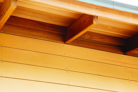

We’ve already discussed the fact that the air space between the strapping and behind the siding is great for draining away the bulk water. But while a rainscreen’s ability to drain water gets the biggest hype, the ventilation that these site-built systems provide is just as important. That 3/4-inch space behind the siding allows air to travel up and through the space, letting the cladding (along with the exterior sheathing based on its permeability) dry quickly from the inside.
Air space at the top of the wall allows ventilation for drying.
With an open system, the gaps between the siding boards provide ventilation space, so that system is virtually air open. At the top of the wall in a closed system, I either vent the air spaces into the soffit (provided the soffit is part of a vented roof assembly) or devise a detail to properly vent the air space at the frieze at the top of the wall.

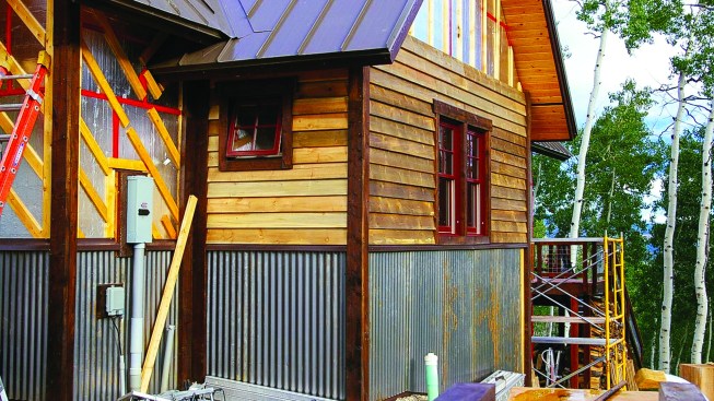

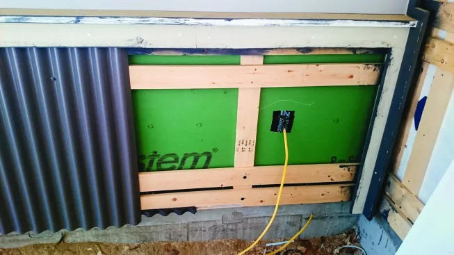

Some building projects call for vertical siding, such as board and batten. In these cases, we simply lap the strapping—adding a horizontal layer over the vertical layer—to allow for the vertical orientation of the siding. In one case where part of the elevation called for corrugated metal siding, double-lapping the strapping was a perfect solution. In another project, we installed vertical siding sections above corrugated metal siding. We did not have the luxury of making those sections 3/4 inch deeper, so we simply installed the strapping on the diagonal, leaving intermittent breaks to let the water drain out below.
A second horizontal layer of furring provides nailing for vertically applied siding, such as this corrugated metal.

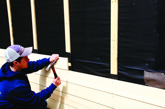

Open rainscreen systems leave the furring strips exposed in the gaps between the boards. Many different strategies can be employed to hide the natural color of the strips. One option is painting the strips before they go on.
The entire furring strip can be covered with building paper.
Tabs of building paper can be inserted as the siding goes on.

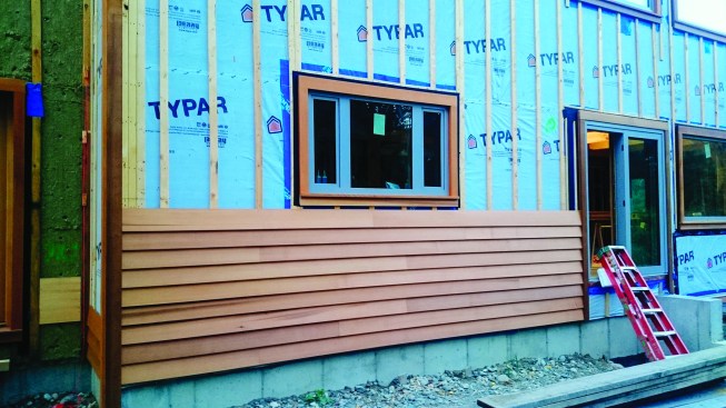

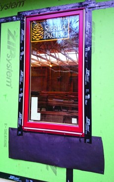

Most building walls have windows and doors to deal with. Integrating these openings into our rainscreen system is extremely important. Remember that the siding is just “makeup” for the building’s exterior—the real work is literally behind the scenes. Window and door integration starts with a well-designed and well-executed sill detail that allows any intruding moisture to drain away quickly. Meticulous detail should be paid to flashing and sealing the window into its opening (see “Installing High-Performance Windows,” Oct/15). The flap of paper under the window integrates with the layer of felt paper of the open rainscreen. Before the siding is installed, each window is completely water-managed and fully integrated with the rainscreen.
Seal all window openings and integrate them with the WRB.
A flap of building paper below the window layers into the building paper of the open rainscreen so that it sheds water properly.

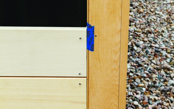

This mock-up of a corner shows how to leave the boards open for maximum air circulation in an open rainscreen system.

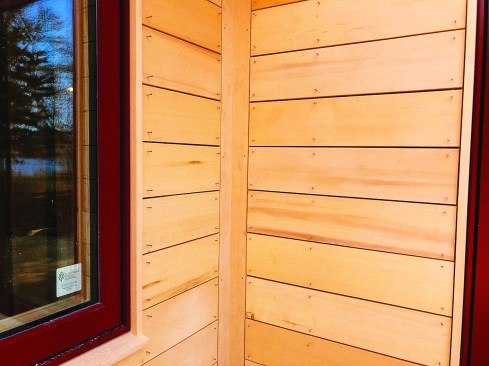

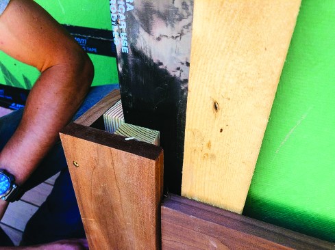

We also have to properly drain and ventilate the corners. In the mock-up shown in the photo, the corners and butt ends of the siding are free to drain and ventilate. As the open plank siding goes on, most of the installers I work with use narrow strips of wood as spacers between planks. They use the same strips to maintain the gaps around windows and at corners. And with an open-plank rainscreen, maintaining the gap above the top board is crucial for clear ventilation.

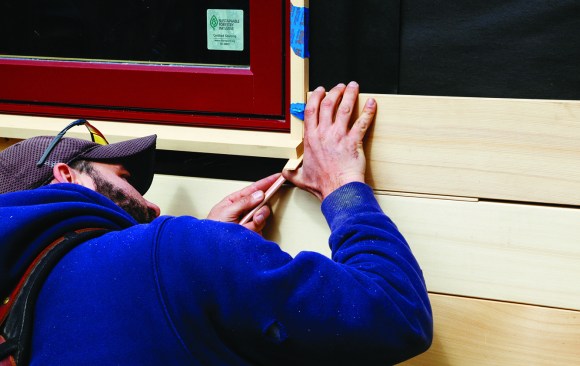

In my years of designing and installing rainscreens, I have developed a list of practices to avoid. First, always make sure corners have plenty of ventilation. Never build up columns of strapping installed next to each other. I recommend leaving a horizontal gap of at least 3/4 inch between any vertical strapping.
A carpenter scribes a board around a window in an open rainscreen system, with spacing between the boards and a space left under the window sill.

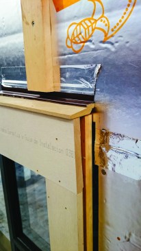

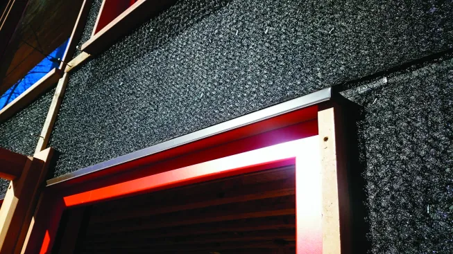

At window openings, resist the urge to install horizontal strapping at the bottom of the opening or under the sill of the installed window. Flashed sills should run freely into the rainscreen. Be sure to integrate any weep systems in the windows you are using into the sill and the rainscreen system. And treat the head of the window like the sill, with the ability to drain completely. Always terminate the strapping for the rainscreen a good distance above the head flashing.
Furring strips end well above the head flashing over a window.

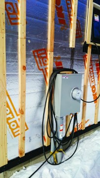

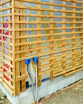

Services such as this electrical meter are furred off the wall as part of the siding.
Any services attached to wall should be considered part of the cladding, not the wall sheathing, so items such as an electrical meter get furred off the wall just like the siding.
