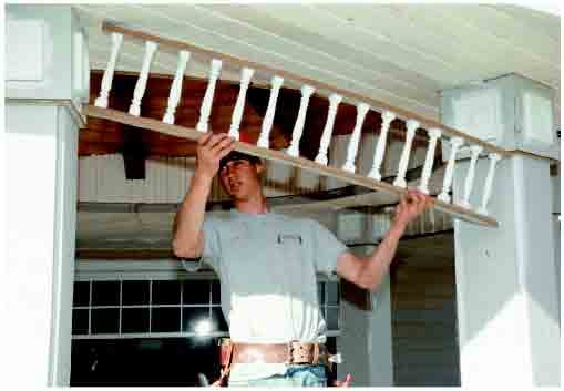

Assembly & Installation
Assembling the rails was definitely the easiest part of the job (Figure 4). First we drilled pilot holes with a tapered countersink so the painters could fill over the decking screws that secured the spindles. Before placing the spindles, we squeezed a good dab of Fypon adhesive on top of each hole. Once all the spindles were installed and the adhesive had dried, each ladderlike section was rigid and strong, even though the spindles themselves are lightweight unreinforced polyurethane.
Installation was almost as easy. Because we had used templates, each section fit perfectly the first time. We secured the top rail to the ceiling with galvanized finish nails, toenailed the bottom rails to the post capitals, then installed brackets beneath the railing with nails and more polyurethane adhesive.
