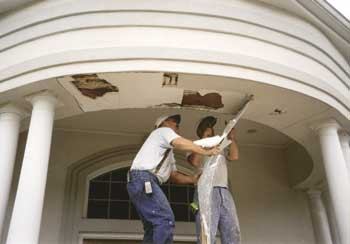

Improperly detailed EIFS joints allowed water to soak into the structure of this portico, with ugly and expensive results.
As an architect and frequent consultant on waterproofing and building envelope failures, I see a lot of EIFS problems involving water leakage and resulting structural damage. Given the number of lawsuits involving these sorts of problems in homes built over the past decade, you’d think that builders would have learned the importance of water-shedding details. But as I see almost every day, surprisingly few of them have. Although that provides me with a measure of job security, it’s also frustrating because a little attention to a few key details can eliminate a huge amount of trouble down the road.

The backer rod serves two functions: First, it prevents the caulk bead from adhering to the back of the joint, allowing the caulk to flex in response to thermal expansion and contraction and other building movements. If the backer rod is omitted, the caulk will adhere to the back of the joint as well as the sides, limiting its ability to stretch and guaranteeing premature failure. Second, it controls the thickness of the finished application of caulk, which should ideally be about half as thick as it is wide. More often than not, though, the caulk and backer rod are never applied at all. (I’m always told, “They’re in the truck.”) That was the case in the repair job photographed here, where the polystyrene board was simply butted against the trim and other surfaces (Figure 2).
Figure 2. Moisture-soaked EIFS was butted directly against the gable-end trim in this photo. Water seeped through the resulting crack and penetrated the gypsum sheathing, which had turned to gray mud in some areas. Note the impression of the reinforcing mesh on the sheathing.
When you butt EIFS up against another material, the edge of the EPS board is now exposed to water absorption, since there is not enough space to apply the base coat. The caulking, if used at all, has less than 1/16 inch of EIFS surface to adhere to in order to seal against water entry. I have even heard EIFS contractors try to defend themselves in a failed application by pointing out that they had diligently backwrapped the edges of the EPS board with mesh, as required. But unless the mesh-wrapped edges are also embedded in basecoat, this does no good at all (Figure 3).
Figure 3. The EIFS applicator backwrapped the edges of the polystyrene with mesh, as specified — an empty exercise, because the tight spacing made it impossible to apply EIFS to the edges of the sheets.
