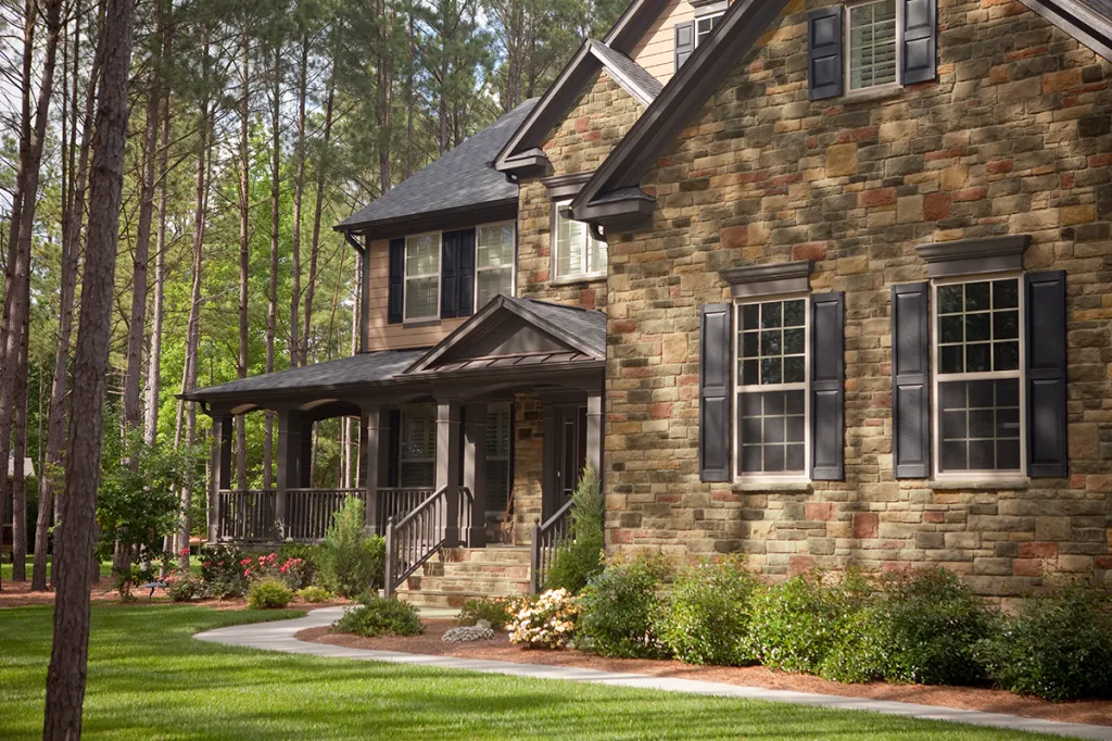

The Remodeling Magazine Cost vs Value Report for 2020 lists Manufactured Stone Veneer as the top-rated remodeling project for return on investment, with an average of 95.6% of the cost of the project retained in resale. Manufactured stone adds a dramatic and elegant style to any home and when installed properly, provides a durable and virtually maintenance-free exterior.

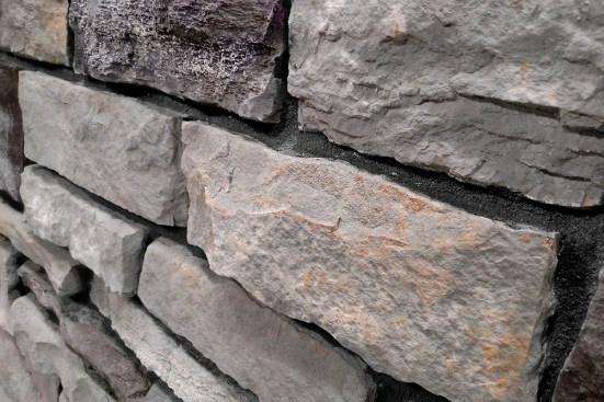

Plan your Pattern: Position the stones out on the ground before installation, so you can arrange them in a pleasing pattern and ensure you have enough material. Mix different sizes, textures, and colors for an organic look, and choose stones from different boxes to get a blend of profiles. This step also allows you to see which stones may need trimming, so have your nippers, hatchet, hammer, or circular saw handy.

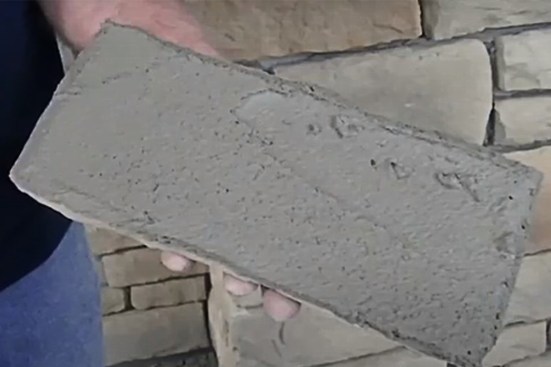

Begin the Installation: Using a 12-inch trowel, spread mortar ½- to 5/8-inch thick over the metal barrier material; after it is dry, scratch or score the surface horizontally to create a rough coat that will ensure a good bond.
Start applying stone at the outside corners; alternate long and short legs as you go up the corner, for a staggered effect. Next apply inside corners, placing stones so they dovetail together. Now begin placing the flat stones, working from the inside out. Install stone no closer than 4-inch to final grade and 2-inch to hard surfaces such as a sidewalk or driveway. When applying mortar, spread thoroughly on the back and sides of each stone.
When placing the stone, wiggle to get it into position, then press to adhere. Strike off the excess mortar that may squeeze out. Check your level plumb regularly to ensure consistent, level rows, and cover 5 sq. ft. of surface area at a time. For detailed installation instructions, see the ProVia Stone Installation Guide.

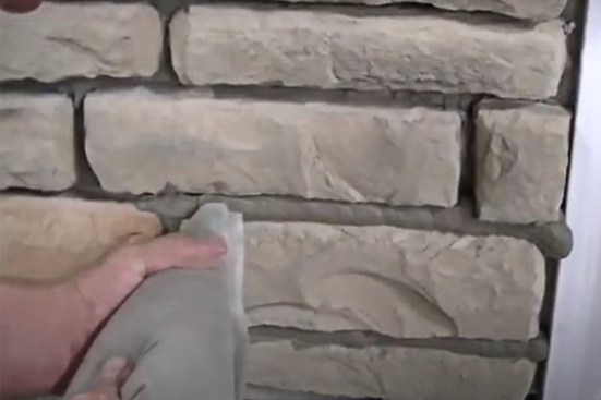

Grouting Techniques: For grouting the joints between the stones, place your grouting mixture in a plastic or nylon grout bag. Fill to 8 inches from the top and twist; snip off the tip of the bag to about the size of a quarter. Squeeze grout into the joints, filling until it is flush with the stone. When firm, use a wooden striking tool to remove excess and even out surface. Next, use a plastic bristle brush to gently loosen grout particles.
Colored grout can give the finished wall a complementary or contrasting look from the stone, or other features such as the siding or roof. Use ProVia’s Grout Color Visualizer see how the finished wall will look. Grout texture can provide visual impact as well: a smooth raked finish allows the stone to be the focal point, while a rough finish or over-grouting gives a rustic appearance.
