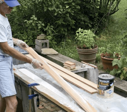

To make my floorboards as impermeable as possible, I coat them with a clear, paintable wood preservative such as Woodlife Classic (800/556-7737, wolman.com). Instead of using a brush, I apply this treatment by soaking the boards for a minute or two in a makeshift dip tank made from scrap 2x4s and 6-mil poly. Then I set them aside to dry for at least 24 hours. The following day, I use a brush or a sprayer to coat all surfaces (especially end grain) with a high-quality exterior primer.

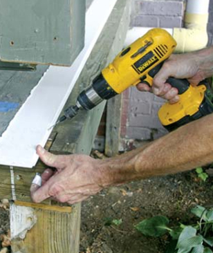

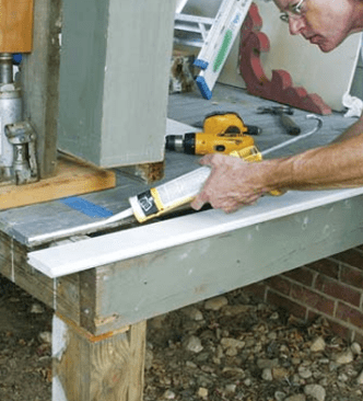

Installation is straightforward. I blind-nail the floor boards into the joists by driving 8-penny galvanized finish nails at a 45-degree angle starting at the back of the tongue; to prevent the tongue from splitting I predrill every nail hole. The tongue is particularly vulnerable to rot, especially if water seeps in around the nail holes, so after the nails are set, I run a bead of caulk over the full length of the tongue to provide an extra level of protection.

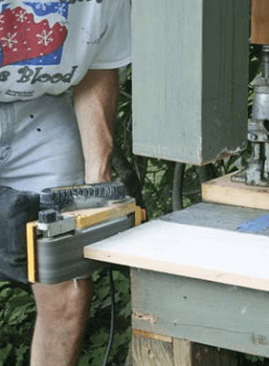

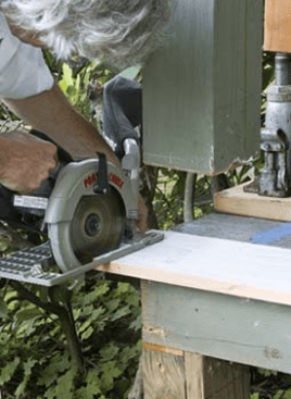

After all of the floorboards are in place, I snap a chalk line, trim the floorboards to length with a circular saw, then fine-tune the cut with a belt sander. Before I put away the sander, I run it across the front edge of the existing flooring to remove the old paint and expose the end grain. I do this in preparation for the final phase of my process: ensuring that the end grain — new as well as old — is completely sealed. Without this extra step, the end grain will drink up water like a straw. Paint alone provides temporary protection at best.

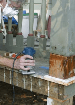

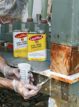

One popular solution to this problem is to glue a piece of half-round molding onto the front edge of the floorboards — which is fine as long as the molding doesn’t get beaten up by foot traffic. I prefer to round the top edge of the flooring with a 3/16-inch roundover bit, then seal the end grain using an epoxy consolidant from Abatron (800/445-1754, abatron.com), System Three (800/333-5514, systemthree.com), or one of the other epoxy manufacturers.
After the consolidant dries, the end grain takes on a rock-hard consistency that’s impervious to moisture but holds paint very well.

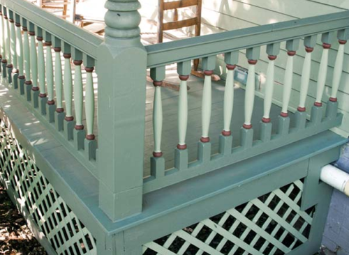

In addition to longevity, the upside of this admittedly labor-intensive process is that it makes for a very stable floor — you won’t see wide cracks opening and closing due to changes in temperature and humidity. And from a contractor’s point of view, my strategy isn’t as inefficient as it might seem: Over the years, I’ve typically had floorboards delivered to my shop well ahead of time. Then if a helper is caught up or a job gets get rained out, someone can be dipping or priming floorboards during what would otherwise be downtime.
