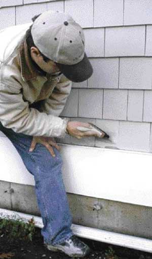

Q. How soon after power-washing will the wood be dry enough to paint?
A.
It might take a week, or it might take less than a day. There is no standard time to wait — it depends on the wind, the rain, the sun, how hard you sprayed the wall, the condition of the existing paint, and so on. But a moisture meter can give you a firm answer in every case. We use one on every job, because it eliminates guessing and arguments. Wood will dry out and stabilize at about a 10% to 12% moisture content in the outdoor air, but 15% or lower is acceptable for paint. If it's higher than 15%, moisture will be trying to get out of the wood, and that will prevent the paint from adhering properly.
Pin-type moisture meters (see photos, below) that sell for around $200 are okay for rough lumber, or for areas of a trim board that will be covered up. For about $300 you can get a nondestructive model that doesn't make any holes in the wood — just hold it against the surface, and it will read the moisture content as deep as 3/4 inch into the piece. Both types give a more accurate reading on dense hardwoods than on softwoods like pine or cedar — softwood may read 15% on the dial when the true moisture content is a little higher. But the manufacturers of the devices supply charts of correction factors, so you can interpret the moisture readings for different types of wood.
Pin-type moisture meters leave holes in the wood.
While the slightly more costly nondestructive type can read interior moisture 3/4 inch beneath the surface without marking the piece. Readings from either should be interpreted for different wood species according to charts supplied by the instrument suppliers.
