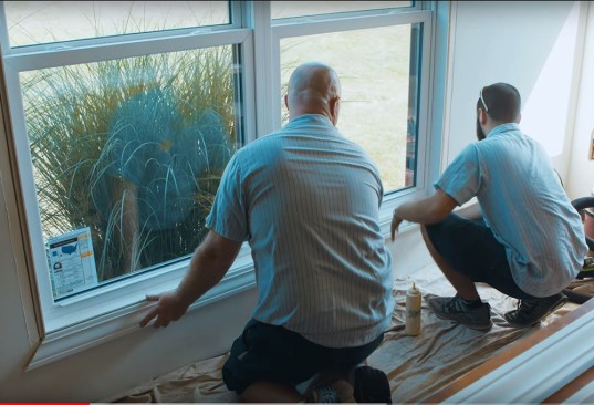

  5. Cover and protect floors, walls and furniture with a dropcloth, protection paper or rubber mat. “A rubber mat that can be easily rolled up and reused can add better protection than a drop cloth alone,” Mast says.

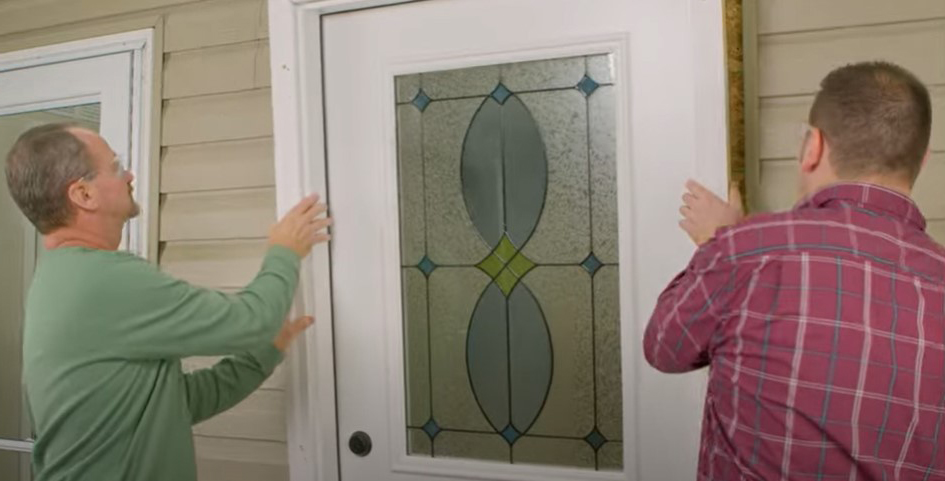

  10. Ensure the product you’ve brought is what the homeowner ordered. Also be sure to ask their preference for the install — for example, which way the door should swing, which patio door should be the slider, or which is the active part of a French door? Don’t assume you know what they prefer.
