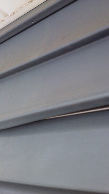

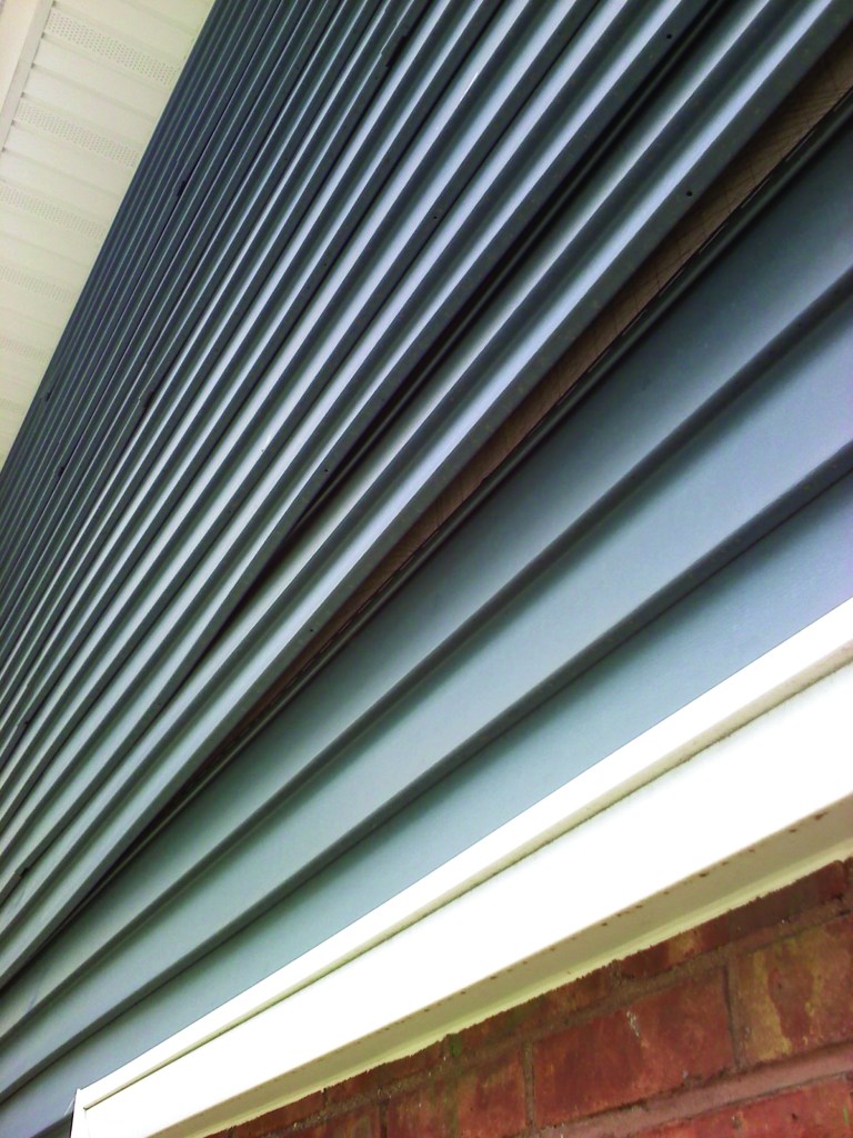

Now when I drive through those neighborhoods, I see many homes that still have their original cladding. And on just about every one that’s more than a single story, there’s at least one wall where the vinyl siding has unlocked somewhere between the first and second floors. In other words, the joint that snaps the sections of siding together has become unsnapped. While I see this problem most often on the gable ends, it is not limited to that area.
RIM JOISTS TO BLAME?
So what’s the culprit here? I can only speculate, but I’d put my money on shrinkage in the second-floor rim joist and wall plates. When this shrinking and settling occur, a siding panel attached to the second floor drops down, causing it to unlock from the panel below that’s attached to the first floor. Another possible cause can be improperly stacking heavy building materials, such as drywall, during construction. Leaving all that material in one place can cause the plates to compress, which can result in the siding panels becoming unlocked.

Usually the gap between the panel locks is larger at the middle of the wall (as much as an inch), and then it tapers to a smaller gap near the sides of the building. The goal is to create a lower locking strip along the top of the lower panel so that it re-engages the lock strip on the bottom of the upper panel.

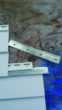

There are two different ways to reconnect separated panels. The first method is cutting a strip off a metal starter strip and inserting it into the lower locking strip to engage the separated panel at a lower level.

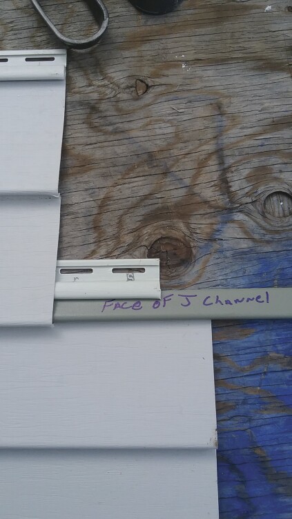

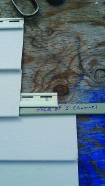

The second method is cutting the face off J-channel and inserting it into the locking strip of the lower panel.
Instead of physically lowering the lower panel, I add what amounts to a secondary lock strip below the existing lock strip. If the gap is large—an inch or more—I cut a metal siding starter strip to the width I need, which I determine simply by measuring the distance from the bottom of the upper panel to the bottom edge of the locking strip on the lower panel. When that width narrows from the middle of the wall to the edges, I taper the cut along the starter strip as needed.

If the unlocked panels are closer together and I need a narrower profile strip to engage the top panel, I cut the face off a length of vinyl J-channel and use that instead. With either strategy, I insert the cut strip behind the lock on the lower panel, which holds it in place. Then I run my sideswiper tool down the locking strip of the top panel to lock it into the strip I’ve added. The lower course ends up slightly narrower than the rest when the new strip locks into the upper panel, but in most cases, the difference is barely noticeable from the ground.
