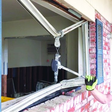

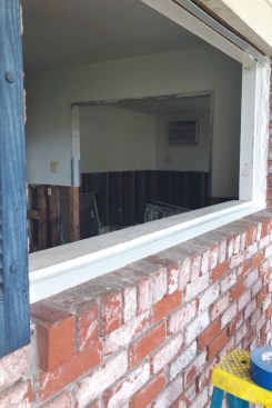

The author identified several existing homes that were gutted and standing empty. The crew pulled existing single-glazed windows from the openings.
The FMA/AAMA/WDMA Installation Committee has created a number of similar documents pertaining to new construction. In those cases, the methods were tested and proven using mocked-up walls built in a laboratory setting. But this time, the idea was to demonstrate and test a method of installing replacement windows in a realistic setting.
I located several buildings in Louisiana that had been damaged in the 2016 floods and were gutted and standing empty. With help from committee members, industry representatives, and a local contractor, we installed two windows in each of three houses using various materials and methods and then tested the installations for water leakage using the standard test method ASTM E 1105. In the next few pages, I’ll describe how we installed and tested the windows and what we learned from the process.

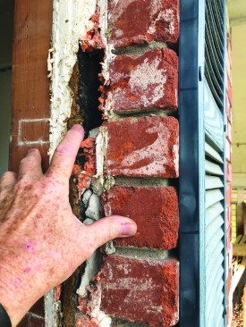

Inspection revealed that, in general, there was no intact drainage plane to be identified behind the existing brick, so the decision was made to isolate the replacement windows from the walls.
Because field conditions varied so widely, the committee decided to treat the surrounding wall system in each of the three homes as an unknown factor that could not be relied upon for robust integration from an air- and water-management standpoint. The principle of membrane drainage behind the wall façade simply did not apply. Instead, the decision was made to isolate the windows from the brick wall and the wood frame behind it. With the opening isolated, water would not be able to enter the wall through the window and the window opening; any water entering the opening would be directed to the exterior.

Once the homes were identified, I set out to take measurements. Because we would not be removing the exterior cladding, it was important to take measurements inside and outside and identify the limiting dimension.
The standard is to take six measurements: bottom, middle, and top on the sides of the opening, and left, middle, and right on the head and sill. For sizing windows, the smallest measurement is selected. In this case, we measured the rough wall framing as well as the brick-veneer opening, for a total of 12 measurements.
To determine the actual window dimensions to order, a deduction is made from the exact rough opening size. The amount subtracted depends on the window manufacturer’s specifications. I prefer to make a note of the exact measurement of the opening on site and calculate the deductions later at the office, or at least somewhere there are no distractions.
Since these homes had been flooded and gutted, the interior finish had been removed and the wall cavities were open, so we took the measurements from framing rather than from finishes. In most situations, however, there would be some material—drywall or wood, for example—in the returns, which would need to be accounted for. In that case, it would be necessary to think about whether to size the window to fit inside the existing jamb return finishes, or to remove the jamb return finishes and go to the framing.
Another decision to be made is about fastening the windows. These windows were block frame—that is, with no mounting flange—and so we could either fasten the windows through the jamb or secure them using masonry clips.
We also had to make a decision about the placement of the replacement windows: whether the exterior face of the window would be flush with the framing or extend past it partway so the jambs overlapped the brick on the sides of the opening. Because there was no intention to add brickmold to the installation, we decided to extend the outer face of the window beyond the framing, covering the gap between the sheathing and the interior face of the brick. As it turned out, that space between the brick and the sheathing meant that we needed to use clips to install the windows, because not enough of the window jambs overlapped the framing to fasten the jambs directly to the framing.

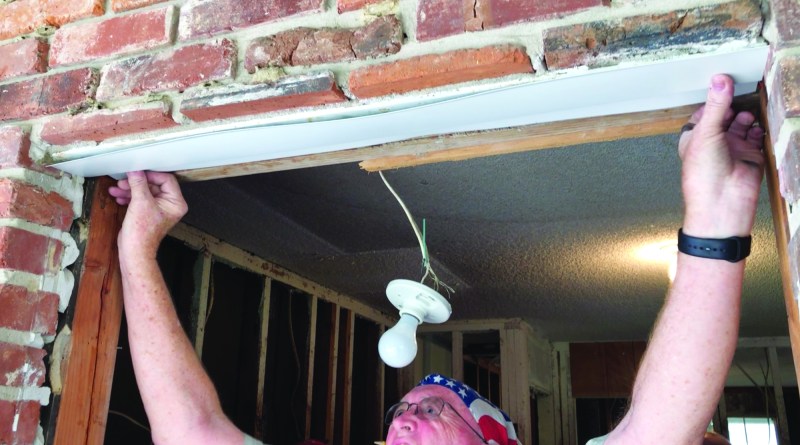

Site-bent coil stock was used at the head and sill of the openings to direct water out to the face of the exterior.

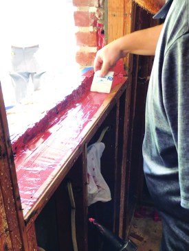

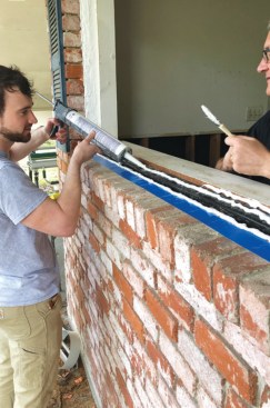

There were two basic steps involved once the conditions were identified. We needed to fill the gap between the interior face of the brick and the exterior face of the sheathing, then we needed to seal up the opening against water intrusion. We filled the gaps using gun foam or backer rod, then covered the rough-opening jamb area with liquid-applied flashing to create a moisture-resistant cavity to keep water from entering the wall and to isolate the opening. On these perimeter gap details, some form of gap filler (such as backer rod) is necessary to create an effective caulk joint. This prevents three-sided adhesion and creates an hourglass-shaped caulk bead. It’s important to have a sealant with high solids content and with good adhesion (meaning it sticks to the substrate) and good cohesion (meaning it sticks to itself).
We employed a combination of materials on each window. On some windows, the installers placed backer rod in the gap between the brick and the sheathing, then applied Prosoco R-Guard FastFlash to the jambs. In other cases, they filled the gap using gun foam and completed the seal using DuPont Tyvek Fluid-Applied Flashing and Joint Compound. The DuPont and Prosoco products are both high-solids Silyl Terminated Polyether (STPE) formulas able to be gun-applied and troweled. (In other window replacement projects where brick left a rough, irregular opening, we have found these liquid-applied flashing products to be by far the simplest way to isolate the opening and especially to create a panning system at the sill.)

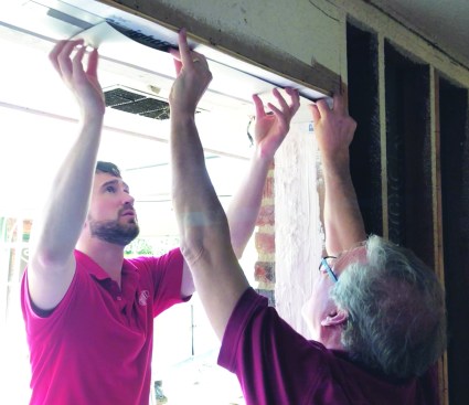

In addition to using liquid-applied sealants, we fabricated head and sill flashings. Vinyl coil stock was used at the head and sill to deflect water in the wall out over the head and to direct water that might leak through windows out over the brick at the sill. At the head, we tried two different ways of attaching the flashing. In one case, we stuck the flashing onto the framing using Echo double-sided tape, but in most cases, we simply wedged the bent flashing up between the sheathing and the framing so that friction could hold it in place until the window was installed.
Once the windows were installed and the masonry clips were secured, the perimeter joint around the new windows was addressed. From the exterior, sealant was installed around the head and the side jambs and at the sill. A couple of gaps were left at the bottom to allow any incidental water to drain. Remember, we are using a drainage system where any water from the window or other sources is not trapped in the cavity defined by the window jamb thickness. This also requires that the window be spaced a little off the sill to allow water to drain.
On the interior, the joint between the window and the framing was fully caulked (with no drainage gap at the bottom), using the same materials and methods as on the exterior. Before testing, all the caulk was allowed to cure according to manufacturer’s instructions.
