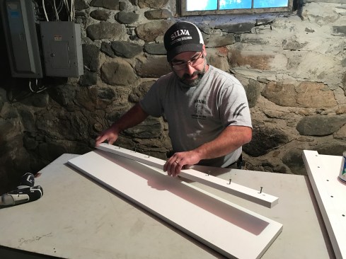

After the windows arrived, I used them to determine the exact sizes of the parts for the window frames. The original window sills extended only about 1/2 inch beyond the foundation, which concerned me. So I decided to make them about an inch wider to better deflect water away from the foundation.

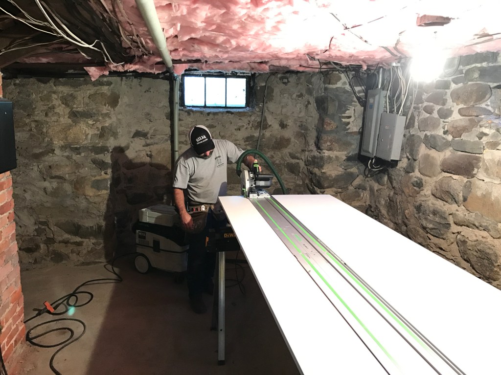

I always cut the pieces I need from PVC sheets because I can make them any size I need with minimal waste. Using a Trac Saw, I ripped all the larger widths, labeling them as I went. For smaller rips, I used a table saw. I then cut the sides of the frame to length on the miter saw, including the 12-degree angle needed for the sloped sill.
After cutting the sill stock to a rough length, I glued and screwed a 2-inch-wide piece onto the outer edge to double the thickness where the sill extended beyond the foundation.

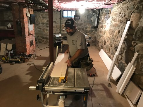

After cutting the sill stock to a rough length, I glued and screwed a 2-inch-wide piece onto the outer edge to double the thickness where the sill extended beyond the foundation. After gluing the two pieces together, I ran the assembly through a table saw with the blade set at a 12-degree angle to make the outer edge plumb. To help keep water from entering under the sill through capillary action, I cut a saw kerf 1/2 inch in and about 3/8 inch deep along the bottom outer edge of the sill. Finally, I stacked the head jamb and sill together and cut them to the same length with one pass on a miter saw.

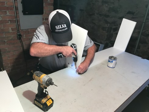

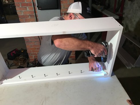

To assemble the frame, I drilled pocket holes along the bottom edges and secured them to the sills with weather-resistant pocket screws and PVC glue. I finished the frame by gluing and screwing the head jambs to the sides with deck screws to form simple butt joints.

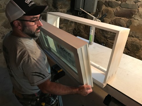

Windows Go Into the Frames
Before I could put the new units into the frames I’d built, I needed to install the interior stops for the windows to fit against. Taking the lengths directly from the frame, I marked each stop piece and cut it to length. After predrilling the stops and inserting screws in my holes, I screwed the stops into place, using a spacer block as a guide to space them evenly from the inside edge of the frame.

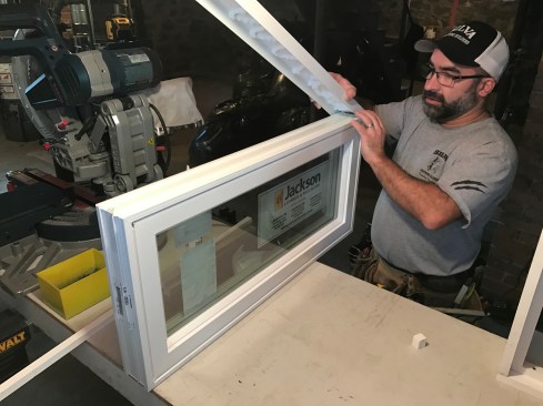

Each window came with a head expander that slides up to fill the gap at the top of the window. I applied polyurethane low-expansion foam to each expander and slid it onto the top of a window. Next I squeezed out a bead of caulk (I used DAP Dynaflex 230, an elastomeric latex sealant) onto the front side of the stops and pressed the window against the stops, leaving equal space along both sides for insulation.

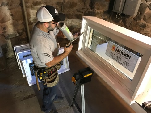

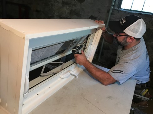

Opening the windows let me access the holes for securing the units to the frames, which I did with four screws short enough not to go through the frames. I then checked the frame for square by taking diagonal measurements. If adjustments had been needed, I would have used the attachment screws to tweak the fit.

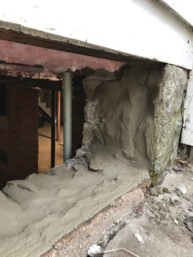

As I was removing the windows, I noticed that some of the openings needed additional attention. The old rubble stone foundation hadn’t been maintained through the years, and a few stones were loose. After vacuuming up any loose debris, I applied a bonding agent that helped the new mortar adhere to the stones and to the old mortar. Using Type-N mortar, I secured the loose stones and then applied a coat of new mortar to the entire opening, brushing it smooth.

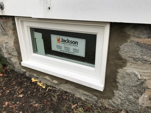

After the foam had cured, I applied mortar around the perimeter of the frames, both inside and outside. When the mortar had cured a few days later, I cleaned the mortar residue off the stones around the opening with muriatic acid.
The impact of the new windows was immediate. Opening the windows quickly improved the musty smell of the basement, which was much brighter with the added light. And the new double-glazed basement windows made of rot-proof material should easily perform better and last far longer than the original windows.
