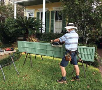

Stripping the Shutters
After dealing with the hardware, I usually have the shutters chemically stripped; at $25 to $30 per panel, it’s well worth it. When I get the shutters back, I use a garden sprayer to apply a 10-to-1 solution of muriatic acid (or vinegar) and water to neutralize the stripper. Standing the shutters on simple racks made from 4×4 posts and 3/8-inch steel pins makes this and the eventual repainting process a lot easier.
After giving the wood a good soaking with the neutralizer, I let it dry to 14 percent — the equilibrium moisture content for cypress in my climate — then start digging out the rot with my “dental picks” and 5-in-1 painter’s tool.
For larger areas, I use either a rotary rasp chucked into a die grinder or a drill with a 3/8-inch bit.
Rot Repair
I try to get back to fairly sound wood before making rot repairs, then soak the damaged areas with Wood Care Systems’ Bora-Care (800/827-3480, ewoodcare.com) mixed 1-to-1 with water and applied with a brush or syringe.
Once that solution dries, I treat any remaining spongy areas with LiquidWood epoxy from Abatron (800/445-1754, abatron.com). With the LiquidWood still wet, I fill the rot cavities with WoodEpox putty, another Abatron product.
For large holes, I use West System epoxy (866/937-8797, westsystem.com), adding one of the company’s fillers or even sawdust to the mix when needed. (An excellent online user’s manual explains the system.) West is so hard when it dries it can be a bear to sand, so I cap off repairs with one of the Abatron epoxies before the West System is fully cured.
