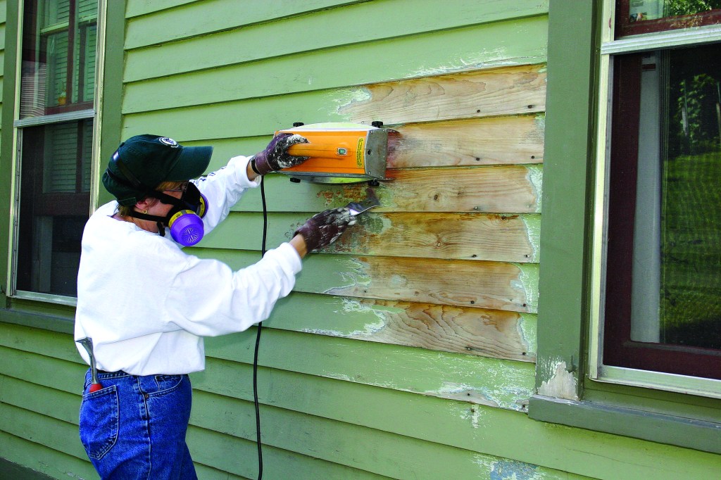

The original Speedheater 1100 is particularly well suited for stripping paint from flat surfaces.

Like its older brother, the Speedheater 1100 (in photo above, removing paint from clapboards), the new Cobra uses infrared (IR) radiation to separate multiple layers of paint from the wood substrate. Compared with torches or heat guns, IR paint strippers operate at significantly lower temperatures (200°F to 400°F) that won’t vaporize harmful chemicals such as lead, or pose a fire hazard—if used as directed.
I bought an 1100 way back in 2004, and it quickly became my go-to for stripping paint from broad surfaces, such as clapboards and baseboards. But the 1100 is bulky, and not quite as effective at softening layers of old paint that have taken refuge within inside corners and the crevices of moldings.

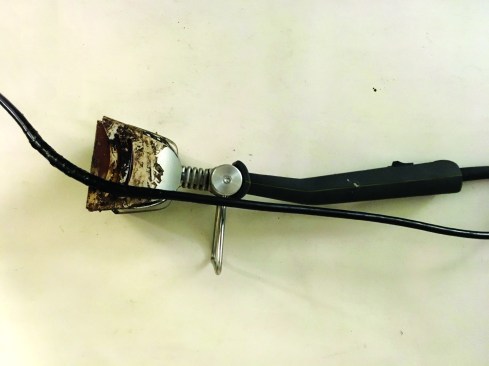

The new, compact  Speedheater Cobra  is designed for smaller surfaces. The  heating element does not get as hot as a torch or heat gun,  but caution still applies. Electrical tape on the power cord and  melted portions of the metal shroud clearly show the need to  be careful when setting the tool aside during use.

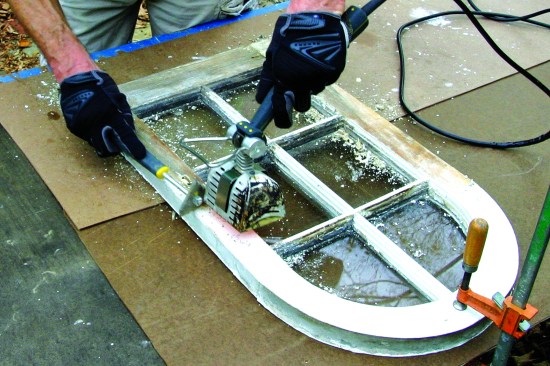

The new Cobra is smaller and lighter than the 1100 and features a compact, shrouded heating element that focuses the radiation on its intended target almost like a laser beam.
I tested this tool on flat surfaces, various molding profiles, and a few windows I was restoring at the time, all of which were heavily paint-encrusted. It was remarkably effective, but not until after I mastered the learning curve.
The manufacturer’s instructions clearly state that one to three seconds heating time is all that’s needed to prepare a typical painted surface for scraping. And they warn that “excessive heating can potentially mar the wood, release toxic fumes, and start a fire.”
What worked for me was to hold the Cobra in one hand (fingertips grasping near the neck, as if it were a pencil) and a sharp, pull-type scraper in the other. I’d hover the face of the heating element about an inch over the doomed paint until it began bubbling and smoking, then slide the heater to the next section of paint and scrape away the debris. With practice, I was able to keep the heater and scraper moving across the surface in a fluid motion.
When I reached the end of the line, I learned the hard way that it was crucial to have planned for a safe, fireproof, parking spot for the tool. One time I set it down too close to the 6-mil poly I was using for ground cover; another time I held it off to my side, heating element facing the ground, while I momentarily finished scraping a corner, and inadvertently melted the insulating jacket on the power cord.

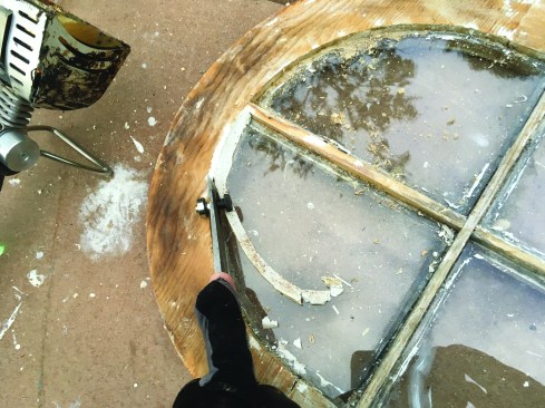

The Cobra directs concentrated infrared radiation over a small surface area, making it an excellent tool for window work.

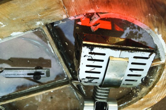

The compact heating element proves especially effective at softening glazing putty.
Once softened, the glazing putty can be easily peeled away from the window frame. Note: while not required on this job, aluminum foil can be used to shield
historic glass.
Once softened, the glazing putty can be easily peeled away from the window frame. Note: while not required on this job, aluminum foil can be used to shield historic glass.
On flat surfaces, the Cobra proved adequate but slower than the 1100 (because of its much smaller heating element). It worked well for stripping paint from intricate, profiled surfaces, such as moldings, spindles, and balusters (as long as the scraper blade was a good match for the profile), but it excelled at restoring window sashes. The heating element was perfectly sized for stripping the frames, and it softened rock-hard glazing putty better than anything I’ve ever tried—I found that after two careful passes of heat over the surface, the putty came off as easily as if it were DAP right out of the can.
