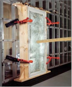

By now, impact-resistant windows using laminated glass are nothing new to coastal builders and remodelers. Many of the technical difficulties we reported (“Spec’ing Windows in High-Wind Zones” ) have been worked out, and manufacturers are offering a wider selection of sizes of windows in a much broader range of design pressures.
Impact resistance is tested by firing a 2×4 missile at the window and evaluating how well it then holds up to pressure cycling — a test that is intended to simulate the forces of wind-borne debris striking the window during a hurricane. An impact-resistant window typically shatters during an impact test but maintains its integrity if the interlayer and glass shards hold together. While keeping the home and its occupants out of danger, the window will leak significantly.
An impact-resistant window can shatter and still pass the large missile test if the window remains largely intact through the 9,000 pressure cycles. The glass fragments tend to adhere to the plastic interlayer, which is considered intact if the size of any rips that develop during the test total less than 1/16 inch wide by 5 inches long.

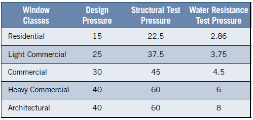

Impact resistance and design pressure are two distinct structural requirements for windows used in hurricane zones: One resists failure from wind-blown debris, and the other resists failure caused by sustained wind pressure.

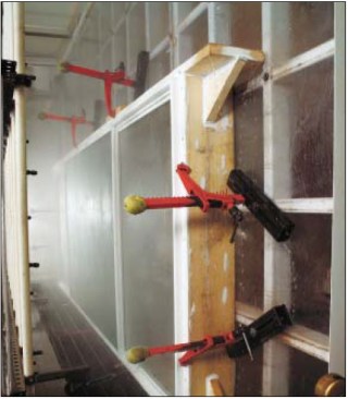

The Water Test: To meet AAMA minimum water penetration rating, a sample window is subjected to a negative pressure equal to 15% or 20% of the design pressure across the inside of the test assembly. The window exterior is then hosed down with a rack of water jets that is equivalent to a rainfall of 8 inches per hour. If any leakage occurs on the interior, the window does not pass.
Wind pressures are simulated in the laboratory by applying a static pressure across a window specimen for a prescribed amount of time and measuring the maximum uniform load deflection. During this test, pressure is applied in both directions, simulating sustained positive and negative wind loads. Design pressure will vary with area, so the window dimensions are critical to choosing the correct design pressure.
To comply with the International Residential Code, all windows in high-wind zones must meet the “Components and Cladding” requirements, found in prescriptive tables listing minimum design pressures for windows in different positions on the house exterior. For example, windows placed near corners, where the wind pressures are highest, must have a higher design pressure. (For a detailed discussion of these window performance requirements, see again “Speccing Windows in High-Wind Zones,” Winter 2005).
The design pressures used to meet the code’s “Components and Cladding” requirements should not be confused with the pressure ratings that are central to the joint specification from the American Architectural Manufacturers Association (AAMA) and the National Wood Window and Door Association (NWWDA). Known as AAMA/NWWDA 101/I.S.2 (or shorthand as AAMA 101), this standard defines the baseline performance characteristics required for every window, regardless of the market. The primary specification is a “structural test pressure” rating, which is established using a test procedure developed by ASTM that evaluates the window after applying a pressure 50% higher than the design pressure. If no permanent deformation occurs to the window, it passes the test and is awarded a small gold label affixed to an inside surface of the frame (Figure 6). However, the minimum design pressure rating listed in AAMA 101 may be lower than what is required for “Components and Cladding.” For example, the AAMA 101 baseline for residential-class windows starts at a minimum design pressure of 15 psf. While this pressure is equivalent to the pressure sustained by a 75-mph wind — the defining wind speed for a Category 1 hurricane — it would not pass muster in any coastal wind zone.

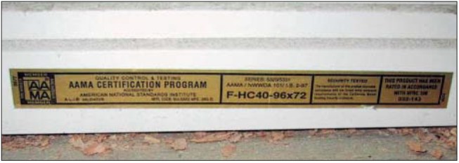

On this AAMA label, F-HC40-96x72 is the critical designation for this window. F is the product type (Fixed); HC is the performance class (Heavy Commercial); 40 is the performance grade (40 psf design pressure); and 96x72 is the maximum size tested (width x height).

On this AAMA label, F-HC40-96×72 is the critical designation for this window. F is the product type (Fixed); HC is the performance class (Heavy Commercial); 40 is the performance grade (40 psf design pressure); and 96×72 is the maximum size tested (width x height).
Currently, the AAMA 101 draws a distinction between several classes of windows, with residential (R) at the low end of the design pressure range, and heavy commercial (HC) and an unspecified “architectural” (AW) class at the upper end. Dean Lewis, manager of product certification for the AAMA, has suggested that these distinctions may become obsolete as more and more residential windows are being made to meet higher design pressures.
