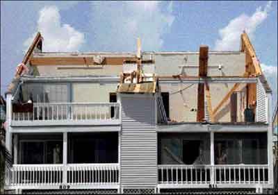

Wind-borne debris carried by hurricane-force winds can crash through window openings — the most vulnerable areas of a building envelope. Air rushing in the openings can then over-pressurize the envelope, just like blowing up a balloon until it bursts — a fate that befell this home on North Carolina’s Outer Banks during Hurricane Isabel in 2003.
As Florida recovers from four devastating hurricanes in one season, a clear lesson is emerging: The new codes worked. Better nailing, sturdier shear walls, more framing hardware, and beefed-up opening protection made a difference. Homes built to stringent new standards fared far better than older houses approved under pre-Hurricane Andrew codes.
Florida’s lesson won’t be lost on builders or code officials in the rest of the Atlantic and Gulf seaboards. But in states where the new International Residential Code (IRC) and International Building Code (IBC) are just coming into force, the beefed-up details these codes require in high-wind zones pose an unfamiliar problem for many contractors and inspectors. Window requirements in the new codes are a particular source of confusion. Here, we take a look at what the codes say about windows near the coast, and at what those requirements mean in practice.
