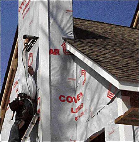

Unlike many composites, PVC won’t pucker at the surface when nailed. Some boards come with precut lock miters (inset), which don’t have to be glued.

Using PVC trim doesn’t require any new skills. You can cut it, drill it, and fasten it with standard carpenter’s tools (Figure 1). But because the material is more flexible than wood and expands and contracts more, you do have to vary your approach a bit. If you don’t have good installation information, you’re going to hate this product. However, if you learn to detail it right, it can save you expensive callbacks. The people I know who have learned how to use it, myself included, say they’ll never go back to wood.
Figure 1: PVC trim stock cuts and routs much like wood. The dust tends to have a static cling, but it’s not as fine or as abrasive as fiber-cement dust. PVC trim also won’t dull blades any faster than wood.
