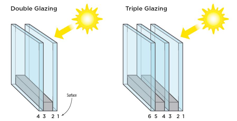

The placement of low-E coatings on multi-glazed windows may vary with the climate zone. Glass surfaces are identified by number, beginning with outermost or “weather” surface. It is always designated as #1, the inner surface of the outer pane is surface #2, and so on. In glazing with suspended films rather than internal glass, the film surfaces are numbered the same way.

JLC: Is there a useful distinction to be made between the low-E coatings used in the north, which are designed to prevent heat from radiating outward through the glazing, and those used in the south, which prevent solar radiation from overheating the interior?
Carmody : The original low-E coatings that came along in the 1980s were designed to keep heat indoors. The only way to reduce solar heating at that time was with tinted glass, but no one really liked the resulting gray or green or blue windows. In the second wave, we figured out how to use low-E coatings to block radiant heat gain without losing too much visible light. In the ’90s, people used to talk about what they called “northern low-E” and “southern low-E” glazing.
But it’s not that simple anymore. In a place like Minnesota, where there are big heating loads, a northern-type window seems like an obvious choice. But it gets hot here in the summer, so if you also have air conditioning, as a lot of people do, switching to low-solar-gain glazing works to your advantage for part of the year. Depending on the situation, you might end up saving more in air conditioning costs than you give up in wintertime heat loss. If you don’t have air conditioning, low-gain windows might make you more comfortable in the summer even if they don’t save any money.
DePaola: The original hard-coat low-E windows were coated on the inside surface of the glazing. Sputtered coatings came later and made it possible to put on enough metal to reject heat from outdoors. But sputtered coatings are softer, so the first low-gain windows had the coating on the outer surface of the inner layer of glass, where it would be protected by the outer glass [see illustration, next page]. In really hot areas, that caused some seal failures because the reflected heat built up between the inner and outer glass, like in a greenhouse. Now most low-gain windows are coated on surface 2 — the inside of the outer glass — so the heat is absorbed by the outer layer and reradiated. Glazing that’s optimized for heating climates usually has the coating on surface 3.
