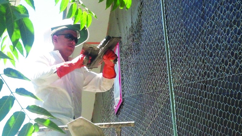

The scratch coat is the first coat of plaster applied in any plaster system. It’s the structural component to a stucco wall, and it provides the most strength to the plaster lamina in a three-coat system. The plasterer scarifies or scores (“scratches”) this coat to create grooves into which the “brown coat” will adhere. Once applied, the scratch coat is moist-cured morning and evening for 48 hours.
The brown coat, the second coat of plaster, brings the plaster out to the thickness of the trim at the base of the wall and the edges of the doors and windows. The worker spreads plaster on the wall, and uses a darby to smooth the material as flat as he can while it is still plastic. When the brown coat sets, the wall is “rodded”: The plasterer takes a long straightedge, or “rod,” and works it over the wall to knock down high spots, fill in low spots, and ensure flatness. He then “floats” a rubber float across the surface to compress the material and to knock off any minor high spots and fill in minor flaws. This coat is then moist-cured morning and evening for 48 hours in preparation for the finish coat.

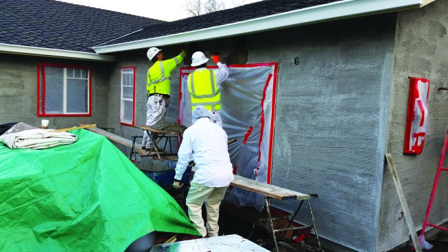

The third step in a three-coat stucco system is the finish coat. If stucco finishing is done using a trowel, the walls need to be cool and moist with no standing water. Another common option is a “dash coat,” which is produced with a machine that sprays a fine, tight texture on a wall using a soft slurry of stucco material. The texture is sand-finished, without float marks, and needs a well-prepared base coat. If the finish is a dash coat, the area around the walls needs to be covered to protect it from overspray.
If the plasterer is using a crack-reduction lamina, he spreads acrylic adhesive in a tight skim coat and trowels in fiberglass netting. He then applies additional trowels of material to embed the mesh completely.

After the scratch coat has been moist-cured for at least 48 hours, the brown coat is applied with firm pressure to create a strong mechanical and chemical bond between the coats. The brown coat should be rodded flat with a darby and straightedge, then moist-cured and checked for hardness.

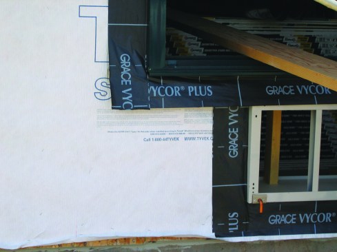

A good drainage plane is essential for allowing the plaster to manage moisture during wet weather. The weather resistive barrier (WRB) is the paper behind the lath that moisture hits before it migrates down the wall, keeping the interior safe and dry. We insist on a continuous weatherboard-fashion (shingle-fashion) installation of any WRB to ensure that the plaster weeps incidental moisture down the wall and out at the weep screed.
Flashing should be applied so as to direct water out and down on the drainage plane. Weep screeds at the bottom of the wall allow any water that soaks into the plaster to escape.

Flashing of penetrations should incorporate one guiding principle: All the flashing should be installed weatherboard style (shingle style) so that moisture will slide down the wall away from the windows, doors, electrical boxes, vents, and pipes.
One of the mistakes we see all the time is not detailing a horizontal condition to drain to the outside. Heads of windows and doors need Z flashing extending past the vertical jambs to kick moisture in the wall out onto the surface of the plaster. Horizontal reveal screeds need to be attached gingerly to keep from compressing the spine of the trim into the WRB and creating a dam.

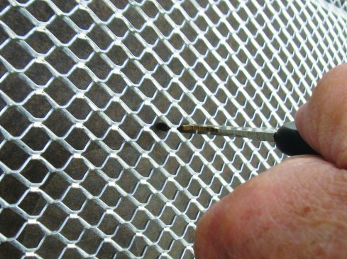

Wire or mesh lath should stand proud of the drainage plane by 1/4 inch. This allows space for the scratch coat of plaster to fully embed the lath. The scratch coat should cover the lath by another 1/8 inch.

The furr, which is the amount of space beneath the field of the lath, should be at least 1/4 inch. The object is to make sure that enough plaster can get behind the wire to create a good foundation for the brown coat. There is an easy test for correct furr: Take a pencil with an eraser, push it against the wall, and look at where the lath meets the eraser collar. If they match, the lath has been installed with enough furr to allow for full embedment.

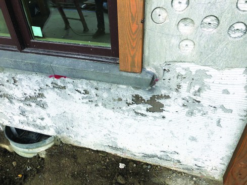

The wrong ratio of sand (aggregate) to cement can mess up a good job without the general contractor even being aware of it. I was called out to a school built during the summer, and the maintenance guy who asked me to check the ceilings and walls wondered why the stucco was falling off a brand-new elementary school. The sand-to-cement ratio was 7 sand to 1 cement. In checking the plaster keys in the ceiling, I brushed my palm against some plaster that turned to powder, and a chunk of the ceiling fell down. It was a beautiful job, but there wasn’t enough cement to bind the sand together or enough moisture to harden the cement if there had been enough of it. All the plaster had to be removed.
ASTM Standard C-926, “Standard Specification for Application of Portland Cement-Based Plaster,” specifies that for the scratch coat, one part Portland cement should be mixed with 2 1/2 to 4 parts aggregate by volume, and for the brown coat, one part Portland cement should be mixed with 3 to 5 parts aggregate by volume. The principle is to have just enough cement to coat each granule of aggregate to bind it into a solid mass. Too much cement and the plaster mix is too rich and is prone to shrinkage cracking. Too little cement and the mix is too lean—there isn’t enough cement to coat each grain of aggregate and the material will lack strength.
Counting the number of shovels of sand in a batch of plaster is one way to ensure that you get a good sand-to-cement ratio. Thirty-two #2 shovels per 90-pound bag of cement is a good gauge while watching a hod carrier mix mud.
An inferior scratch coat does not fully cover the wire lath and has not been properly cured, allowing the coat to scale away from the wall.

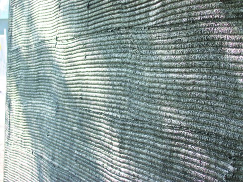

Here is a superior scratch coat that fully covers the lath and has been scored (scarified) to create grooves that will provide a mechanical bond with the brown coat.

The thicker the scratch coat, the better the overall strength characteristics of the finished plaster panel. According to ASTM C-926, this means that enough material should be applied on the lath “to embed the metal base, and with sufficient thickness of material over the metal to allow for scoring the surface.” The furr should be at least 1/4 inch. The amount of material needed to fill that void and cover the metal base is approximately 3/8 inch of plaster. Using sufficient pressure ensures that enough material is pushed under and over the metal base, which we define as “embedment.” Covering the wire and being sure to apply a good scratch-coat thickness is critical for a successful stucco job. Scarifying (scoring) or grooving the surface of an unset plaster coat to provide a key for the subsequent coat then ensures that the mechanical bond, as well as the chemical bond, between the scratch coat and brown coat is strong.

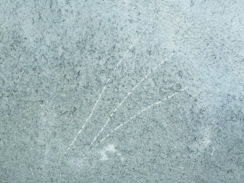

The Mohs Hardness Test confirms the cure. Any GC can do the test at any time during a workday: Take a penny and scratch the surface of the plaster. If the wall scratches the penny, the wall is cured; if the penny scratches the wall, it needs more curing. Mohs compares the hardness of substances, talc being a 1, and a diamond being a 10. Plaster panels should be in the 4 to 5 range, whereas a penny is a 3. So if the wall scratches the penny, you have prima facie proof of the cure.

A brown coat has been scratched by a penny, indicating that the cure is incomplete. Curing should continue until a penny will not scratch the cured cement plaster.
