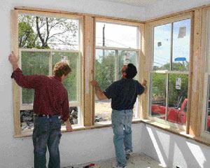

At the job site, I measured each window, noting the interior distance between the head and sill and between the side jambs, and assigned each a number that denoted size and type; this job had five casement sizes, numbered 1 through 5, and five double-hung sizes, numbered 6 through 10. Then I labeled each window with a piece of masking tape stuck to the glass.
I recorded each window’s number, type, jamb interior width and height dimensions, quantity, and any special considerations such as proximity to a corner or another window or door unit. And — as always — I took digital photos of details, including all combination configurations; these would give me a reliable visual reference back at the shop.

On this job, my layout stick was a length of 1-by about 2 inches wide and slightly longer than my longest trim dimension. I clamped it to an auxiliary bed on my chop saw with a stop block under the clamp.
When I use a layout stick, I don’t set the end flush with the saw blade. That’s because there are several offsets to take into consideration: the reveal between the window jamb and the extension jamb; the reveal between the extension jambs and the casing; the overhang of the parting bead beyond the side casings; the stool horns that extend beyond the apron; and the thickness of the side extension jambs, which rest on top of the sill piece.
To keep track of these differences, I make a pair of “offset sticks,” one for the casements and one for the double-hung windows. These hold the marks for the various offsets.
I cut a small reference kerf on the correct side of each offset line to avoid error, aligning it with a kerf cut into the auxiliary bed of the miter saw.
I hold the offset stick against the bed, with the saw kerf properly aligned, then slide the layout stick till it bumps the offset stick. I clamp the layout stick to the fence, then place the stop block on the correct line for whatever component I’m cutting.
