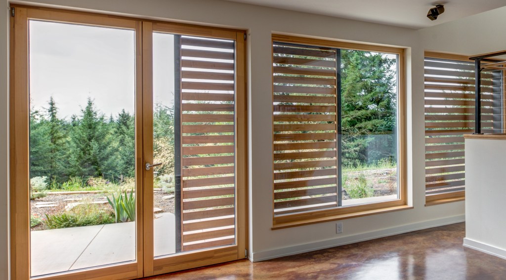

In this video series, Zola Windows’ Florian Speier provides an overview of unpacking, installing, and adjusting high performance windows on location at Hammer & Hand's Pumpkin Ridge Passive House.The series highlights not only how to connect the window to the structure but also touches on proper flashing of the rough opening, air sealing, and over-insulating the frames.
Coupled with Sam Hagerman’s recent article, "A Simple Approach is Best for Preventing Leaks at Rough Openings" and the New Window Installation section of Hammer & Hand's Best Practices Manual, the series presents a nice primer on high performance window installation.  Watch the videos.
