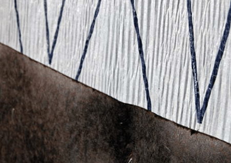

Cap nails are as easy to install as narrow crown staples but provide much more holding power. This holding power is not trivial. It’s needed to keep the weather barrier intact before the cladding gets installed, particularly where persistent ocean breezes provide a constant risk of ripping housewrap to shreds.

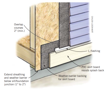

Code Minimum. All overlaps in a building wrap must overlap 6 inches where two pieces join vertically, and 2 inches at horizontal seams. The first course should begin around a corner a minimum 12 inches (or to the first stud) and overlap the sill plate 1 to 2 inches.
To accomplish this, courses must be overlapped the same way you install roofing materials — the lower course goes under the upper course. And the material must be permeable; that is, it must allow water to evaporate through it and not accumulate.

You can expect to use some sort of cap fastener — a plastic cap held in place by a staple or nail. It’s true that 1-inch-crown staples are also allowed in most cases, but this is more of a concession to what has always been done rather than best practice.

Staples just don’t have enough surface area to pin down the wrap when the home is subjected to a stiff breeze. Think about the contact area of a 1-inch-crown staple compared with a 1-inch-diameter cap: the cap is going to hold in a much higher wind. Also, the profile of the cap is less likely to allow water to enter the building than is the staple. (An obvious exception here is a stucco and cultured stone exterior, which typically needs the metal lath to be stapled in place.) Small hammer tackers are out entirely. Just how much holding power do you think these tiny staples really have? It’s certainly not enough to hold a sheet from getting ripped off by the wind.

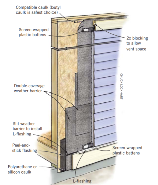

Two layers. A two-layer weather barrier provides redundancy. If water gets through one layer, or one layer is compromised by exposure to the elements, the second provides protection.
Code Plus Coastal climates prone to high wind pressures and driving rain demand more than current codes require. The detail shown here, which results in a double-coverage weather barrier, provides a level of redundancy that will reduce the chances of rain getting drawn into the wall by wind pressures and capillary action. A positive separation between the cladding and the drain plane created by battens affords further protection.
There’s another reason for considering this level of redundancy: surfactants that leach through the cladding can compromise any weather barrier. Surfactants are compounds that reduce the surface tension of water and allow it to slip right through most housewraps. Soap is a surfactant, which is why it works to break down grease and dirt when we wash our hands, and why you don’t want a trade contractor adding soap to a stucco mix to improve the workability of the mix. Other examples of surfactants include the water-soluble extractives that leach out of wet cedar and redwood, or additives sometimes found in synthetic stucco and cultured stone base layers. The soap used when pressure washing an exterior can also break down the weather barrier’s ability to hold out water.

Rain screens. We have been using rain-screen technology for many years in brick-veneer walls. The code-minimum 1-inch gap allows any water soaking through the brick (and there is plenty of that) to drain away before it contacts the structure.
The ideal rain screen creates a disconnect — a gap — between the exterior cladding and the weather barrier. Bulk water must be allowed to drain down and out of the wall cavity, so the system needs a clear way to exit. In addition, ventilation from top to bottom will promote drying and protect the weather barrier from damage.
