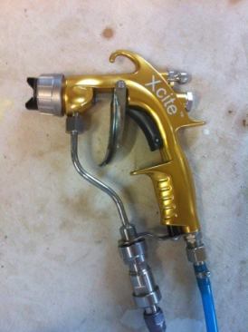

There is a huge difference. I have written in the past about this topic, most recently a full analysis of air assisted spraying technology in American Painting Contractor magazine. At the practical level, I think some contractors resist aaa because of the cost of the equipment. You can get a good airless for under $1000. A good aaa rig may cost over $2000. Some contractors claim that aaa is slower than airless, not realizing that if you turn off the compressor on an aaa and turn up the fluid pressure, you are essentially running a 4ooo psi airless machine. The air assist simply gives you the ability run products efficiently in lower pressure ranges, which is desirable for fine finishes. And having a 5 gallon supply capacity gives aaa a production advantage over hvlp on larger scale tasks, but with similar transfer efficiency and finish quality.

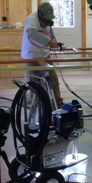

We use these aaa systems:
We rarely use airless sprayers anymore, mostly just for production spraying of drywall primer, which are abrasive miles that we prefer not to put on the pistons of our aaa rigs. We use air assisted for cabinet spraying, production prefinishing of interior and exterior trim packages in our shop, and onsite architectural trim detail finishing. The control, precision and efficiency of an air assisted airless system cannot be matched by an airless with a fine finish tip.
