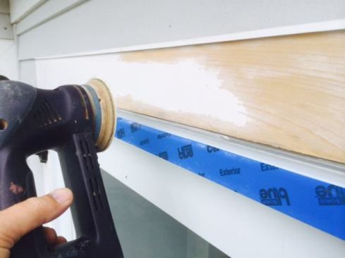

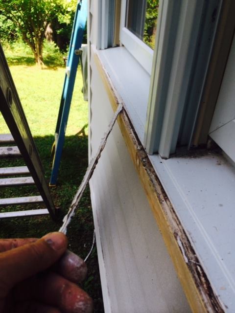

The most common problem I see in the entire range of paint jobs that failed is the user tendency to apply way too much material on the edges of wood surfaces. It is not a conscious decision, it just sort of comes with the lack of control of the application tool and the finish.
It is the "eye" for finishing that I talk so much about. We call them "fat lips" or "fat edges". They are common on large and narrow surfaces. They happen both vertically and horizontally.
