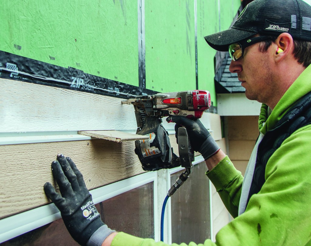

Our installation costs have gone down because this product installs more quickly and is easier to handle than fiber cement. But like all products, the devil’s in the details. LP has done a good job of making its installation instructions “readable” using illustrations. It also has useful installation videos on its YouTube channel.

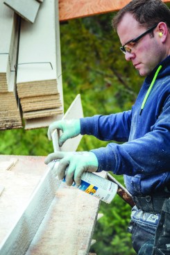

All cuts, rips, and end cuts need to be sealed. If the siding boards are acclimated, the author hits the edges with spray-on primer, such as Zinsser Bulls Eye 1-2-3 Plus.
If the wood needs to acclimate, or if the weather is wet, the author will install the siding first and caulk the gaps later.

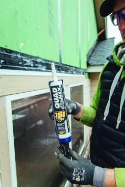

All cut ends or rips need to be painted with 100% acrylic latex paint or sealed with caulk. If the siding is acclimated, we seal as we go, typically hitting ripped edges with a spray primer. Instructions call for an “ASTM-C920 minimum Class 25” sealant; we use OSI’s Quad Max. While it does take time to seal cuts, it isn’t a problem once you’re set up for it.
LP’s instructions call for an ASTM-C90 minimum Class 25 sealant; the author uses OSI’s Quad Max.

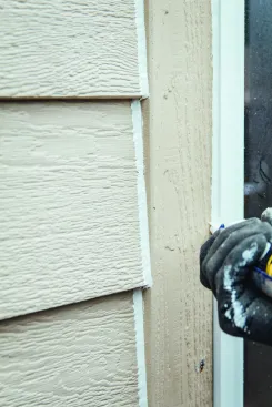

A 3/16-inch gap must be maintained at all butt joints. Where we have found this to be critical is where lengths of lap siding butt together. This material ships with a very low moisture content and will move on the wall. I like to order the siding to be delivered when we start framing a job. That way it can acclimate for the three to six weeks we are framing. The siding moves much less on the wall when we order it early.
For butt joints, Diamond Kote H-Moldings can be inserted into the butt joint in lieu of sealant. Some people don’t like the look of these, but a caulked joint isn’t exactly a thing of beauty either. An 8-foot stick costs us $10.50 and we can get 13 pieces from it, so each piece costs about 80 cents before tax and shipping.

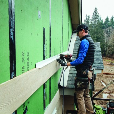

Ribbon boards serve as a visual element that helps define gable ends. Here, the author packs out a trim board with OSB ripped narrower than SmartSide Trim boards so the bottom edge of the ribbon overlaps and protects the siding board below it.

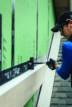

The top of the ribbon needs a Z-flashing, which must be integrated with the Zip System WRB, using Zip Tape.
Like all adhesive flashings, this needs to be rolled to ensure a tight, lasting bond.

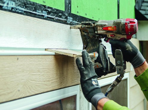

Over Z-flashings on window heads and ribbon boards, LP requires a 3/8-inch gap. We use a scrap piece of siding to keep the gap consistent. With SmartSide Trim, a 3/16-inch gap is required between the trim and window, as well, but boards can be butted tight to another piece of trim.

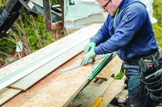

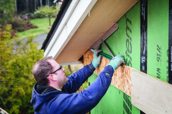

The author depends on two jigs made PacTool. The Gable Slide easily adjusts to the rake angle of the gable end.
Here he’s using it to find the angle for the last piece of the ribbon board, but that same angle will be used for all the siding that fills in the gable end, as well.

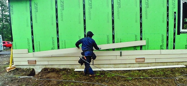

The Gecko Gauge, to the right of the author in the photo, holds a long run, making it easy for one person to install long lengths of siding.
With a PacTool Gecko Gauge, this siding is easy for one person to install. It doesn’t curl back at the installer as he puts it on the wall.

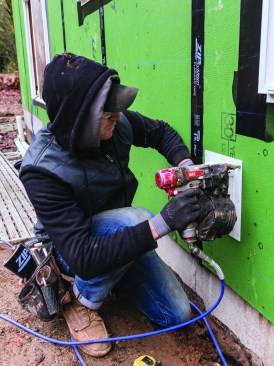

For outlets and hose bibs, we have used Diamond Kote’s premade blocks. These are nice and install quickly, but they are expensive (about $50 each for the larger size), so the budget doesn’t always allow for them. Then we have to fashion up mounting blocks from scraps of SmartSide Trim boards, which we can do inexpensively.
Without a housewrap to hide the nailing on studs, Huber’s Zip system makes it easy to nail siding into studs. Over window and door heads, the author uses a scrap piece of siding to keep an even 3/8-inch gap between the siding and Z-flashing.

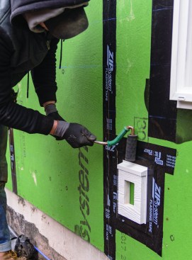

Diamond Kote mounting blocks make quick work of providing a weathertight penetration for exterior outlets.
These have a built-in flange that is nailed into place and then integrated with the Zip System WRB.  The only disadvantage of these premade blocks is that they are expensive.
