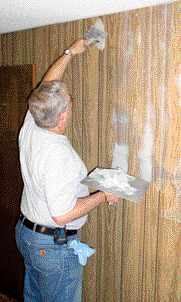

Durabond is much harder than regular drying-type joint compounds, so it resists cracks and checks caused by seasonal changes in humidity, which makes it a very sound filler for finishing paneling. It also sets up much faster, so we can complete projects in a more reasonable time frame (usually one to two days from start to finish) than if we installed new drywall.

Mixing. The challenge here is to gradually mix water with the powder and stir until you have a good putty-type mixture without lumps. You don’t want the Durabond to be too soupy (it’s pretty easy to add too much water), because that can slow down the drying time and cause shrinkage.
Since there’s only so much Durabond 45 that you can apply before it starts to set up, I don’t usually use a mechanical mixer. This 10-foot-by-16-foot room took a few hand-mixed batches.
After mixing, I allow the Durabond to slake for about a minute before applying it to the walls.
Application. I use standard joint-compound tools to apply the Durabond. If the overall texture of the paneling is very smooth, only a narrow mud knife is usually needed to bridge the grooves, which greatly reduces the amount of compound you have to sand.
But because the walls in this project were in poor condition, I had to use wider knives, resulting in a corresponding increase in sanding time.
It’s possible that some paneling will require only a single coat of compound, so it pays to check for smooth, full buildup to see if a second coat is really necessary.
