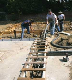

With the help of a backhoe operator, we removed the cut-out sections of concrete and trenched for the new footings. As is typical for California, all the footings — as well as the slab — required engineering, and the plans included a rebar schedule and specs for seismic hold-downs.
Since the site was known to have expansive soil, all the new footings had to be 2 feet deep. Many of the existing footings bottomed out at 18 inches, so in a couple of places we had to hand-excavate underneath them to reach the required depth. We used #5 rebar and 3,000-psi concrete for the new grade beams. The column pads were typically 12 inches thick — ranging in size from 1 square foot to 16 square feet, depending on the load — and reinforced with #4 rebar.

Doweling the Slab Edges
To create a stable cold joint, we doweled the new slab into the old one. We first drilled 1/2-inch-diameter holes 8 inches deep every 16 inches along the existing slab edge. After blowing the holes clean, we injected SET 22 High-Strength Epoxy-Tie adhesive (800/999-5099, simpsonanchors.com) and inserted #4 rebar. Once the epoxy had set, we wire-tied these dowels into the #4 rebar grid in the new slab areas.
