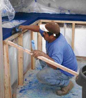

Forming the Counter
Concrete is poured on the plywood top. The plywood edge is hidden behind a face frame or by thickening the nosing. If the counter has any kind of overhang, we build a temporary shelf to support the nosing when it's poured and while it cures. The shelf can be anything; we normally put a 2x4 on the flat and prop it up with legs. To avoid damaging the cabinets, we wedge or clamp it in place.
As with any counter material, it's easier to create the opening for a drop-in sink than for an undermount sink. The author uses a piece of rigid foam insulation board, patterned from the sink template, to form the undermount knockout.
We typically need to remove doors or drawer fronts to install the shelf. Before starting, we use blue tape and plastic to mask the cabinets and nearby walls. If there's a finished floor, we'll protect it, too. We cover the plywood top and adjoining walls and cabinets with Kraft building paper. This prevents them from absorbing excess moisture or wicking color from the wet concrete.
Edges that don't butt to existing surfaces are formed by fastening strips of wood to the temporary shelf. Curved edges can be formed with 1/4-inch hardboard. Integral splashes are formed by suspending a board just off the back wall and parallel to it. The board is supported by temporary legs, which can be removed once there's some concrete under the bottom edge.
The front edge is formed by a strip of wood as tall as the counter is thick. It's separate from the support shelf, so it can be removed when it's time to finish the edge.
