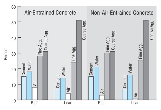

Percentages of cement, water, air, sand, and gravel in concrete mixes. Rich mixes contain higher percentages of cement. Air-entrainment introduces tiny air bubbles that allow the concrete to flow easier with less water, which makes for a stronger mix. The trapped bubbles also absorb minor expansion and contraction, allowing the concrete to better resist freeze/thaw damage.

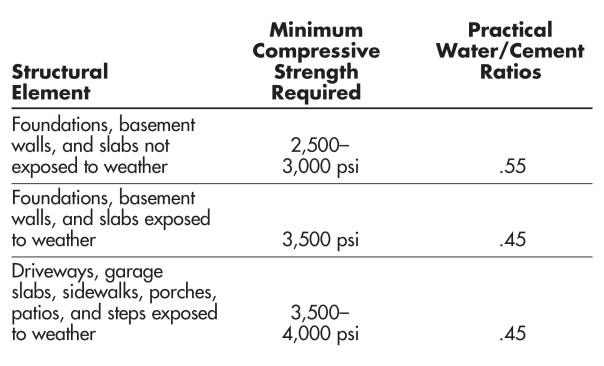

At a minimum, concrete specifications will usually call out the compressive strength and water/cement ratio (Figure B), as well as the slump (Figure E). Concrete mixes can vary in the type and quantity of cement, the ratio of water to cement, the percentage of entrained air, and the size and grading of aggregates. You may also want to order concrete with various admixtures for special circumstances (see Admixtures, below).

Water/Cement Ratio
The ratio of water to cement should be strictly controlled to ensure that the concrete reaches the specified strength (Figure D).
On site, add the minimum amount of water needed to make the concrete workable. More water makes the concrete easier to handle, but also makes it much weaker and more prone to shrinkage and cracking (Figure D).
The more water added to a concrete mix on site, the weaker it will become, and the more it will shrink and crack. Adding 2 gallons per yard will cut compressive strength by around 10% and will increase shrinkage by close to 20%.

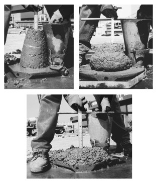

A slump test uses a standard cone — 12 in. high, 8 in. wide at the base, and 4 in. wide at the top. To perform the test, fill the cone in one-third lifts and “rod it” (churning by moving a piece of rebar up and down) 25 times between each lift. Remove the cone and measure the distance from the height of the cone to the height of the slumped concrete. Residential concrete should slump no more than 4 in.

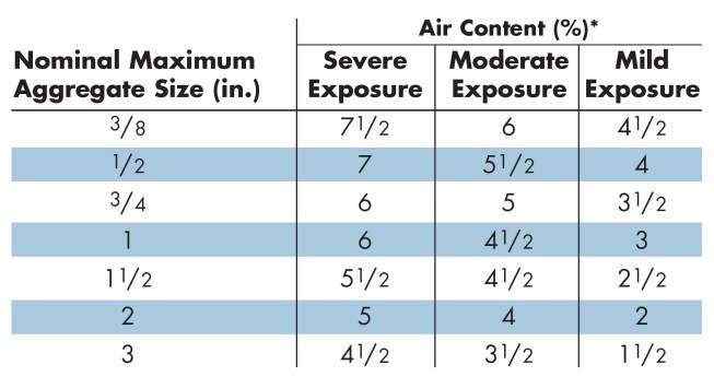

Air Entrainment
Air entraining creates billions of microscopic air voids in hardened concrete, which serve to absorb the pressures caused by expanding ice or de-icing salts. Most ready-mix suppliers today add an air-entraining admixture to a standard cement mix.
Air entrainment is crucial for exposed concrete in cold climates, but it is recommended for almost all concrete, even in mild climates, because it reduces water demand, improves workability, reduces segregation of aggregate, and reduces bleeding of excess water. Recommended entrained-air percentages for different weather exposures are shown in Figure F. Refer to the map in Figure G for exposure regions throughout the continental United States.
*Air content is specified as a percentage by volume of concrete. For severe exposure conditions, air content of the mortar alone (cement paste and sand) should be about 9%. Lower air content percentages for concrete with large aggregate reflect the fact that less mortar is needed for mixes that contain large gravel.These levels of air-entrainment shown for different climate exposures are minimums. Higher air amounts are permissible as long as the design strength is maintained. Refer to Figure G for exposure locations.
“Severe” and “Moderate” exposures are determined based on the likelihood that de-icing salts will be used at a given location. Check local climate data because icing conditions may vary locally with altitude.

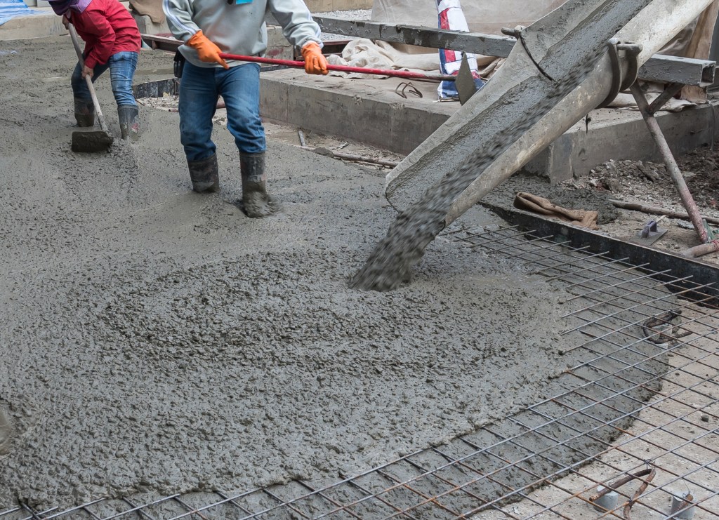

Placing Concrete
Concrete placement always happens under time pressure. Allow a half-hour to an hour per truckload of concrete — concrete is unusable after 90 minutes on the truck under normal conditions, and may go bad even faster in hot weather.
Pumping Concrete
Pumping calls for a special mix, and usually requires a specialty pumping subcontractor. Coordination is important, so a pre-construction meeting of all the contractors involved is recommended.
Pouring Concrete
Place walls in lifts of 1- to 2-ft., working around the perimeter of the building. This lets lower lifts stiffen before the pour gets deep, reducing pressure on the forms.
Place slabs in bands 4- to 6-ft.-wide, and strike off as you go so you won’t have to disturb concrete that has already begun to set.
Place concrete close to its final position. Don’t puddle it in one place and drag it along — the farther the concrete is pulled, the more the gravel separates from the paste (segregates), causing honeycombing and weakening the structure.
Do not drop the concrete more than 4 ft. Use a drop-chute with a 6-in.-diameter rubber or canvas hose to prevent segregation of aggregate.
Compact concrete as you place it by rodding, spading, or vibrating. This removes large air bubbles and prevents voids.

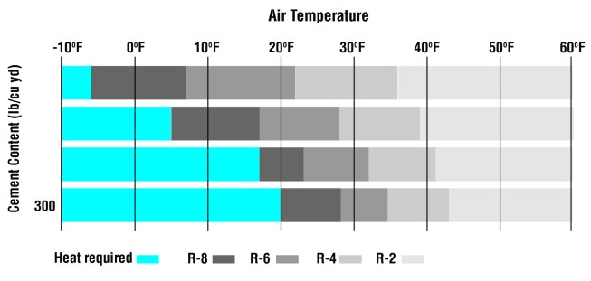

In cold weather, set times are delayed (Figure K) so schedule the pour early in the day. In cold temperatures (below 40°F), don’t be surprised if finishing has to be done at night, long after regular quitting time. Bleed water may not evaporate; be ready to squeegee it off the slab. Slabs cool rapidly, so be ready to protect the slab with insulating blankets and straw as soon as finish troweling is complete.
Set time (the time it takes for concrete to harden enough so that finishing can begin) increases by a third for every 10°F drop in concrete temperature.
Cold-Weather Curing
Ponding and sprinkling are impractical in freezing weather. Use curing compounds or plastic sheeting to hold moisture in fresh concrete. Provide enough insulation to keep concrete temperature above 50°F for at least three days (seven days is preferable). See Figure L for the insulation level needed to maintain adequate warmth and Figure M for insulation materials to meet R-value requirements.
After curing, exposed slabs need to dry thoroughly before they can withstand winter freezing. For that reason, pouring slabs in late fall is risky in colder regions.
A temperature drop greater than 50°F over 24 hours risks thermal shrinkage cracking. Insulation thrown over poured concrete, however, will trap the heat of hydration and allow the concrete to cool slowly. As outside air temperature drops, it may become harder to keep concrete at the correct temperature using insulation alone. Below a certain point for any given mix, provide a heated enclosure to prevent damage to the concrete from freezing.

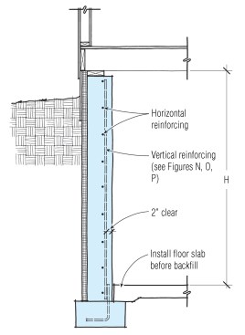

Sizing and Spacing in Walls
Figure N shows proper reinforcement size and spacing for standard 8-in.-thick concrete and masonry walls at
various heights. “Standard” construction implies work on well-drained sites with stable soils and the use of granular backfills and perimeter drains.

Placing Foundation Rebar
Rebar should always be placed near the tension side of the concrete.
In a full-height foundation wall, which is held in place by floor framing at the top and by the footing at the bottom, the tension side is toward the inside (Figure Q, below, and Figure: Reinforcing Block Walls in Reinforcing Block Walls).
In a free-standing retaining wall or a half-height foundation wall, the tension would be on the side nearest the ground load (see Stepped Foundation Walls).
Horizontal rebar is most effective along the top and bottom of the foundation elevation.
Place rebar towards the tension side of a concrete foundation wall that is pinned in place by floor framing and a basement slab. If the concrete wall is thicker than 10 in., a second layer of reinforcing, placed near the outside face, is recommended.
