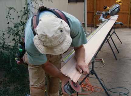

Because grinders generate a lot of dust, I try to set up outside — but I’ve also worked successfully in well-ventilated indoor areas. Some people prefer to wear a respirator when using these tools.
To begin, bevel the end of the stock with a miter saw, then highlight the cut line by rubbing the edge of a pencil along it. If the trim has a long, straight profile — as some baseboard does — set the miter saw to a slight back bevel and cut off the straight part. Remove as much material as you can without going beyond the cut line.

To cope the curved part, hold the piece face-up on a bench and cut toward the cope line with a grinder. Always start with the disk — or burr — in contact with the back of the trim and then rock it forward toward the face. This makes for better control because there’s more resistance when you’re cutting through the entire thickness of the trim as you approach the face.
With the coarse disk in place (if you’re using one), rapidly remove wood until you are close to — but not touching — the pencil line. If there are any tight curves — radii of less than 3/4 inch — notch them out with the edge of the disk. Start at the deepest part of the curve and work slowly toward the edges.
Up to this point, you can be pretty fast and loose with the grinder without getting into trouble. Now, though, you want to come right up to the line — so you need to be much more careful and controlled. Switch to the finer grit disk and, starting from the back, gently roll the spinning disk up toward the face, tilting the grinder as necessary to follow the contour of the cut line.
With complex profiles, be sure to pay attention to the entire disk. It should contact the trim at a single point; if you aren’t careful, it may hit somewhere else and accidentally remove material you didn’t want to lose.
