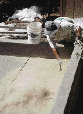

After scoring a damp exterior slab to suggest stone pavers, workers sprinkle on color hardener to change the tint (see photo at top of article). Latex molds taken from actual stone are pounded into place to provide the texture.

Using Color Hardener
Another way to color concrete is to add pigment after it’s placed. This is done by heavily dusting the surface with a dry-shake color hardener after the crete is floated and the bleed water has disappeared. The moisture in the slab activates the hardener, which is incorporated into the surface by floating, troweling, or stamping with textured mats. The color typically goes about 1/8 inch into the slab.
The main ingredients in color hardener are pigment and Portland cement. The pigment provides color, and the Portland enriches the surface and makes it harder than the concrete below. You could pour material that’s 3,000 psi and end up with a surface that’s 6,000 psi. The extra hard surface helps the slab wear better and makes it more resistant to freeze-thaw cycles.
Skilled labor needed. Using color hardener takes more skill and labor than using integrally colored concrete. Color hardener is applied in stages. The first two thirds are broadcast on the slab and worked in by trowel or float. The final third is worked into areas that didn’t get enough color the first time. The slab is then ready for finishing.
Color hardener comes in a wide array of colors. There’s more design flexibility than with integral color because the finisher controls the process. He or she decides how much color to apply and is able to create highlights by using more than one color.
It takes between 60 and 120 pounds of color hardener to color 100 square feet of concrete. Lighter colors typically require more. Most color hardener costs between 35¢ and $1.00 per square foot. But blues and greens are more, costing between $1.20 and $6.50 per square foot. As with integral color, you should avoid using chloride-based accelerators with this product.
